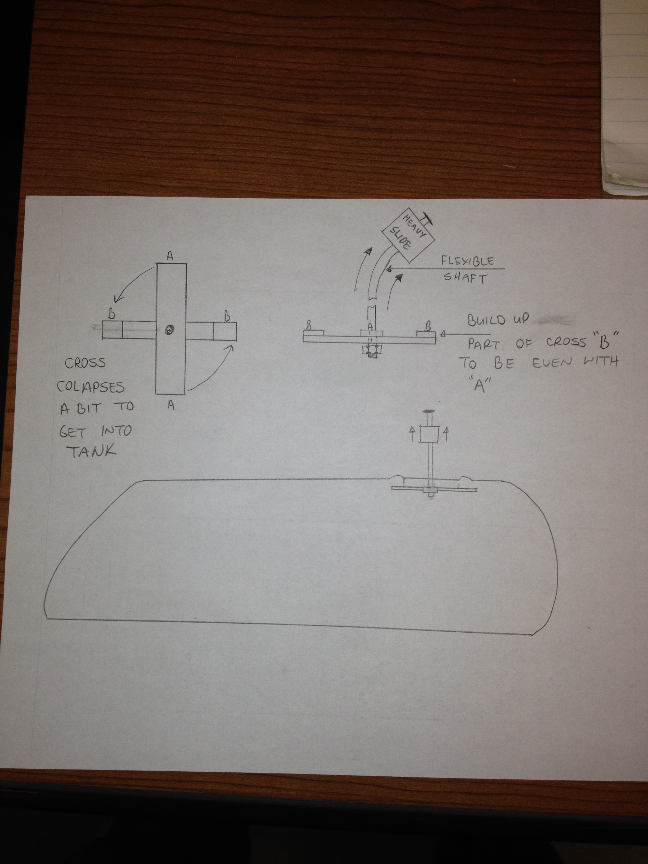

    That sucks about your gas cap. I too have a slight "in-nee" gas cap on my 73. The picture Matt supplied was an ugly OEM replacement that worked for me since all old style caps leaked. We really thought that would do it with the thicker gasket for your issue. I've attached a picture with a crude tool design that may allow you to "pop" up your filler neck slightly. Basically it's a collapsible cross that spreads open once inside then has a slide attached to a flexible shaft. I know it's a pretty small opening, but if you use strong enough materials it may work. Grasping for straws here

    That is a good idea, thanks. I had used a bearing puller, but it only grabs the edges and it moved it just a little. Your idea would grab the whole top part of the opening.
    What material did you use for this idea?

    I haven't actually built one Tomcall and I know it's size will be a challenge, I drew this up as a suggestion for your situation. My leak has stopped with the new style of cap.
