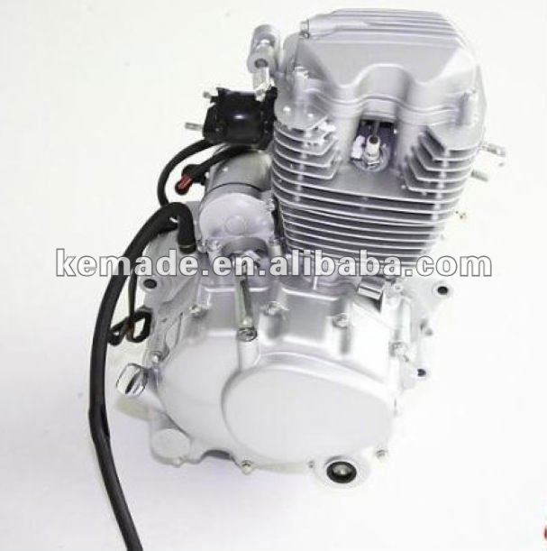

    Jan 2014
    Edmonton
    50
    It may be this engine. Found this info on line http://www.crossfiremotorcycles.com/...engine-4t.html They sell the engines for $660 and they claim is a direct replacement for 200cc pushrod style engines for Chinese dirt bikes.
