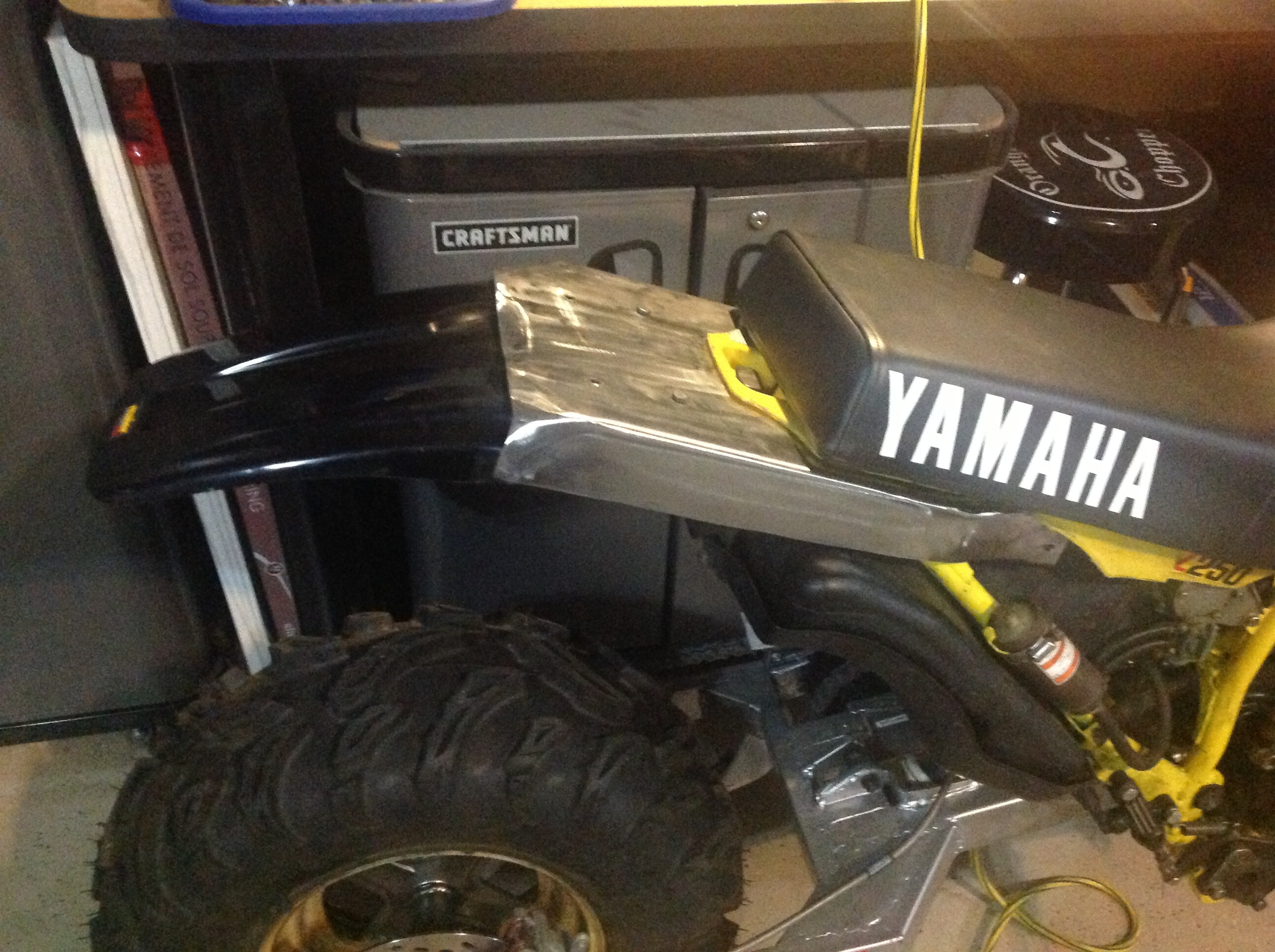

    Here's a couple picture of my Tri z missile build ( I call it a dual Z)
    Anybody else done this to a Tri Z?

    All I can say is get down with your bad self! That is pretty sweet, did you fab that swinger by yourself?
    Jan 2014
    Edmonton
    50

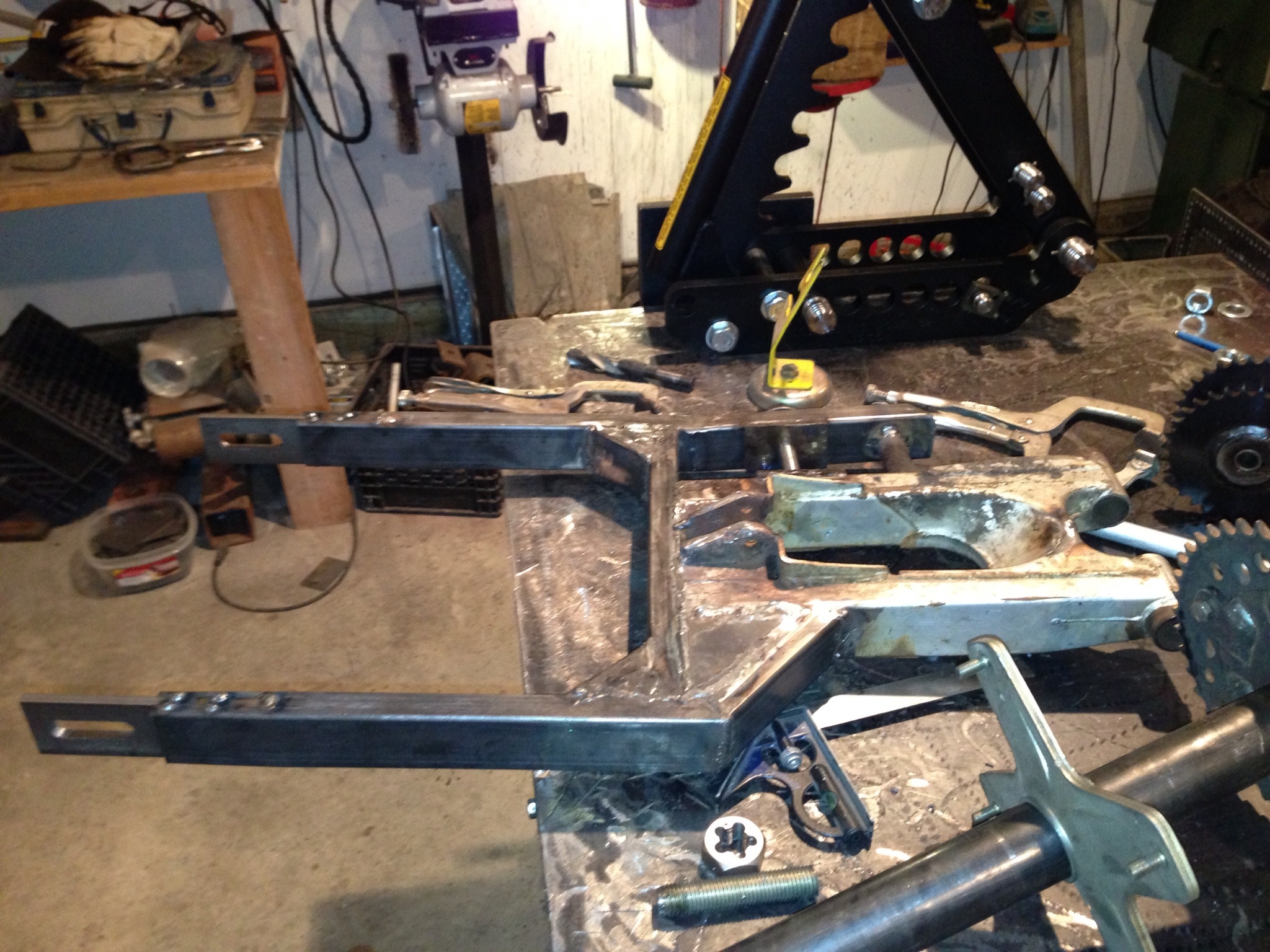

    The front half of the swinger is factory but I built the rest. A big thanks to my neighbour who has a lathe and milling machine in his garage. I still need to build a bolt on rear fender mount but it has turned out pretty good so far. I'm getting excited about getting it completed. Does anyone have any suggestions for an exhaust gasket?

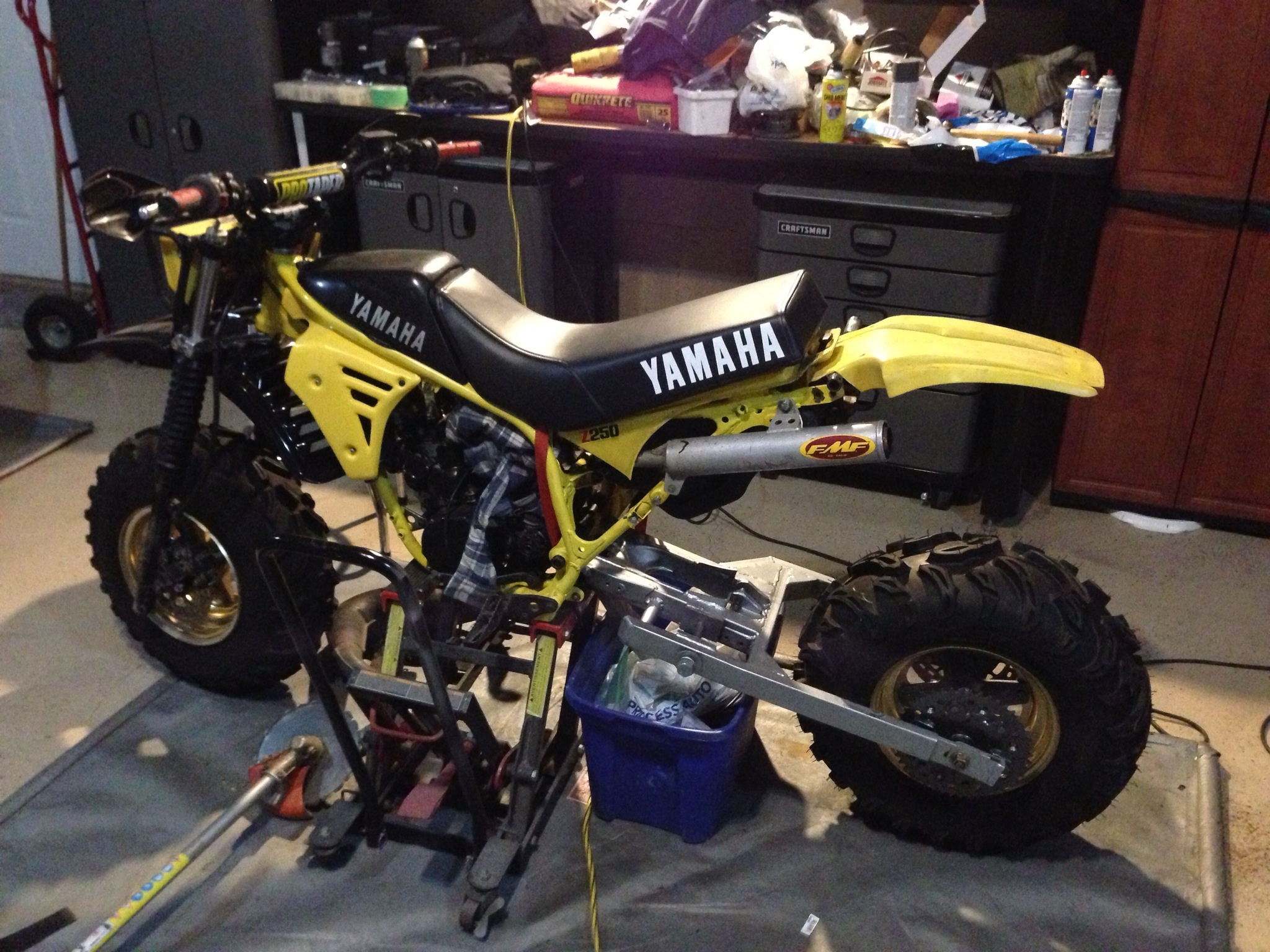

    The back tire is a Carlisle Black Rock 25-10 12 I don't know what it will handle like yet but I'm hoping it will be good. Got the exhaust and some other small jobs done today and ordered a custom rear brake line.

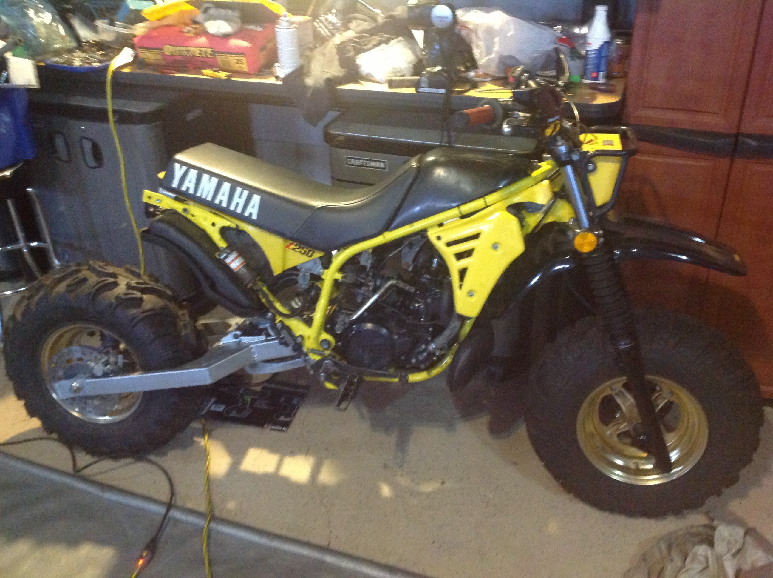

    Got the brakes finished up. I used a cr250 brake caliper and a Suzuki dr125 disc on the rear.
    Fabbed up a rear fender mounting bracket and a support to make everything solid ( all bolt on - no frame mods) bring for powder coating tomorrow.
    Changed fork oil and trans oil.
    Filled rads ( very happy there were no leaks as this bike was built from parts )
    Installed jack shaft and fabbed chain guard.
    Here are some pictures

    What did you do for a jack shaft? Are those sprockets welded to the bolt? Any bearings used?

    Greasable bushings, if the bushings don't hold up I'll bore each end of the hub out to except a bearing but the bushings are cheap and easy to change and did not require any machining to the sprocket hub. All parts for the jack shaft assembly are readily available and easy to make. The jack shaft chain is non adjustable but I did use a very high strength 520 chain and will likely have to change the whole section of chain when it needs adjusting.
    I machined a .75" bolt down to .625" and left only an inch of thread to the outside of the swing arm where a .75" nut was inset. I have attached a photo Click image for larger version.

    As the current owner of the 2cate that justben built I can tell you some of my personal feelings. Ive made opinions after putting quite a few miles on the 2cate.
    When ben finished the 2cate the trikes rake was way to steep to handle as a bigwheel, he added a steering stabilizer 1st then added rake by piecutting the frame. That fixed its ride!
    You will not like the rear tire, it is way to agressive.
    When you start riding it forget everything else you have ridden, they are their own beast.
    the best way to describe the feel is a topheavy MX bike w flat tires.
    I find I dont lean hard into turns, I lean the bike but try to keep my body upright, let them big tires find where they want to be.. lol
    good luck w the rest of the build!
