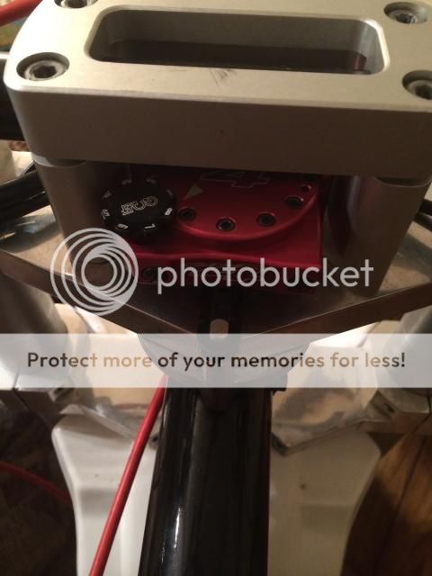

    Not a Scotts but a GPR and I have not tried it yet because the bike is not finished.
