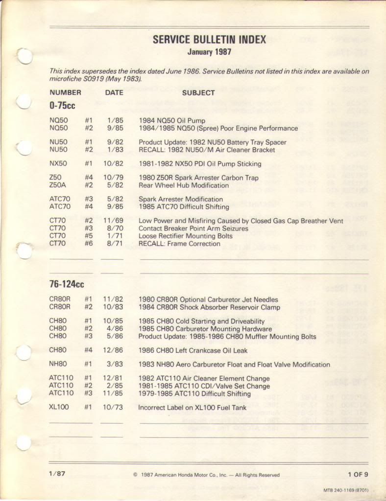

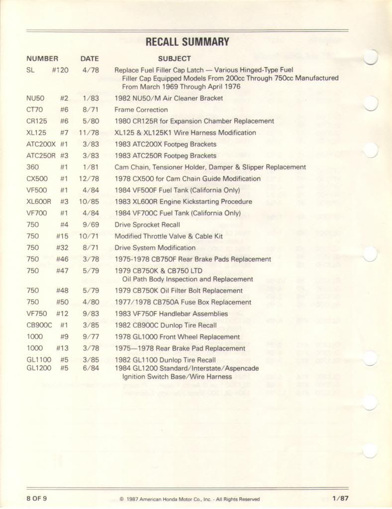

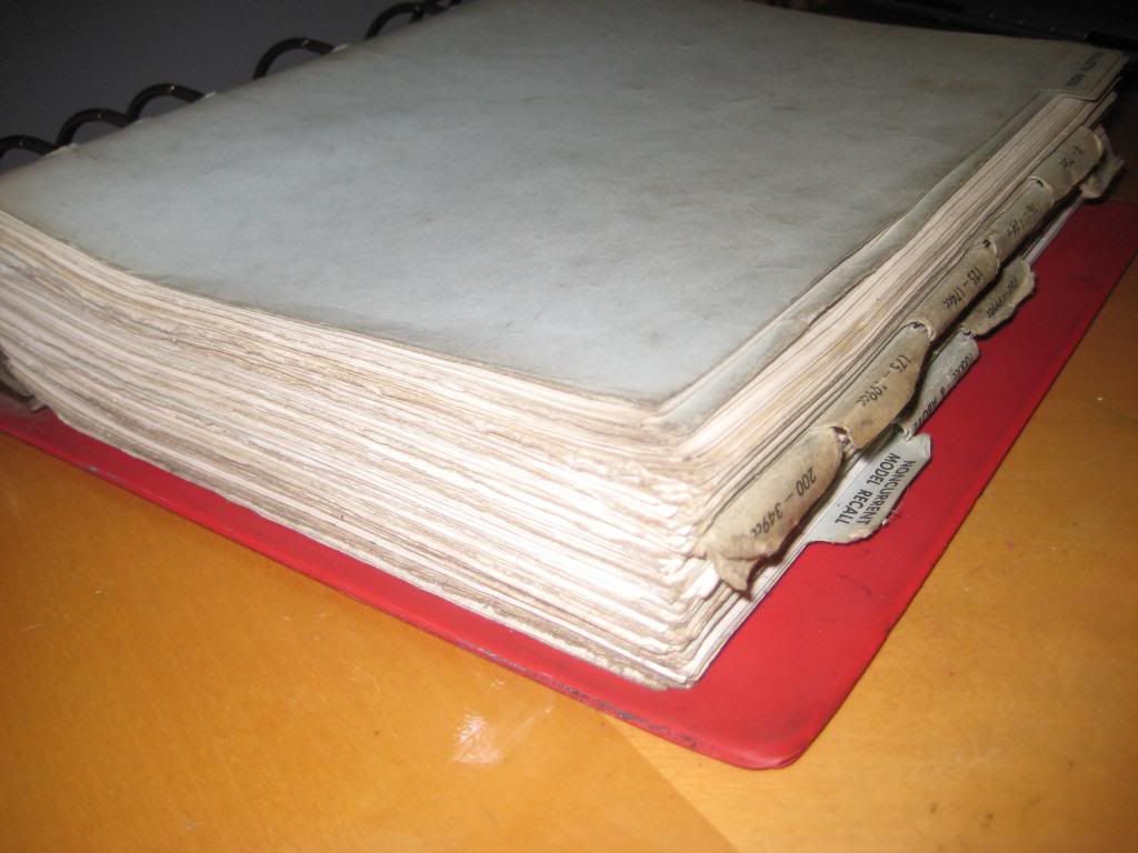

    I scored a collection of Honda Service Bulletins on e-bay. The binder appears pretty complete, and includes service bulletins through January of 1987.
    (ignore the print on the cover... their bulletin binder must have gotten wrecked, so the put them in this one...)
    I know some bulletins have been talked about and posted here and there, but I think I have a pretty complete collection here. My thoughts are that I'd like to scan all the ATC related ones and get them to the guys who are running the service manual download sites... that is unless somebody has already done this. In my searches, I've not seen one place with all of them.

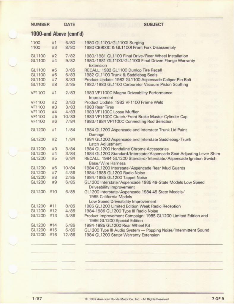

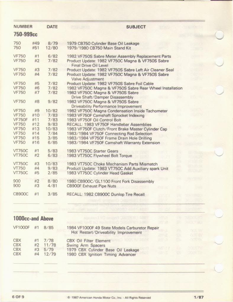

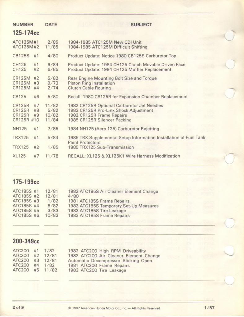

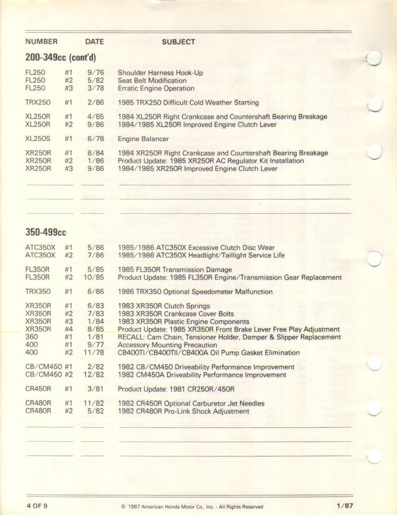

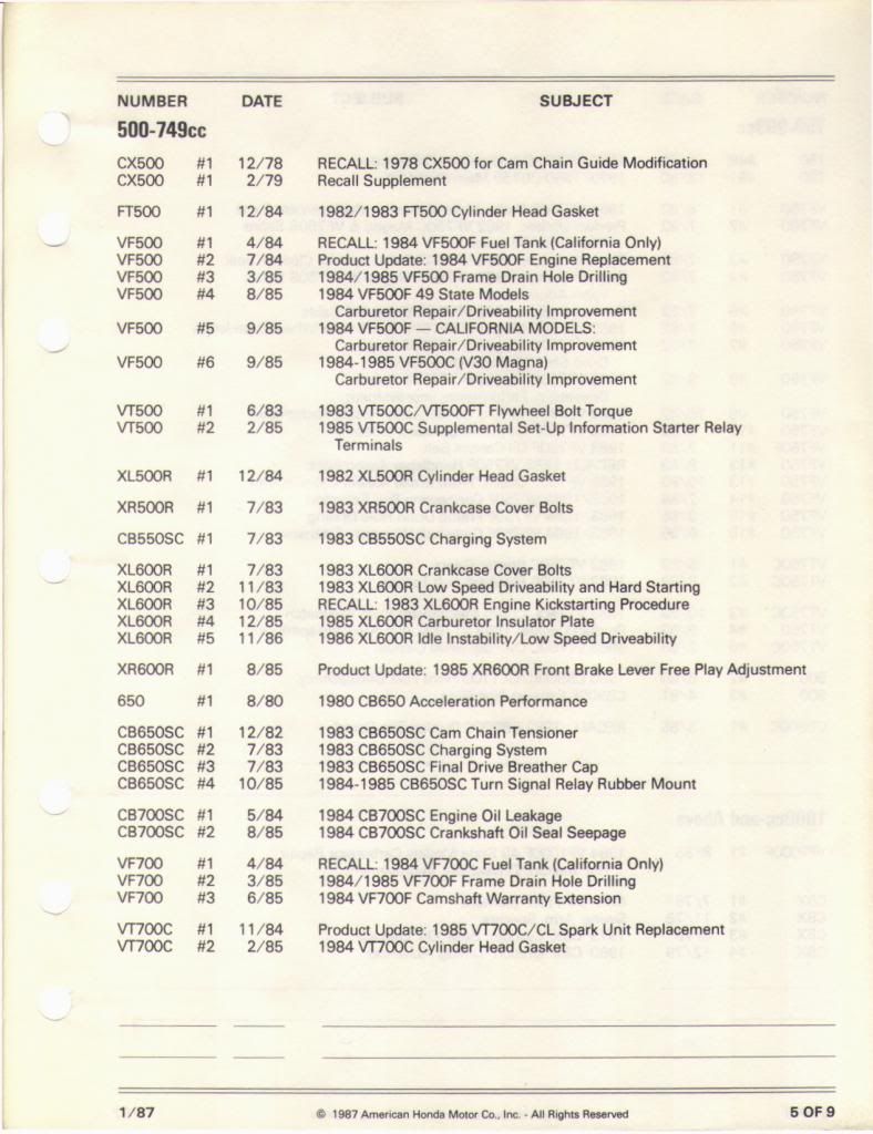

    Also, I figured I'd post the Index (9 pages) so that you guys can browse through the list and see if there is anything you'd like to see scanned first. Ultimately, I can scan all of the ATC ones (don't feel like doing the whole book... it is way too thick) but I can focus on the ones that may have the most interest for the group.
    I've been to a few of the download sites for Service Manuals, but I honestly am not sure who runs them, so if you know (or you are THE person) please let me know if you want my scans.
    Now, on to the index:

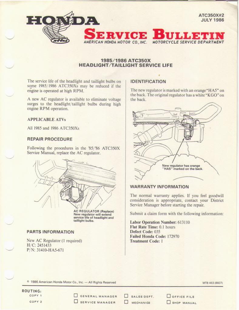

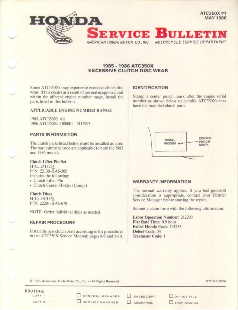

    350X
    350x Service Bulletins:
    ATC350X #1, May 1986
    ATC350X #2, July 1986

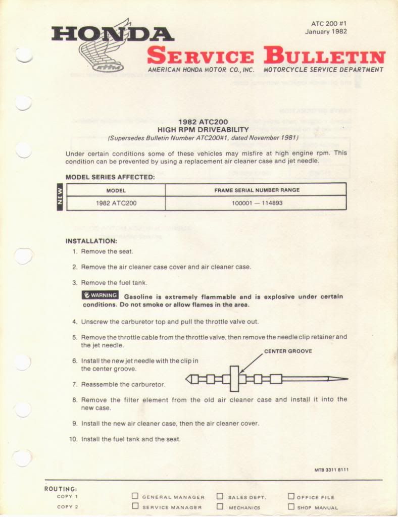

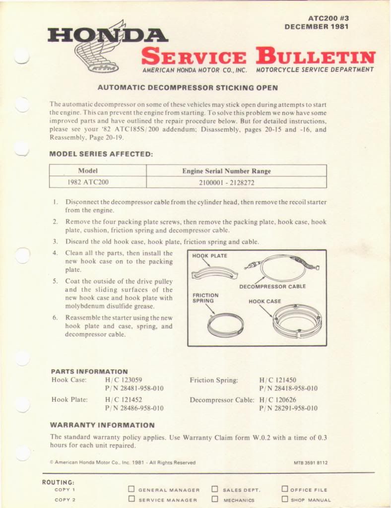

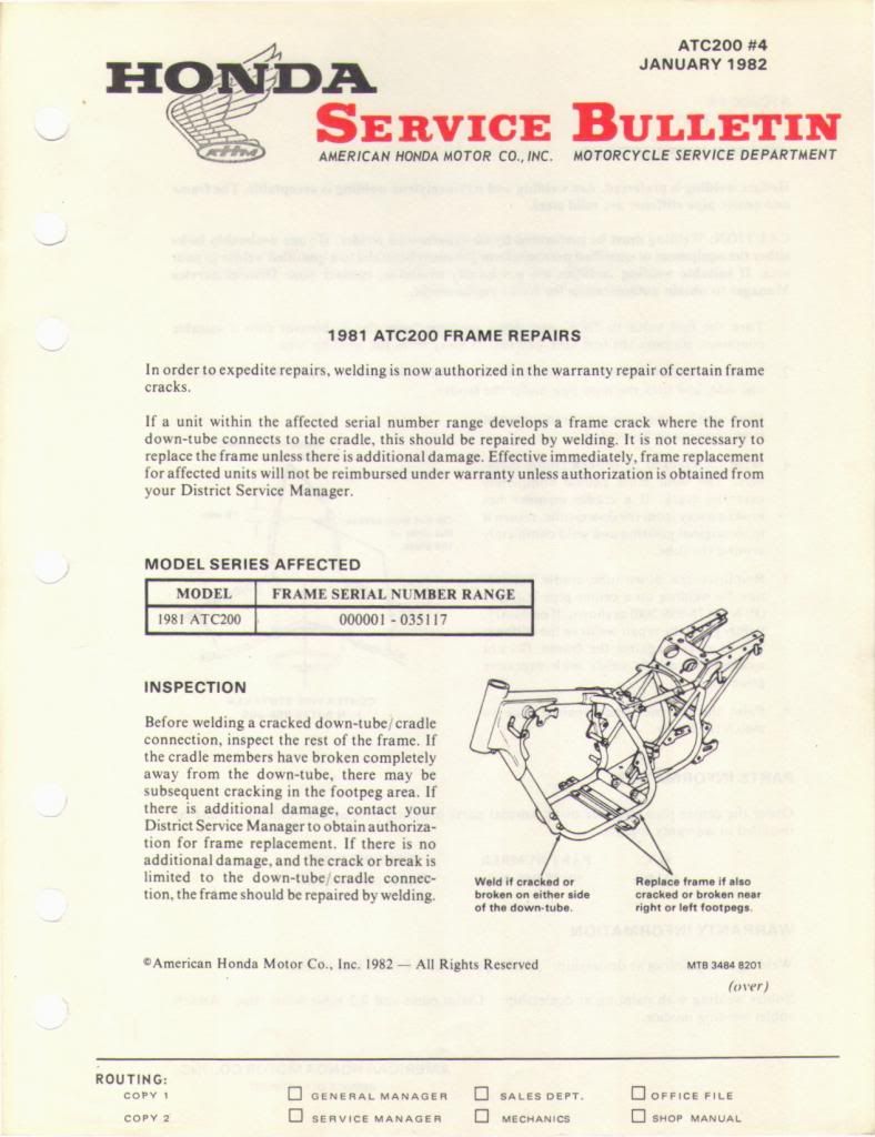

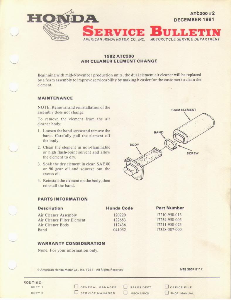

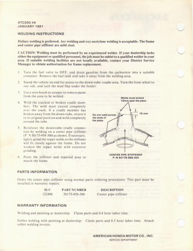

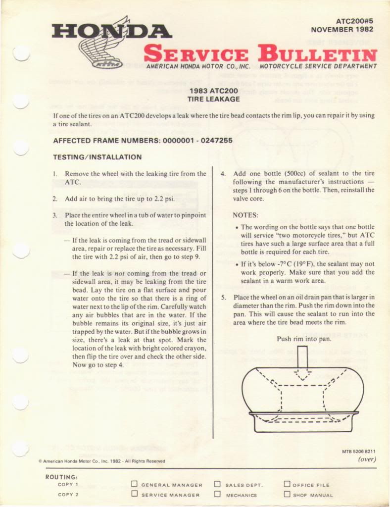

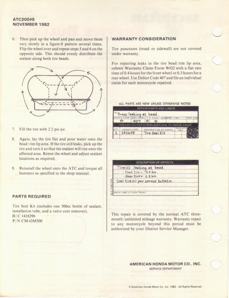

    ATC200
    ATC200 #1, January 1982
    ATC200 #2, December 1981
    ATC200 #3, December 1981
    ATC200 #4, January 1982
    ATC200 #5, November 1982

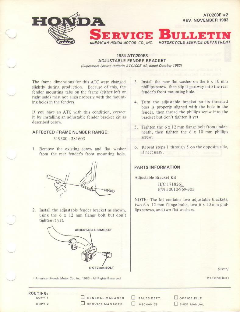

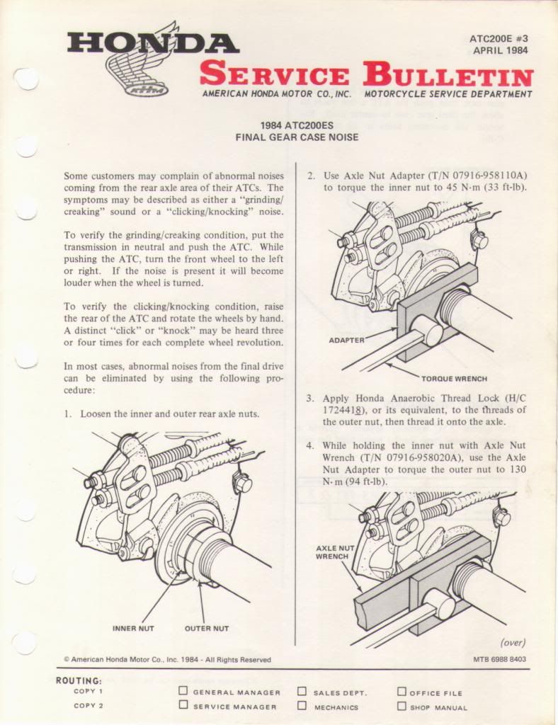

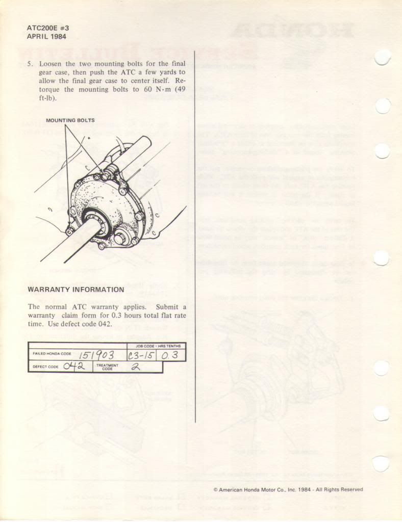

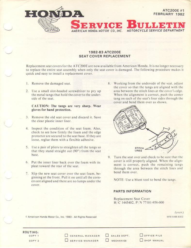

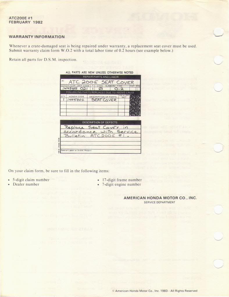

    ATC200E
    ATC200E #1, February 1982
    ATC200E #2, Rev November 1983
    ATC200ES
    ATC200E #3, April 1984

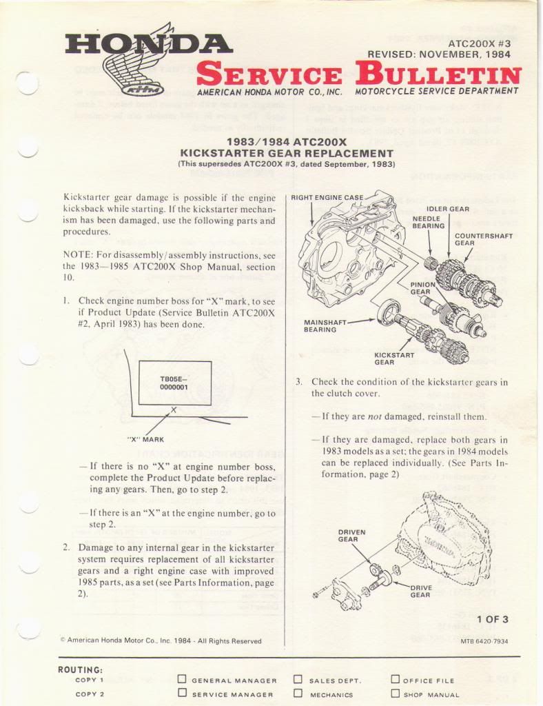

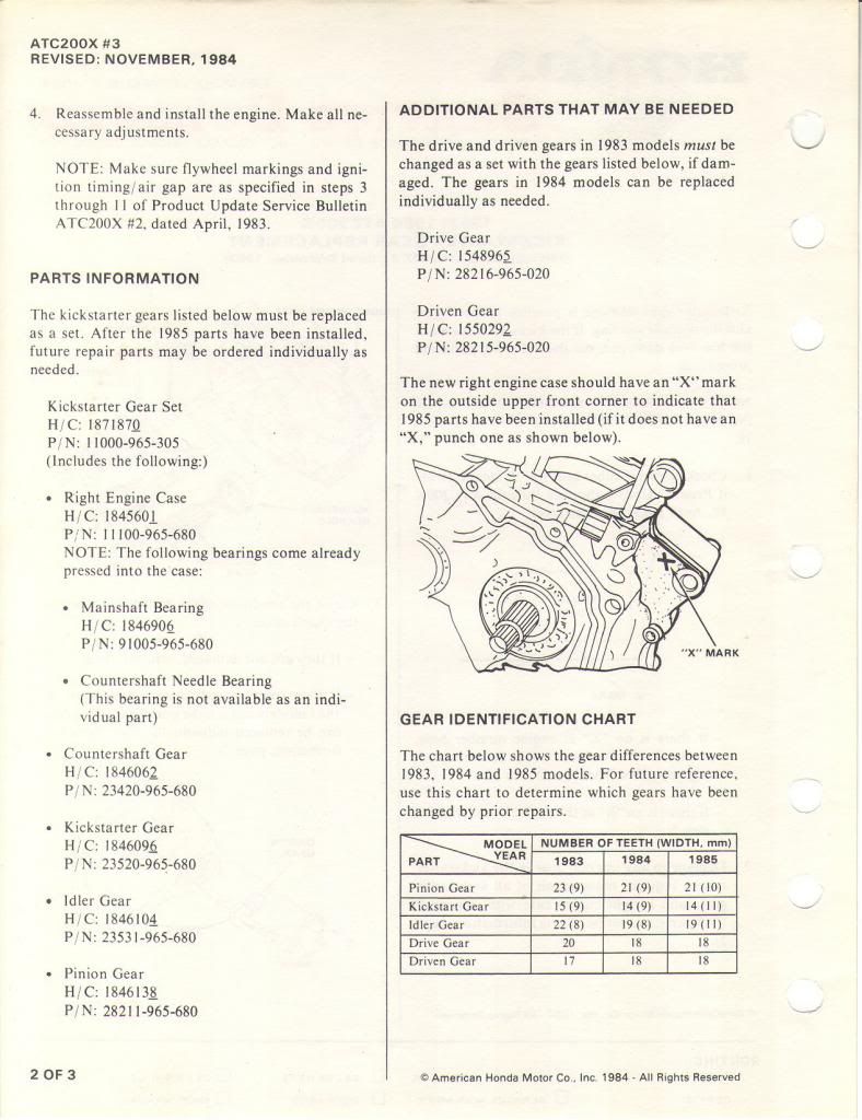

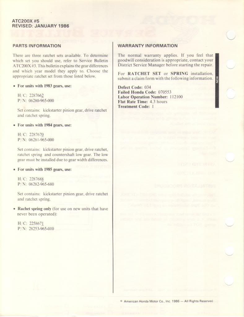

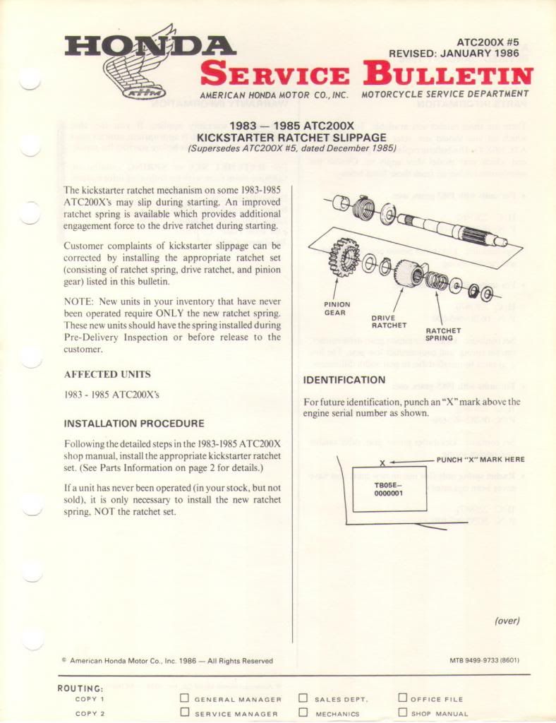

    ATC200X
    ATC200X #1: CRAP!! I don't have it in the binder!
    ATC200X #2: ...this one either.
    ATC200X #3, Revised November 1984:
    ATC200X #4, Revised November 1986
    ATC200X #5, Revised January 1986

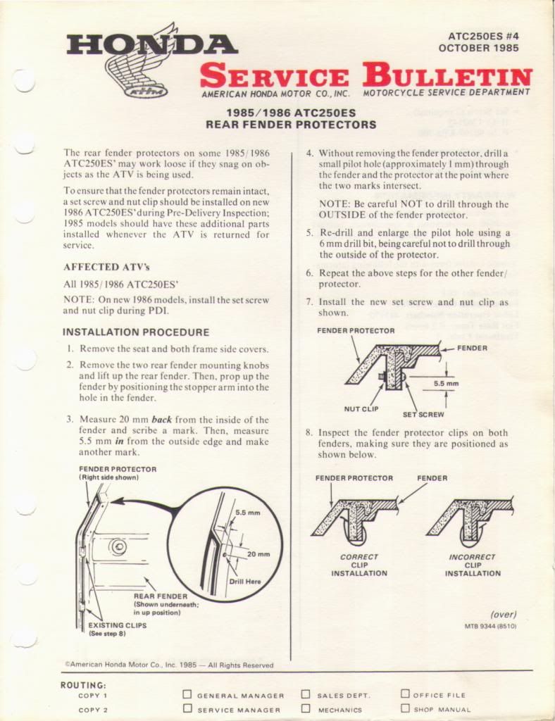

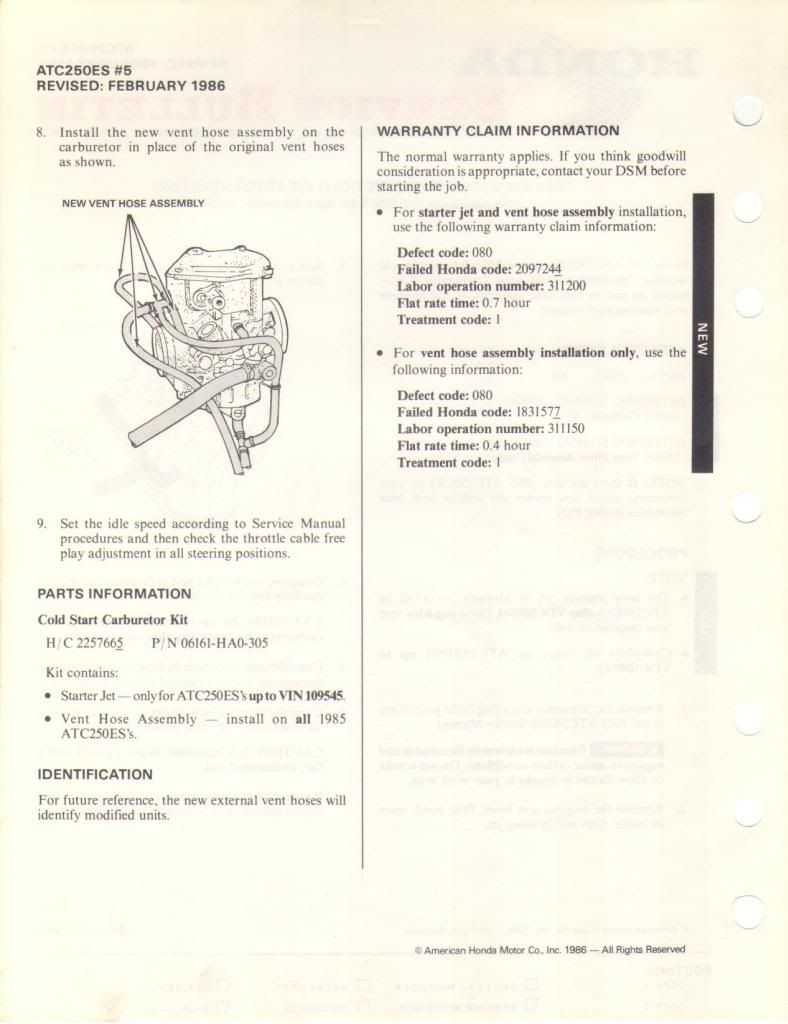

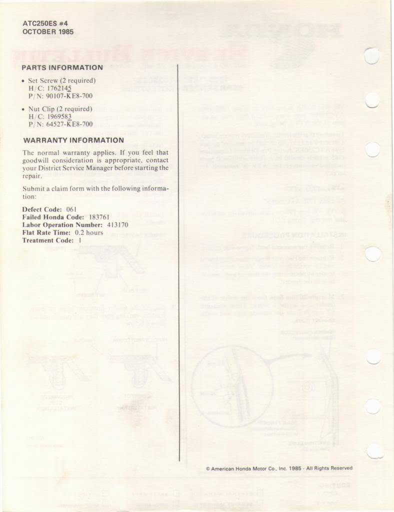

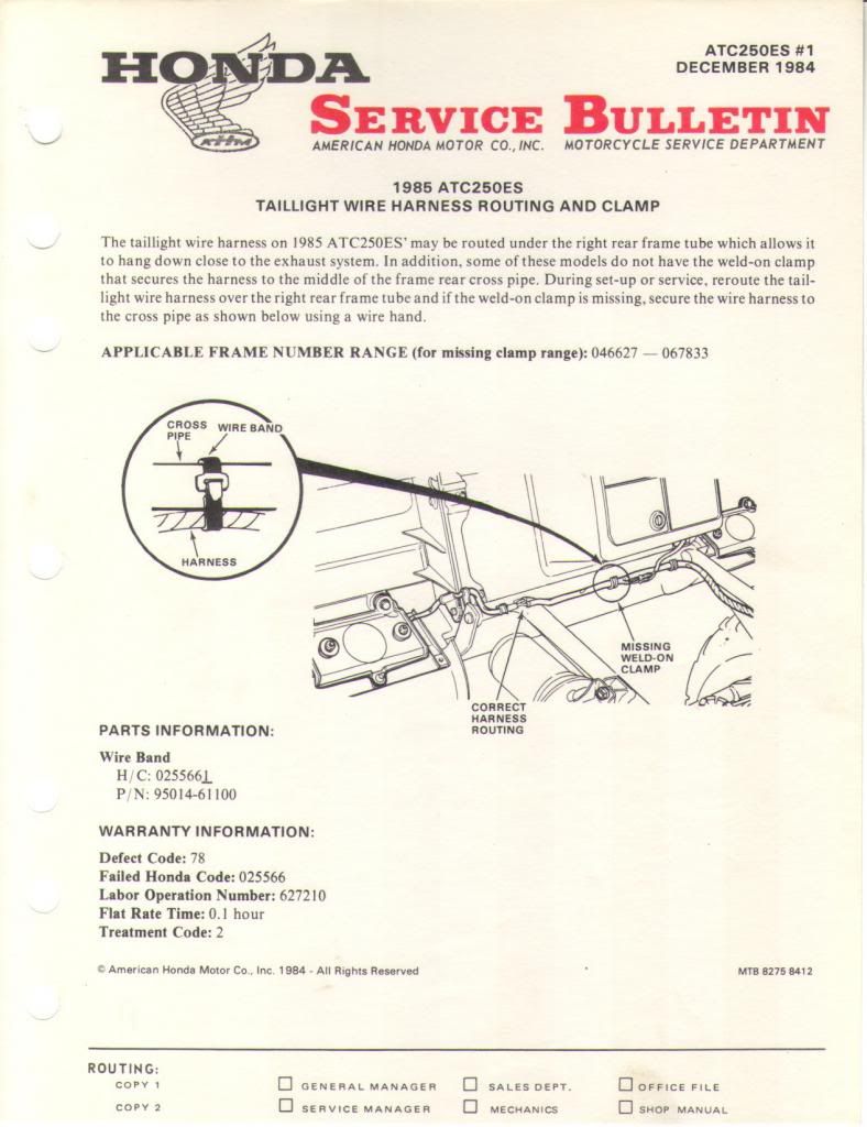

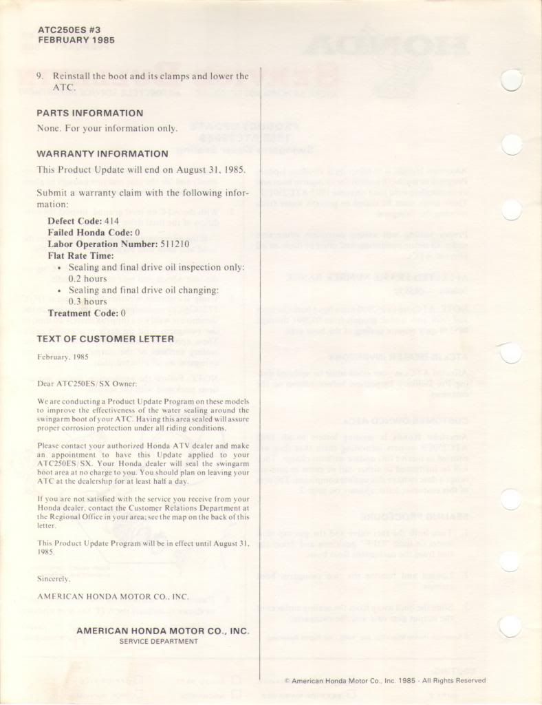

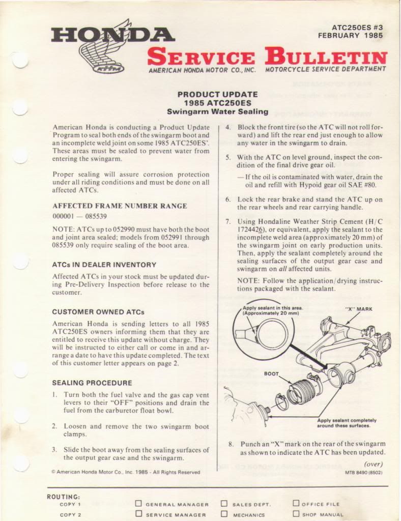

    ATC250ES
    ATC250ES #1, December 1984
    ATC250ES #2, January 1985
    ATC250ES #3, February 1985
    ATC250ES #4, October 1985
    ATC250ES #5, Revised February 1986
