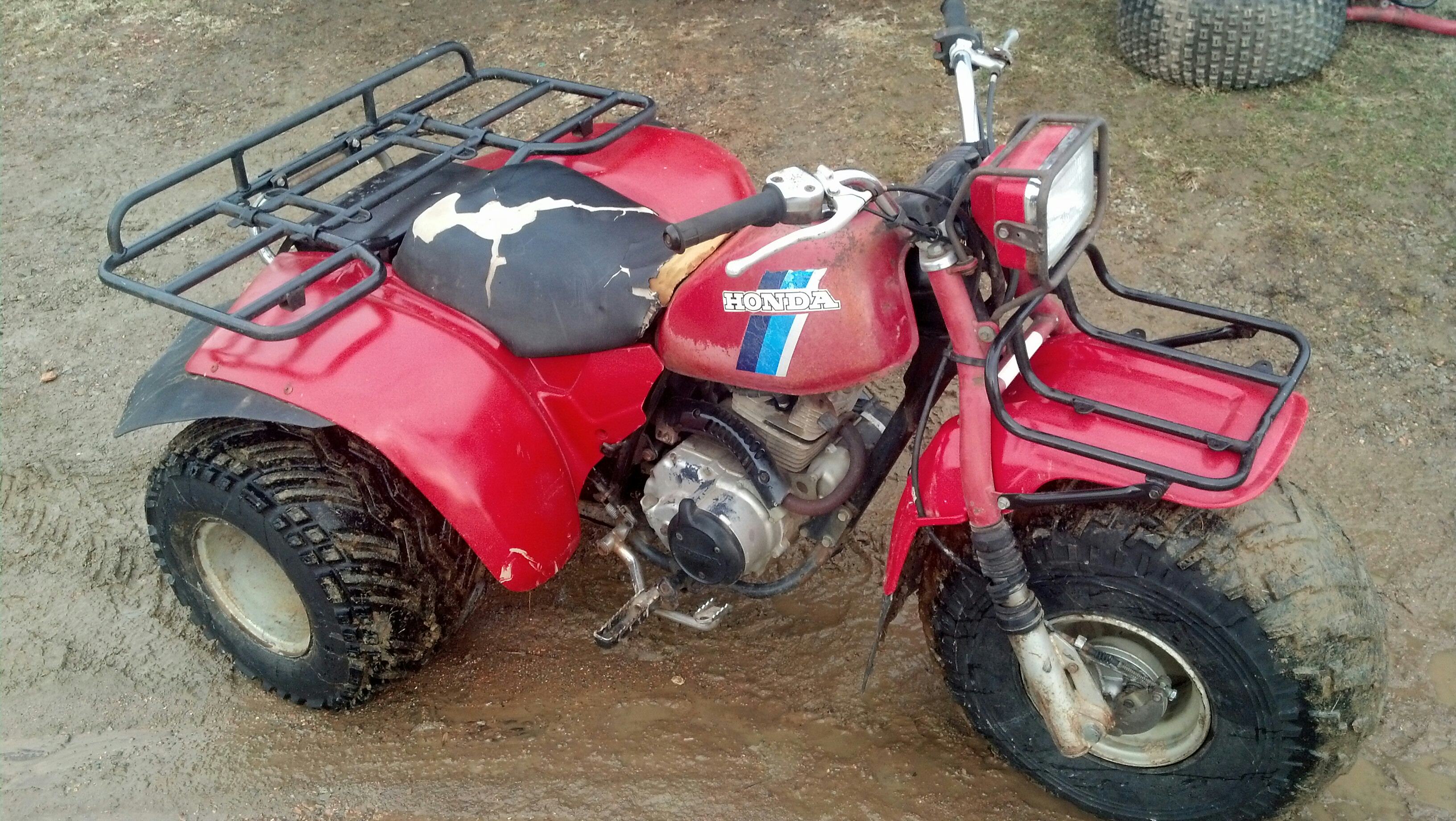

    I got it today! What do you guys think?
    Sep 2013
    Saskatchewan, Canada
    661
    I am liking it - looks like it is all there. How does it run??? If you replace some of the minor cosmetic items - it would be a clean looking unit. Now, get out there and enjoy it.
    Chopsaw is offline Just Too Addicted Arm chair racerJust too addicted
    May 2013
    St. Louis
    505
    Looks like a 84 200es with the wrong rear fenders . Rear fenders look like they might be from a regular 200 . Good start to a good machine ,,, have fun .
    cap's Avatar
    cap is offline At The Back Of The Pack Arm chair racerFirst time rider
    Jan 2014
    Nevada
    163
    That is what I'm thinking too, Trike is a 200E or ES with the back fenders off a 200 or 200S?? How did they make that work? Looks good anyhow!
    May 2013
    St. Louis
    505
    200s is smaller and more of a sport bike with one piece fenders . Regular 200's are left side / right side with a trunk . You can make the 2 piece fenders " work " on a 84 bigred if you drill new holes . They don't line up or fit like they should , but if you need rear fenders ,,, better than nothing .
    Girr you seem happy to have it , just pointing out the rear fender " facts " Looks like a great machine . Clean it up , tweek it out . Believe me I have worse that I'm trying to bring back to life . Enjoy .
