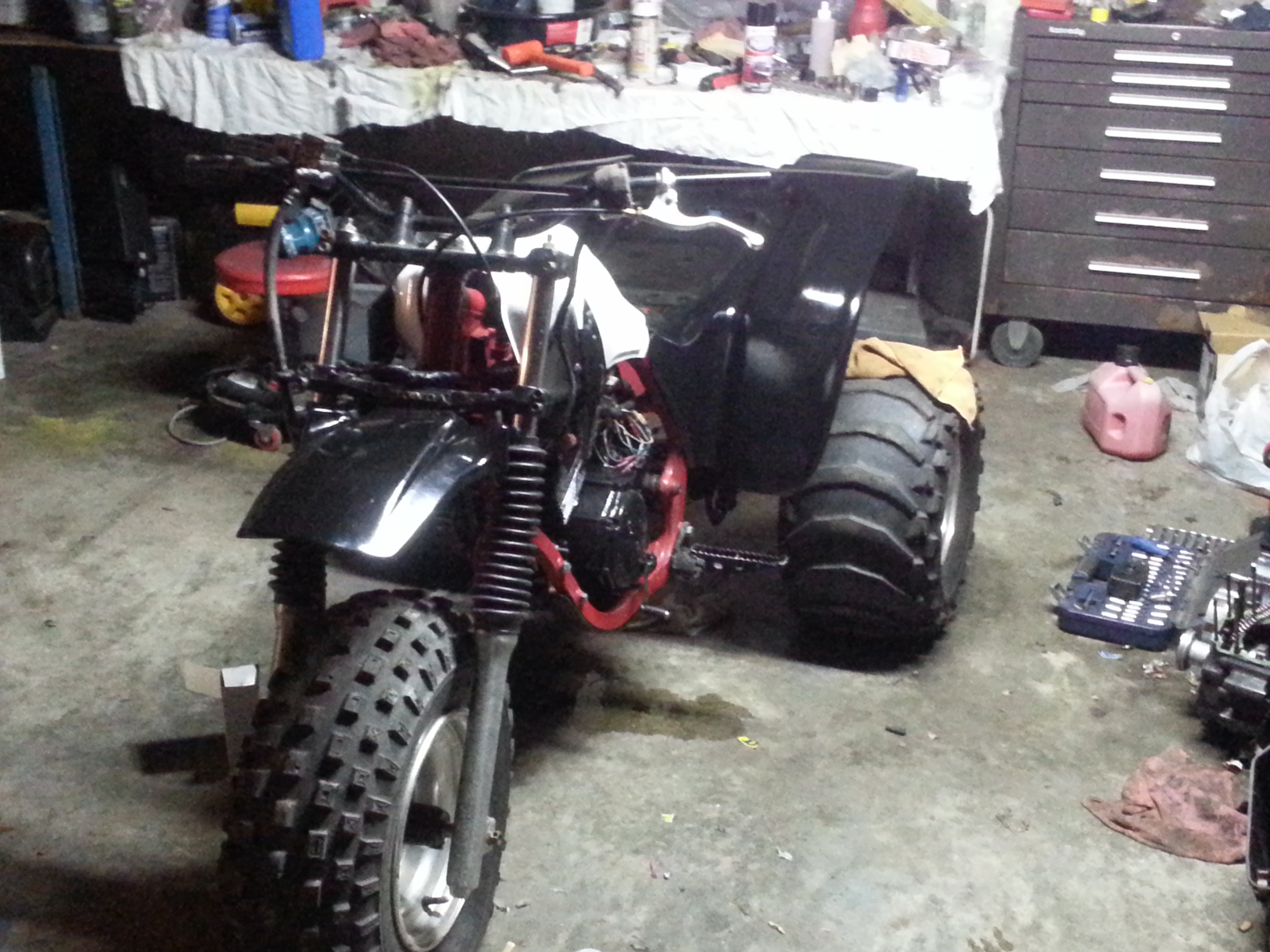

    Thanks for the tips I think I'll try both methods the spray paint on my 200x and I'm going to try the wet sanding and buffing on my 250r worst case I'm back at square one eBay for an aftermarket set Thanks guys I'll let you know how I make out

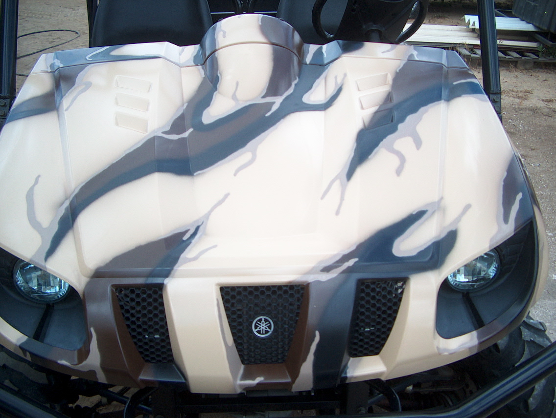

    My take on painting plastics is, dont do it unless your gonna put out the big bucks for the good stuff. This is a customers Ryno that I did a while back. Still looking good after 4yrs. No scratches or chips or flaking. If you have ugly plastics and are on a budget, sand and buff. Dont paint em. It just makes em uglier.

    Here's how it turned out
