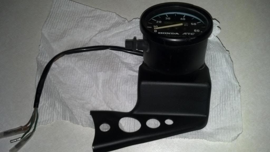

    The 250es speedo mount is different to most of the others, i`ve been making my own too, this picture is of the 250es mount. i will post a picture later of my own interpritation of it made of flat plate steel. hope this picture helps.

    Thanks I look forward to seeing your version. I will post up mine to upon completion.Click image for larger version.

    Ok guys here's what I decided to do. Don't laugh at me!! Ha! It cost me about $6 to make this, and a few hours to do some minor drilling. The round plate is an electrical box from the "electrician" area at Lowes. From their hardware section I got the rubber grommets they are 5/16. I used a piece of flat bar as the main bracket. I cut the flat bar with my Dremel cut off disc. I then painted the bracket satin black. I appreciate how supportive you guys are! Thanks to you all. I tried to use the bracket drawing that Bruce made for me. Due to the hand guards /bars that I have it wasn't going to work out. I think it turned out great though for what it is. Tell me what you think!

ID:	186781 final different angle. Looks good I think

    I definitely like the angle you have yours set at. On my 85 Bigred with its factory mount it has always seemed to me like it was engineered by a non-rider + not really readable at a glance while traveling along down a trail unless you leaned forward and right to view.
    So, you fab'd up a very usable mount for under 10 dollars ~ thumbs up !

    nice job. i gotta be honest, when i saw the first pic of the electrical box i was very skeptical. i was ready for a laugh. but it looks good. redneck of the day award goes to DJM!!
