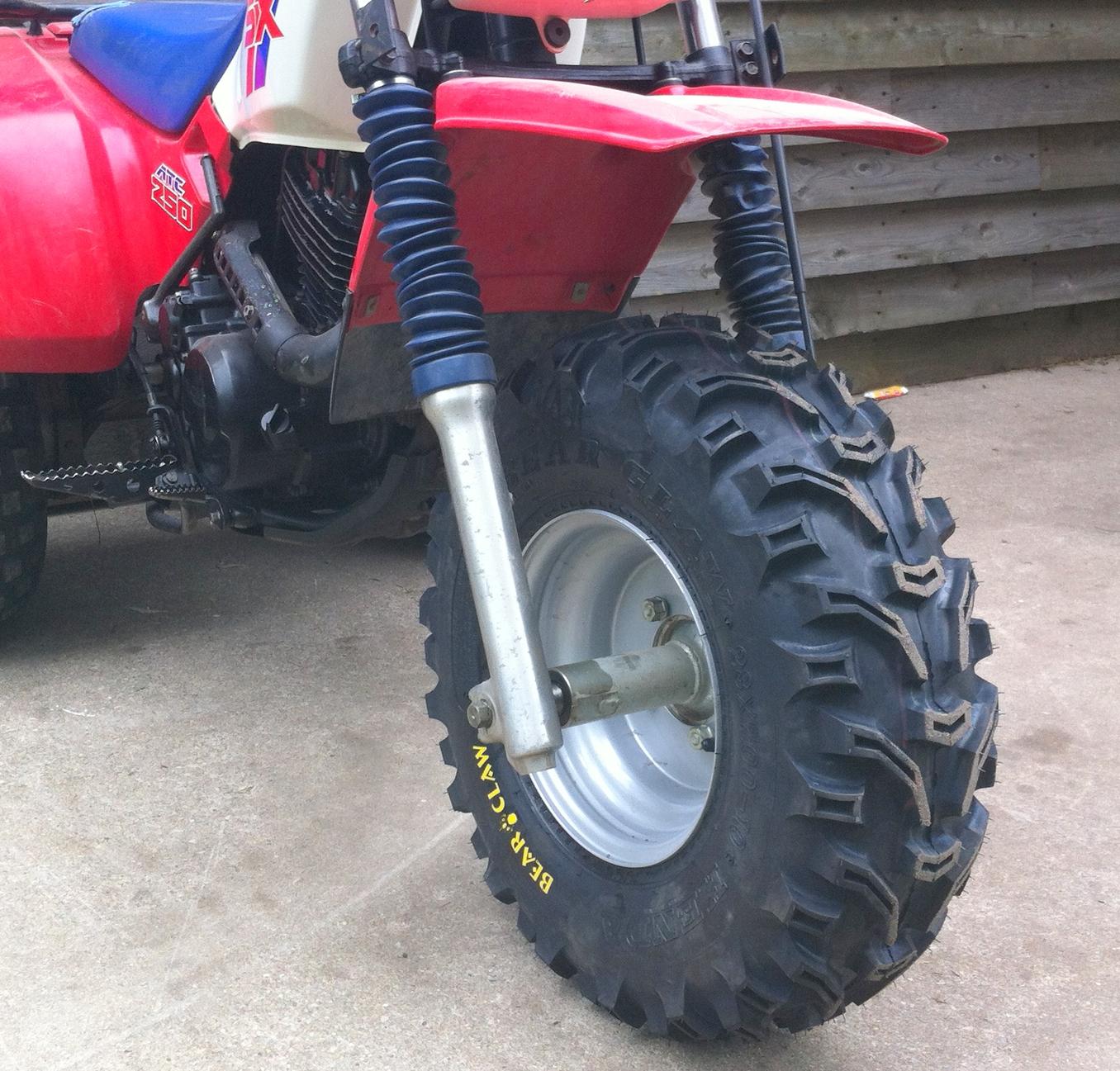

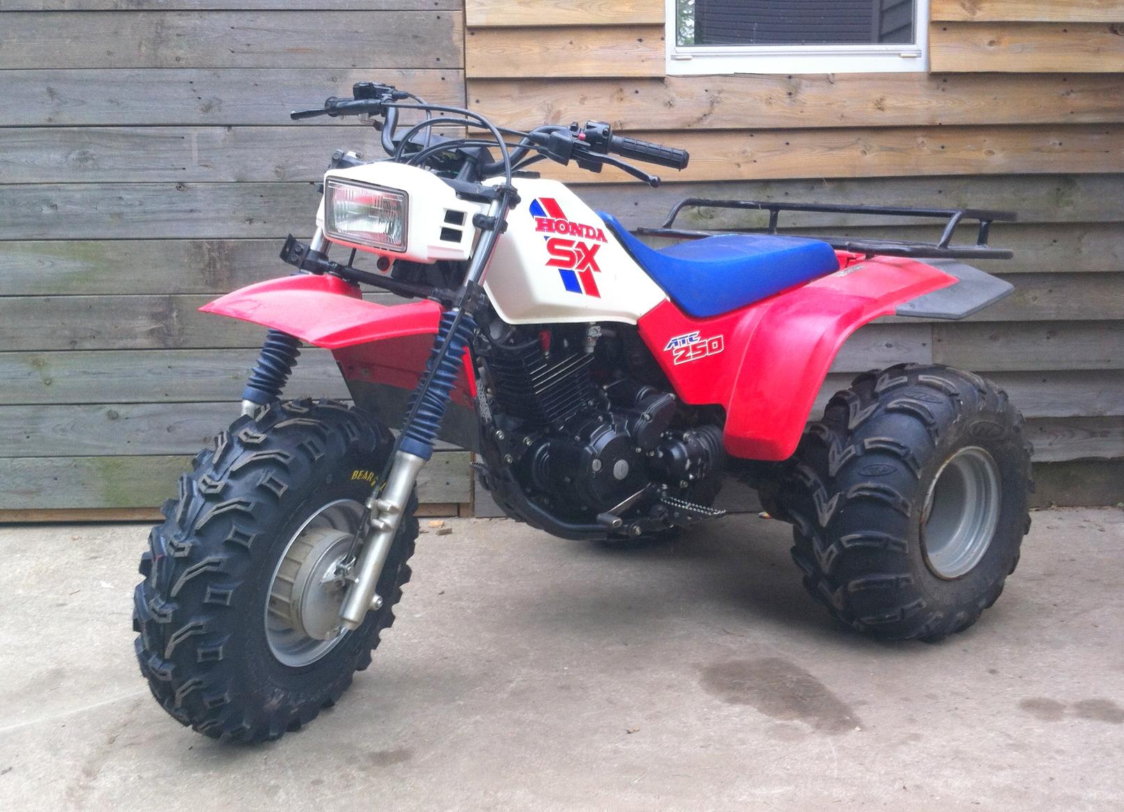

    Improved handling and less side slip in turns..
    Consider this update if you own one..huge improvement especially if teamed up with similar rear tires.
    This is the one I bought from Rocky Mountain ATV and it cost around $100 shipped..
    Rim: 4/110 ITP Steel Wheel 10x5 2.0 + 3.0
    Tire: Kenda Bear Claw ATV Tire 23x7-10( Feel free to sub in your own fav tire..but this size is a good fit )

    Alot cheaper and simpler than the alternative 200x/250r/350x front end swap some guys like to do.
    Looks pretty kickazz too!

    i agree with doug. its an upgrade. minor drawback is it will bite and try to pin a bit more, but 100% worth the upgrade. nice name BTW. welcome aboard!

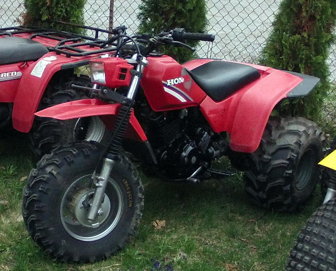

    Know that if you run a tire that is to wide on the front it will rub the lower tube . In the pics the tire on the right is the one that came on it , tire on the left is the replacement .

    I have seen forks wore right through on 250 sx's and 250es's from to wide of tires. Here are a few pics of my wifes sx with a narrow front tire. It has a 21x7x10 on it when this tire wears out we will put a 22 on it.
