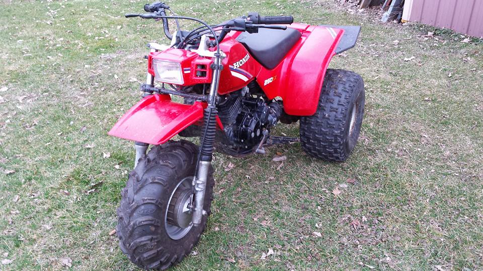

    So I am doing this wheel/tire swap right now, but I can't get the lug studs to exactly line up. they are just a butt hair off and can't go thru the holes together. anyone else have this issue. I'm currently charging up my drill to adjust the holes a little to see if I can get the wheel to go on.

    Quote Originally Posted by 3is4Fun View Post
    I have now done this tire/wheel swap to both of my SX's, and yes on one of them I had to use a step drill bit to open up the hole just a tad on the wheel. After that, it slid right onto the hub.

    Finally got the wheel on, used a round file to widen the holes slightly.
    went with the Maxxis Pro 23x7x10

    Did the front tire swap also. Haven't ridden it yet though. The tip about the step drill was key opened each hole in the rim a C hair. Perfect fit. Here are some pics..
    Before
    After
