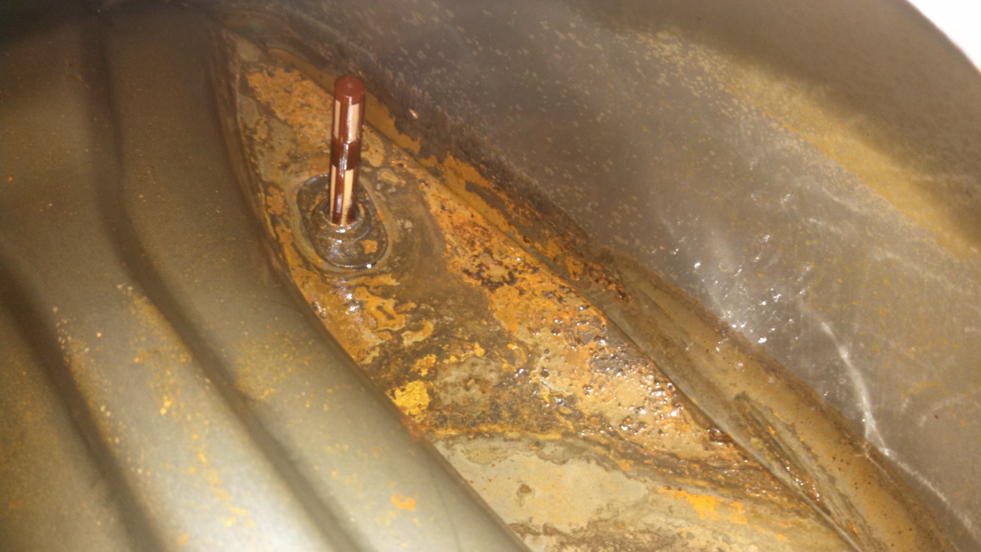

    ok so i bolded the cold and syphened (sp?) the gas out which looked clear but yellow like piss, not sure the color of gas these days..
    i took some pics inside the tank.. im not sure if its bad or normal.
    As for that thing sticking up inside the tank, is it part of the petcock and would a new petcock come with this? My petcock was rally bad, the o ring inside it is chewed up and both ends of the fuel line after the petcock are as well so I wonder if I was losing gas slowly here or maybe pressure (of some sort?) keeping gas from entering carb...
    Do you guys know if I can buy the fuel line that connects petcock to carb? and if so do I just cut it to put a fuel filter between? The petcocks for sale dont come with the fuel line, but some carbs do. Since I'm not going to do the carb just yet I would like to just get this fuel line to get clean gas into the carb and see what happens. I appreciate all of your help fellas!

    That tank isnt bad at all, will clean up really easy, a little Apple Cider Vinegar soak will do it, but its not so bad that i would spend the time soaking the whole tank. Get a small long brush and clean it best you can and flush it out with some acetone or fresh fuel. The fuel filter will prevent future issues.
    Yes the petcock comes with the filter tube. Yes 3/16" ID fuel line is correct.
