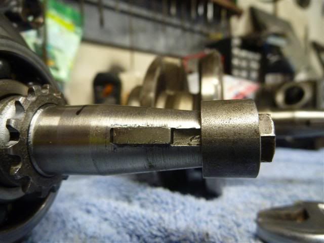

    Here is another stroked and bore 110 i have built
    Machined a atc125 crank to fit into a 110.
    This allows no pull start and 12v cdi with a pick up in the cases and is single range.

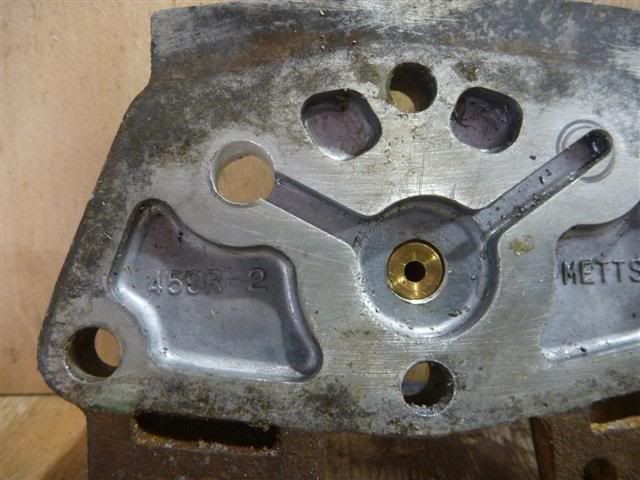

    2 different ways of making oil cooler pickup plates
    First i modified a stock plate
    Passage blocked to redirect oil to cooler & the beginning of a custom pickup plate

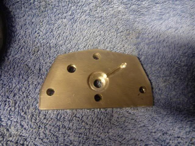

    Custom plate

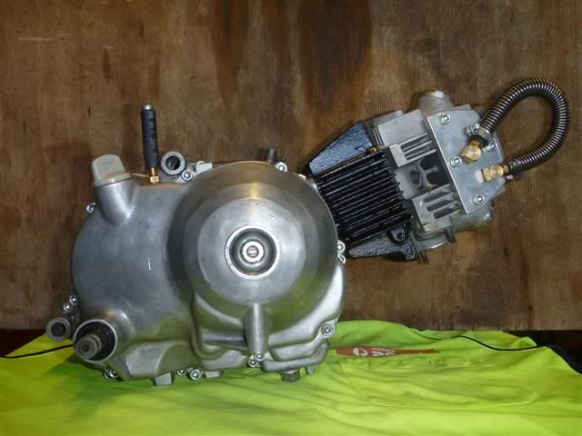

    Ok the completed motor with a breather outlet in clutch cover
    atc125 barrel,head crank&piston 127cc
    This one ended up cammed and 24mm carbed.Pulls real hard cam kicks somewhere near 5000 rpm and slingshots you.
    I really like this engine .Now it's time to build the something bigger
