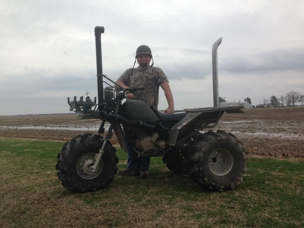

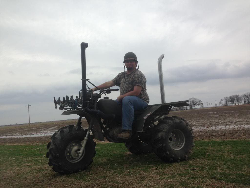

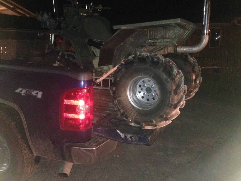

    Here's a few more pictures just to give a little more perspective on how tall this thing is. I'm 5' 11" and 270. The snorkel and stack are actully only about an inch taller than me, they just look taller cause I'm standin behind it.
    It barely fit in the bed of my truck, because I have a low profile toolbox with about 9" of dead space in front of it so that it can open without taking my tonneau cover off. So I ended up haulin it and my campin stuff down to Texas in a box trailer.
