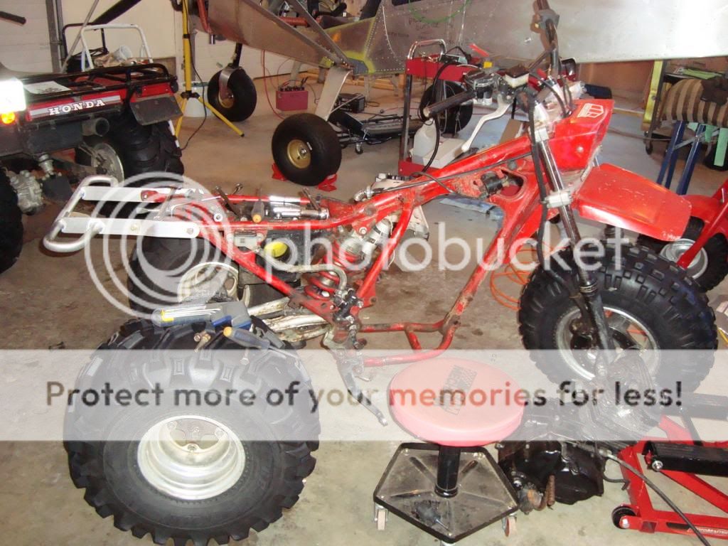

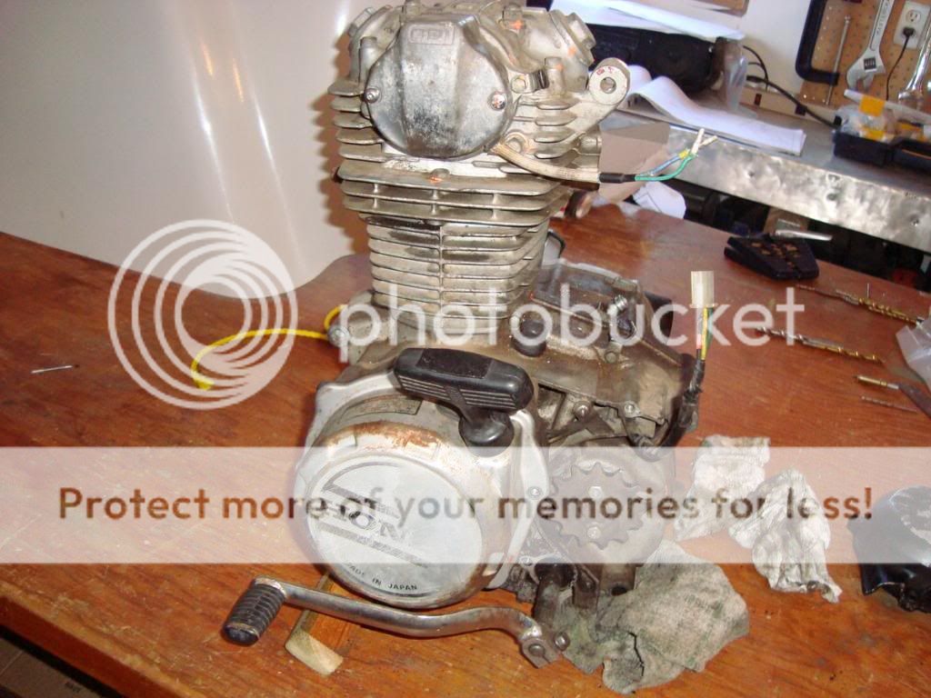

    So I decided to pull the engine...
    Since there is nothing much left that it could be. It's not a intake leak and fuel flow test was fine. Compression is also fine but consensus is that the cam or valves might be worn out enough to cause the issue... I tried both carbs, the 200x original and a new one + a standard 200 carb. It wouldn't even idle on the regular 200 carb!
    Here she is in all her "glory"...

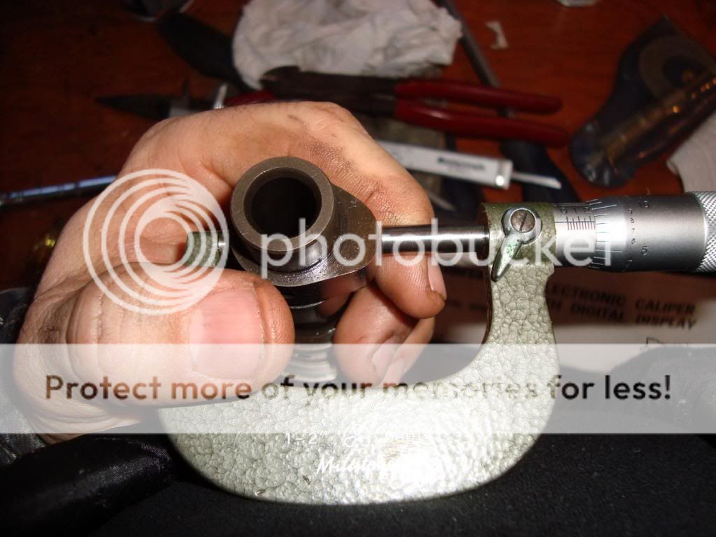

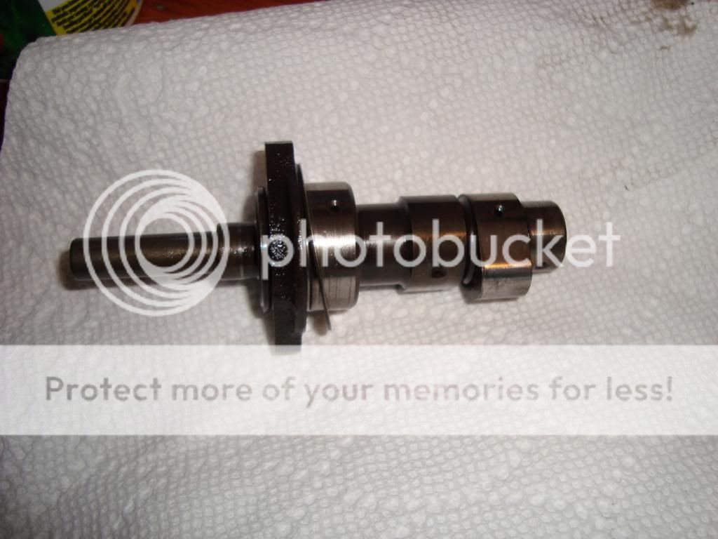

    Pulled out the cam... super clean, no pitts, no scores, nada!!!! $%^&*()

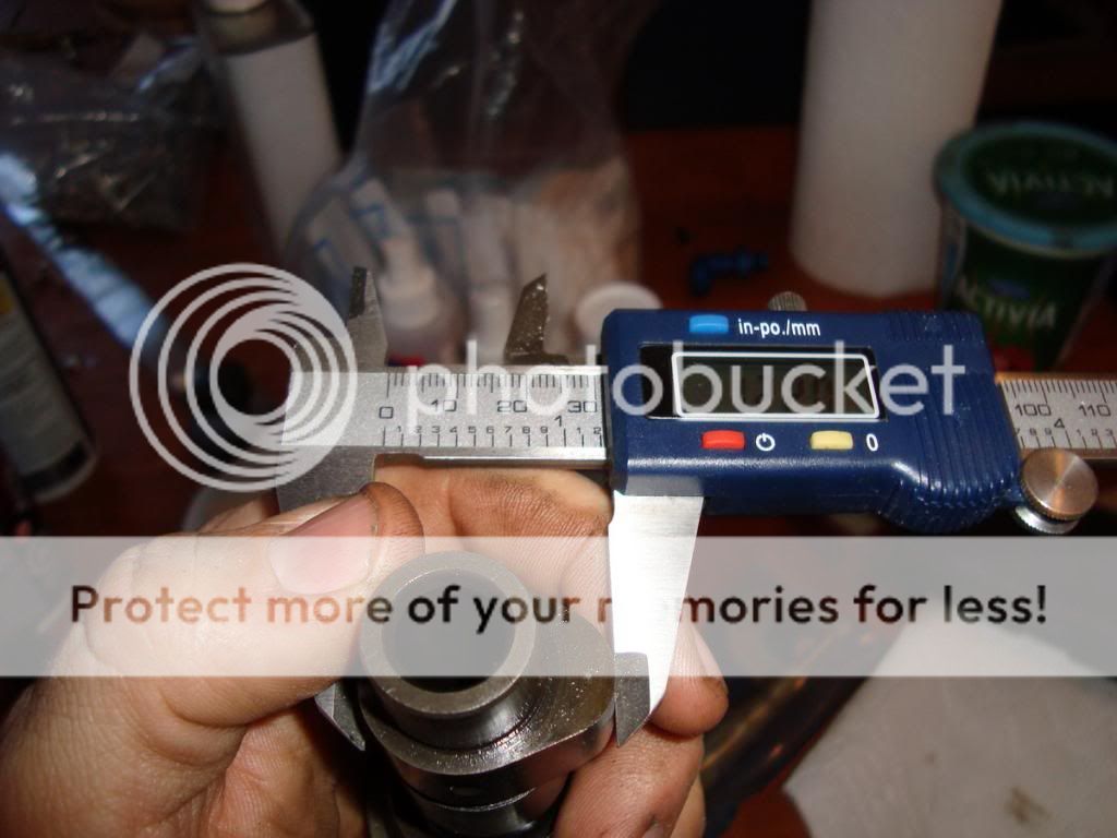

    Checked the lobes, they are a hair worn off but still in spec. Don't trust these calipers too much, but they are good for a good quick check.
    Double checked with old faithful
    Double checked with old faithful, calipers were bang on, she's within spec!!! I'm going to pull the top end off and replace the valves and cam anyways. Not going to bother with the piston or rings. Compression is fine but since the cam is close to being out of spec, maybe the valves and tappets are all just hairs off enough to cause the issue. At least then I'll be sure it's not the damn motor!!!
