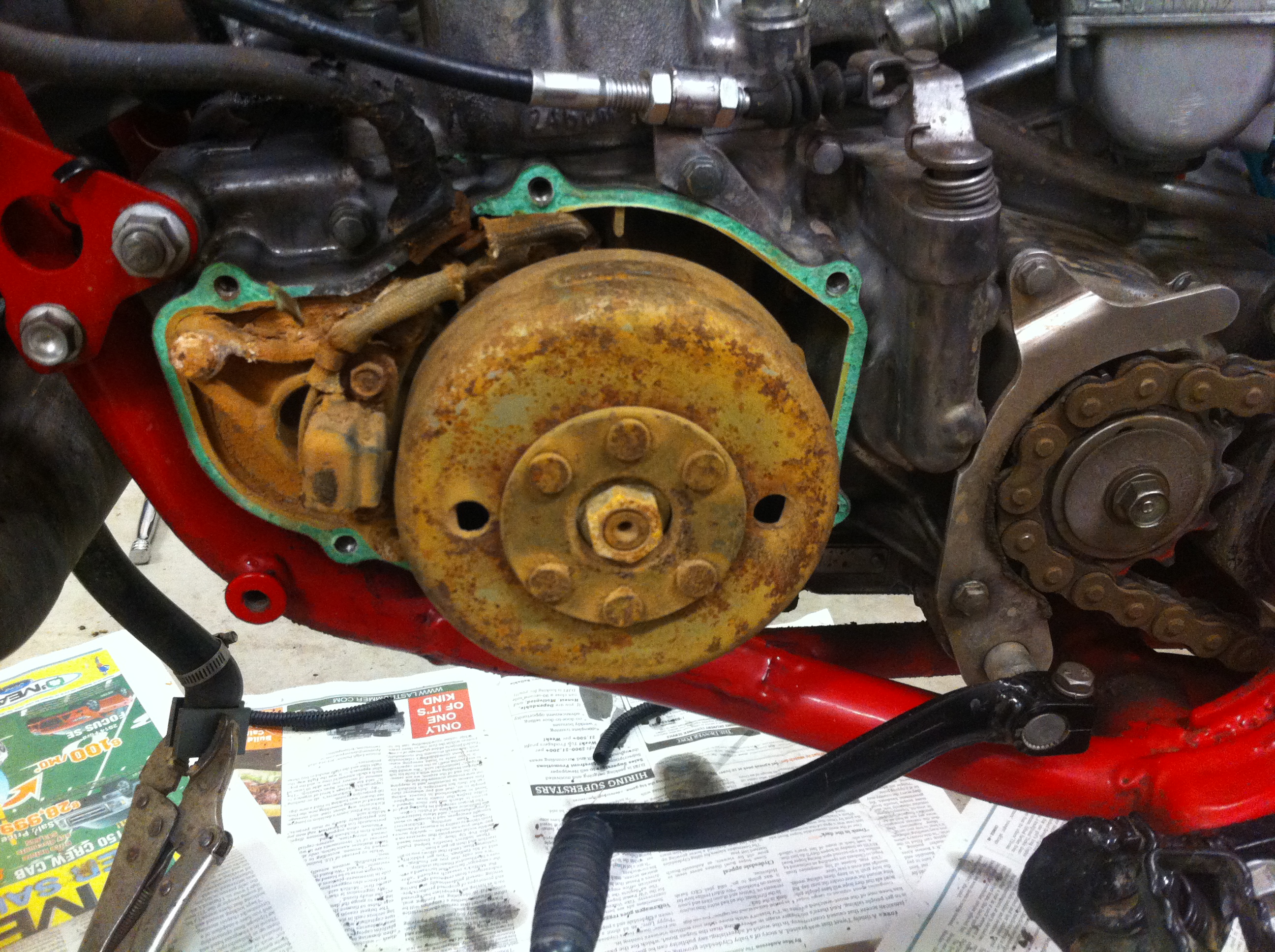

    Thanks for all the replies so far! There's been some great advice given, but I think I found the problem..
    After doing some more reading and having the rest of the electrical check out (actually got a connection on the red-black wire), I decided to pull the flywheel case off after dinner.
    Was immediately concerned after I pulled the first bolt out (first one on the upper level towards the fork) and saw it was fairly corroded with rust; luckily the other five were in perfectly fine condition.
    As soon as I cracked the cover open it started raining rust and dirt like no tomorrow, anddd that's when I knew this semi-fishy deal became officially fishy
    The whole alternator / stator / flywheel assembly looks like it's been sitting at the bottom of a lake for the last twenty years; explains why I couldn't get a consistent spark (at least to me).
    Anyways, the problem I'm having now is I can't get the flywheel off and I saw the price of a replacement from a local dealer if I mess this one up

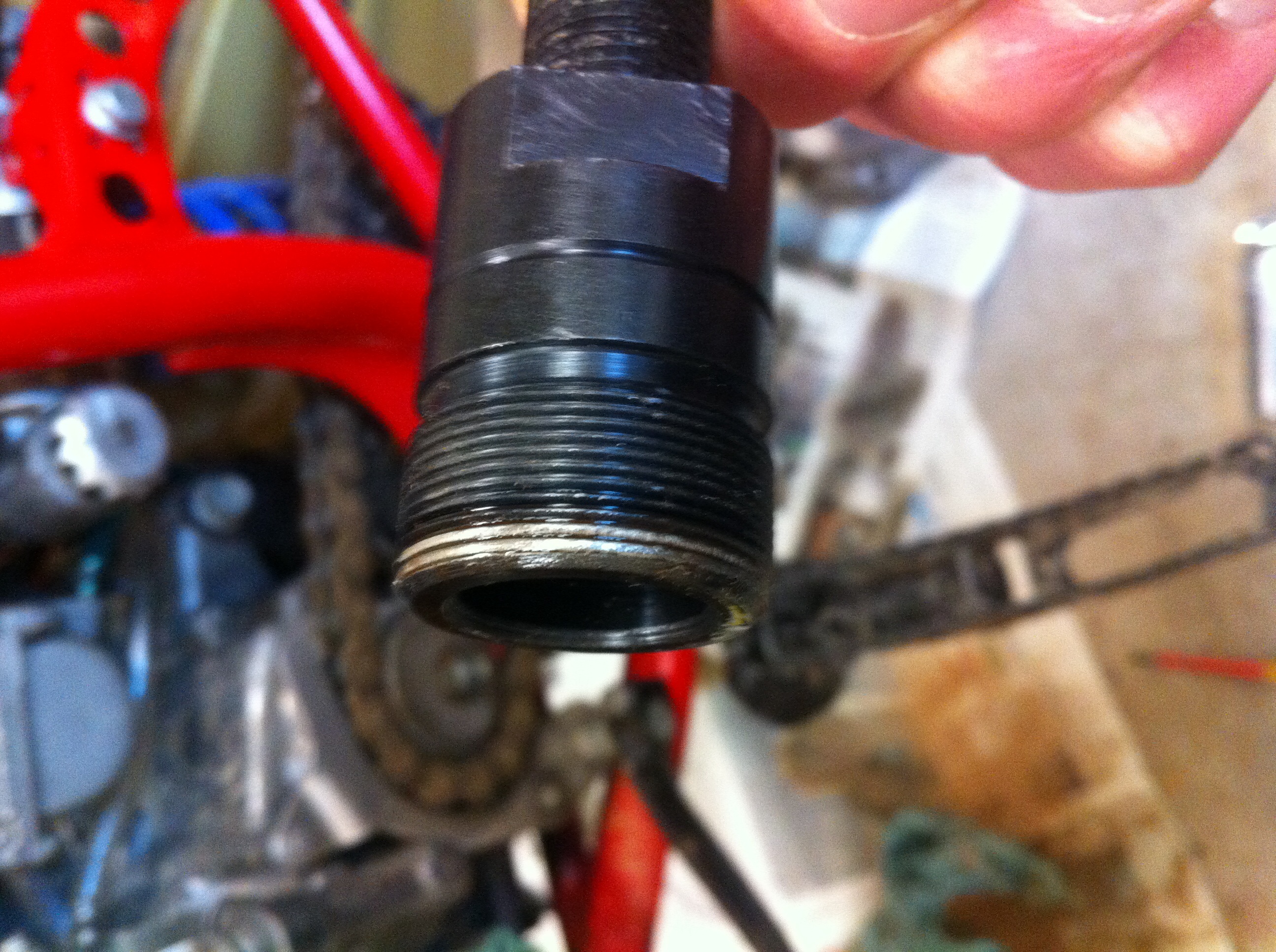

    Question
    Shouldn't this be working? Ran up to a dealer this morning and bought it thinking it was what I needed.
    Started to thread it in but I'm pretty sure it got cross threaded on accident?

    Quote Originally Posted by Scooter95 View Post
    Never done this before..
    You bought "thinking" it was what you needed...maybe it isn't and the threads are not the right pitch. Therefore maybe, with a little luck, your threads are okay. I'm just guessing, but as long as you didn't goober up the threads you'll be okay. Make you have the right tool...I've seen them on eBay.

    You have the correct tool. You need to get a wire wheel in there and clean the rust off those threads first then use some grease/anti seize on the puller. thread the puller into the flywheel a little bit at a time then back it out and repeat. You'll get it. That puller is used on tons of machines so keep it around.

    I was fairly confident I purchased the correct puller (27x1mm left hand threads) to start with, but trying to clean the flywheel threads up was my next guess.
    I think I can still make the puller work even though it's a bit goobered, but I'll run up to town and grab another one if I have to.

    Wow, now here is a suggestion far ya. Get a handheld siphoning blasting kit, some glass bead and make a thick cardboard cut out that exposes the alternator housing but covers everything outside of it. Use the bolt holes and bolts to fasten it to the engine where the gasket runs. Then carefully blast all that rust away. The glass beed wont damage any internal parts or the wires as long as you don't constantly blast on them. Plug any holes that go inside the engine in that housing with rubber plugs or a good thick cap of aluminum tape. And clean it all after with some air. Make sure you are outside where you can make a mess and wear coveralls and blasting full head cover. The glass beads will be flying around quite a bit.
    The parts should look as good as new. Replace your alternator and its electrical parts for good measure.

    Well I managed to get the puller fully threaded on without messing the flywheel up and the thing popped right out!
