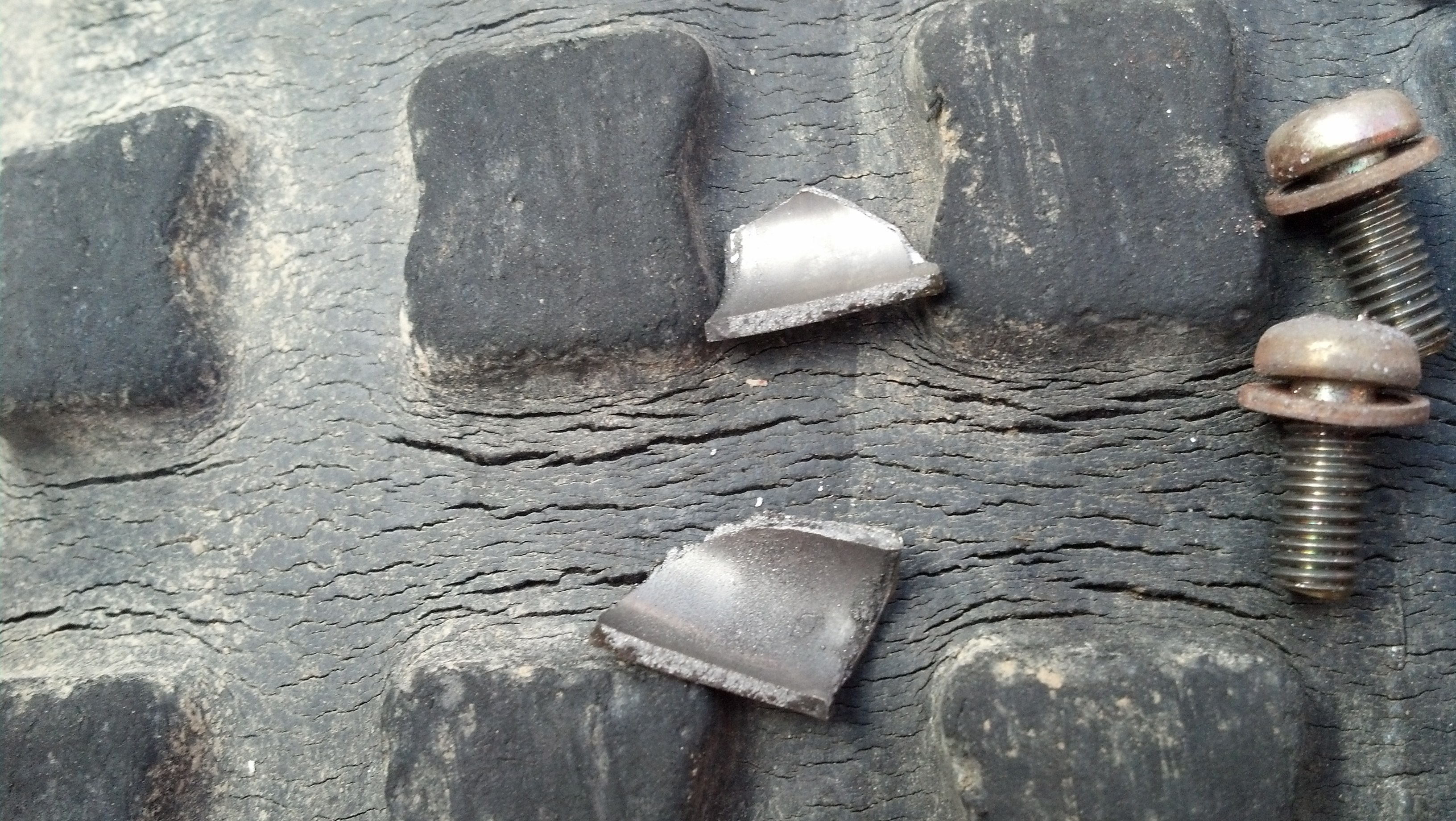

After replacing the worn carburetor with a new aftermarket one, I was still having trouble getting it to start. It seems it would either cough, load up the cylinder, or backfire with no real pattern to what it was doing. Working under the assumption that the new carburetor should at least get it running, I decided to start examining spark.

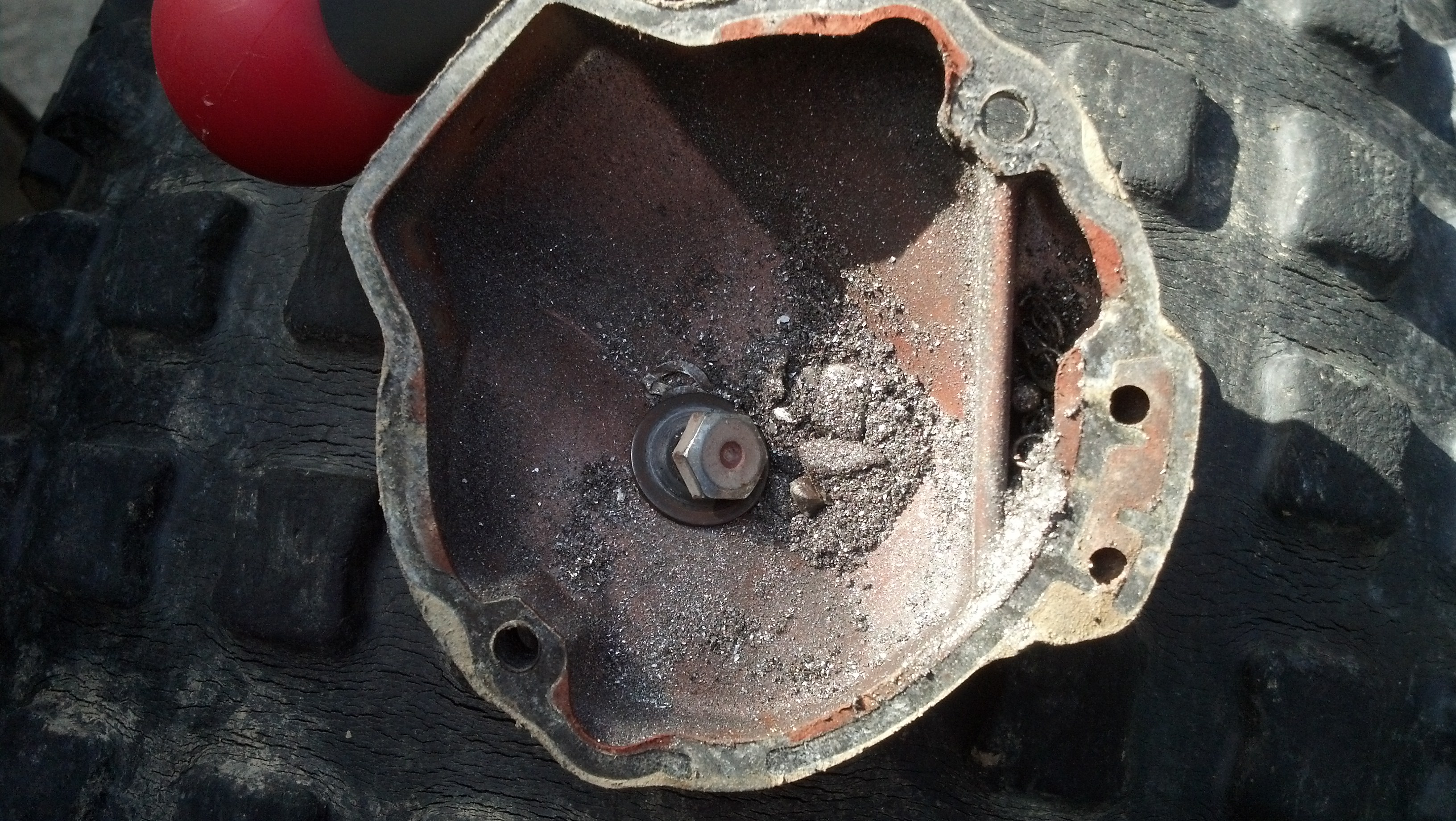

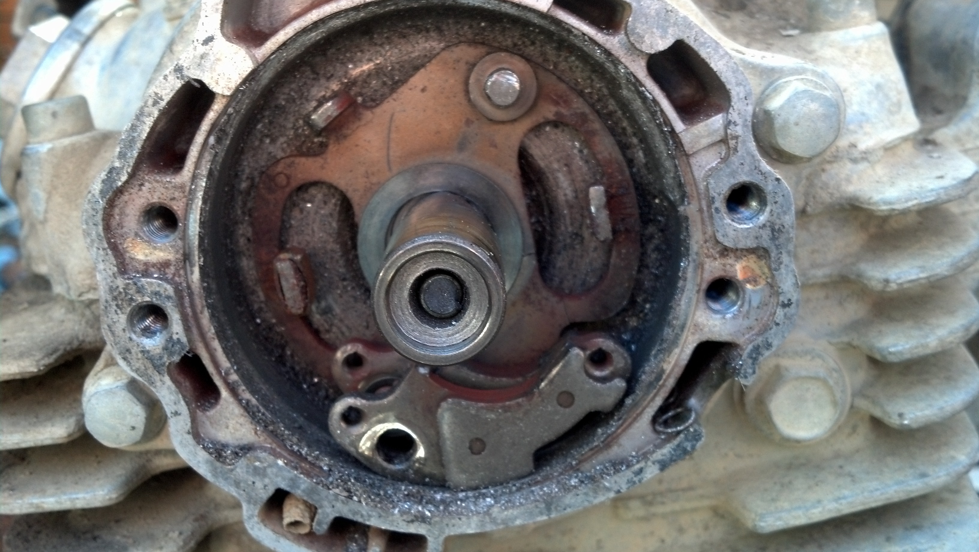

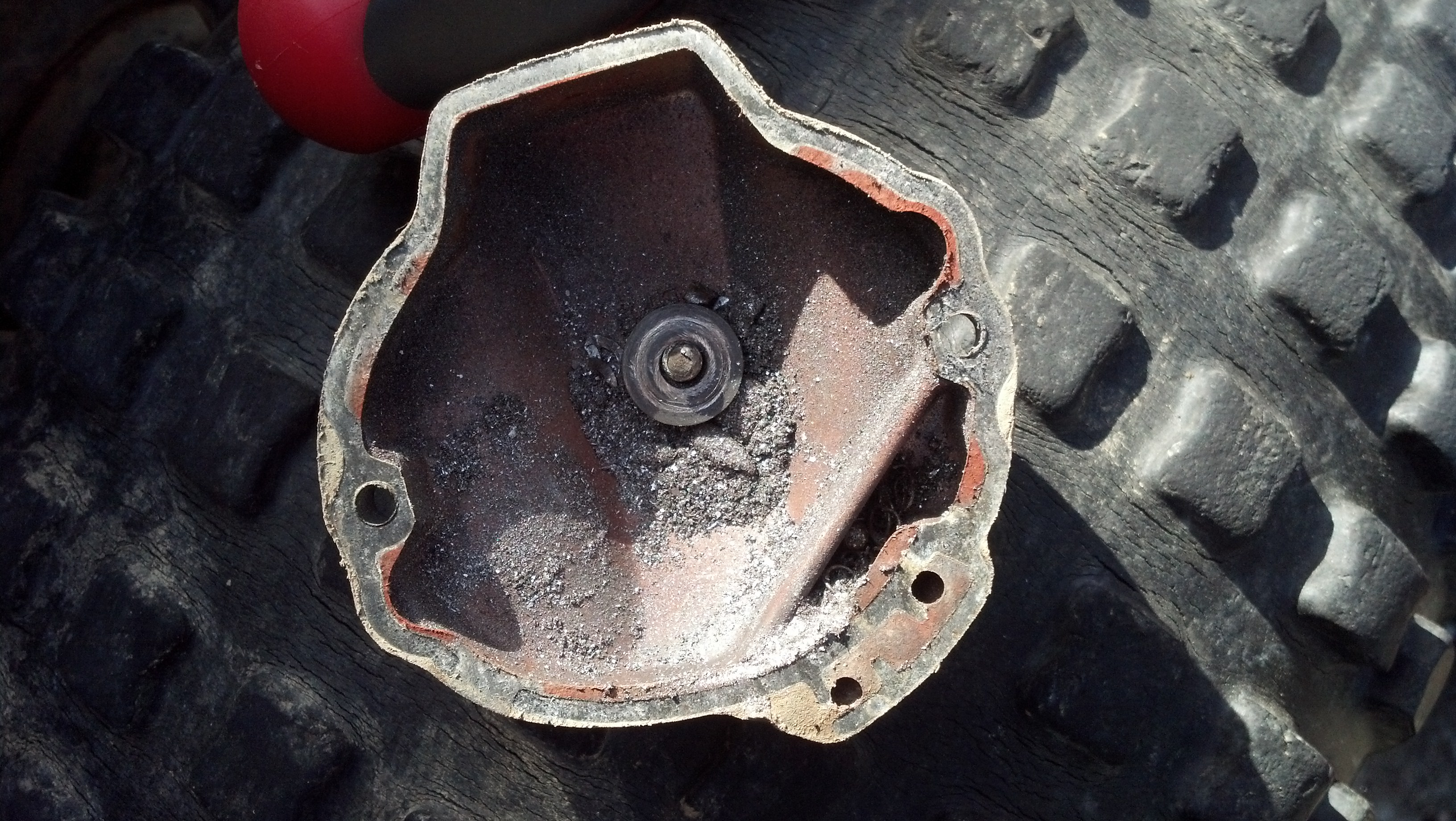

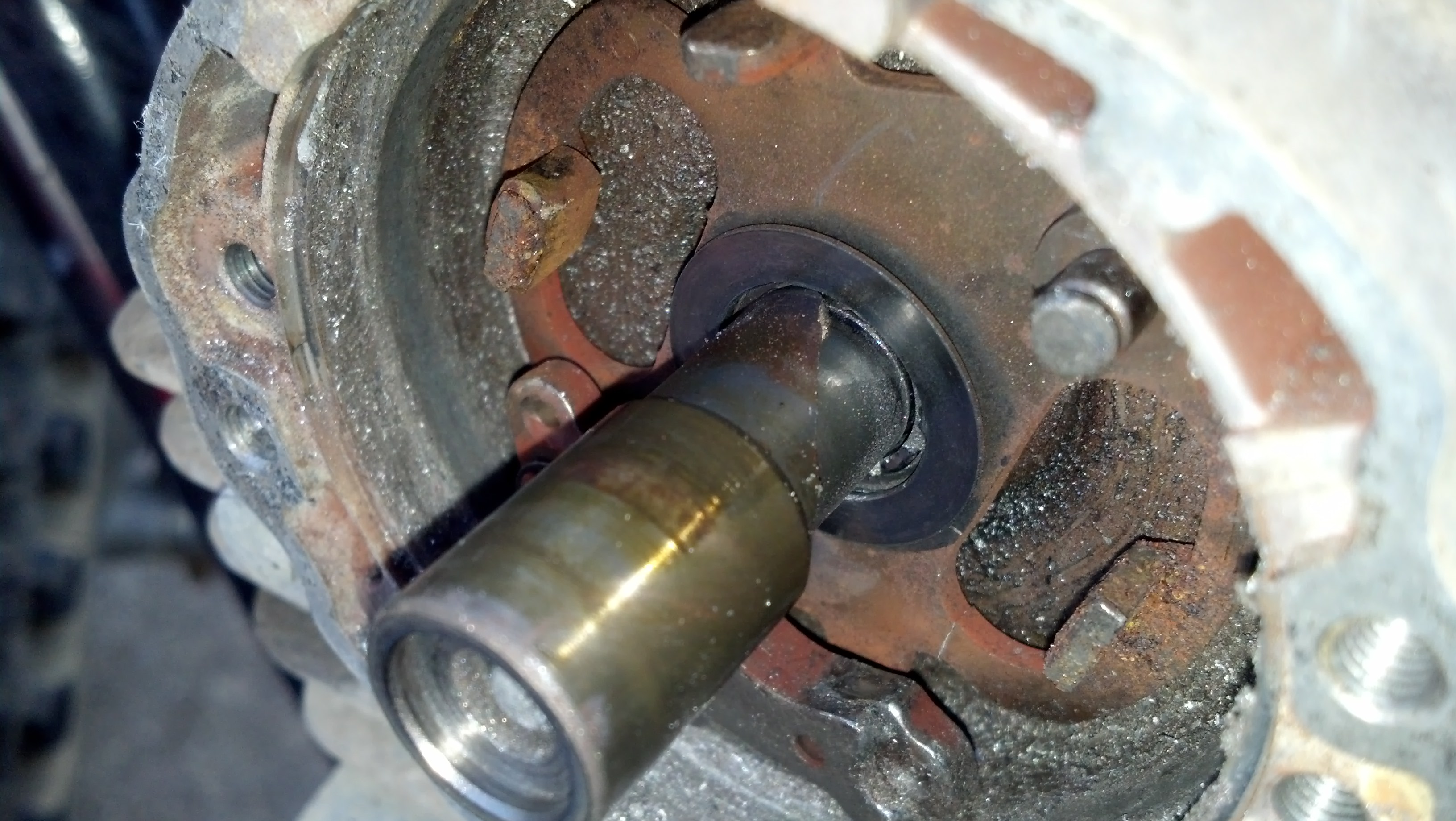

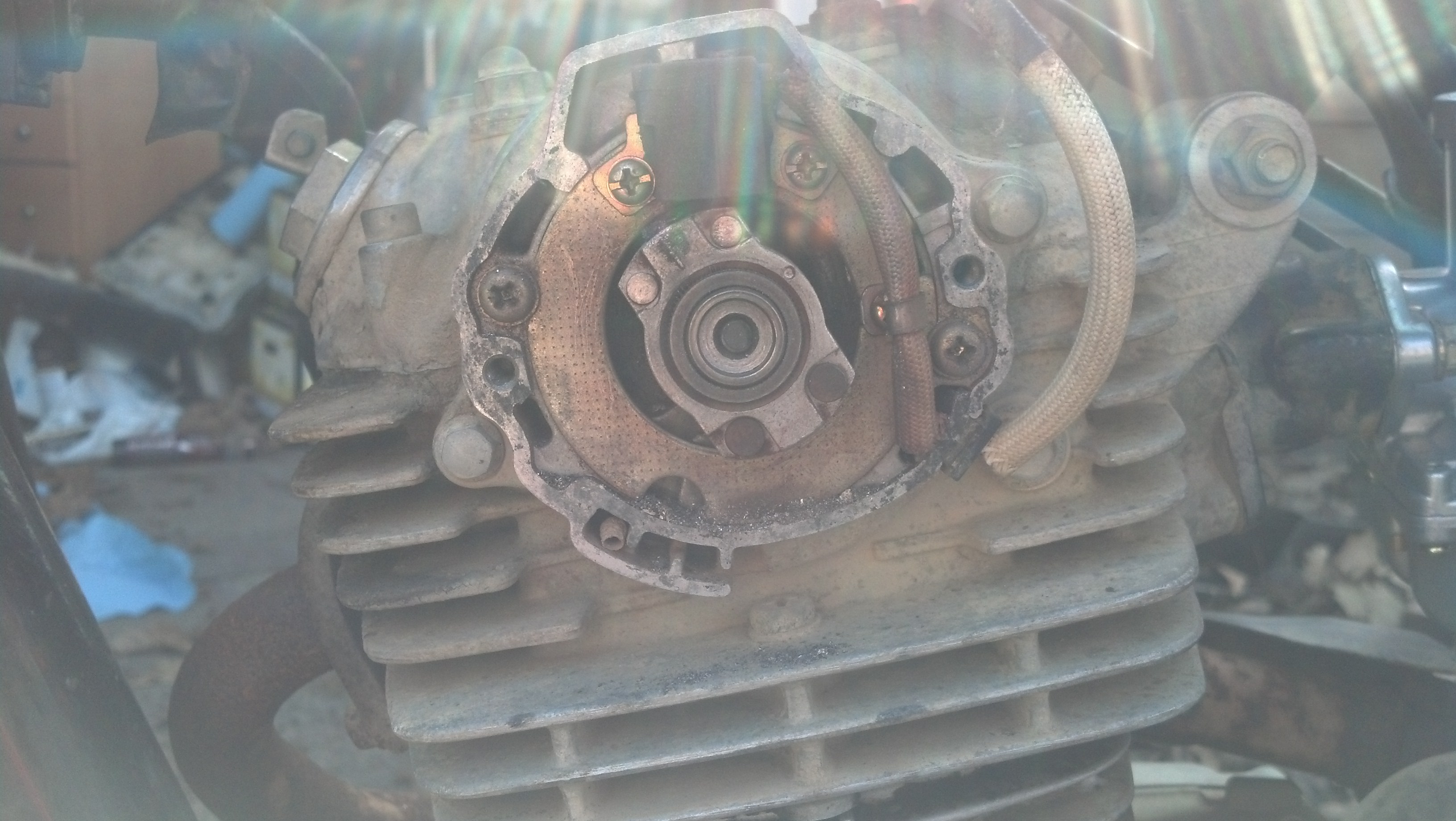

When I pulled the cover off of the pulse generator assembly, I found that at some point the head of the bolt holding the pulse rotor to the camshaft had sheered off and began rolling around inside the assembly. The damage it caused is quite extensive. It destroyed the spark advance module, caused the dowel pin in the camshaft to rip its way out of the camshaft, and other general problems. I have attached some pictures I took yesterday afternoon of the damage I found. Click image for larger version.
