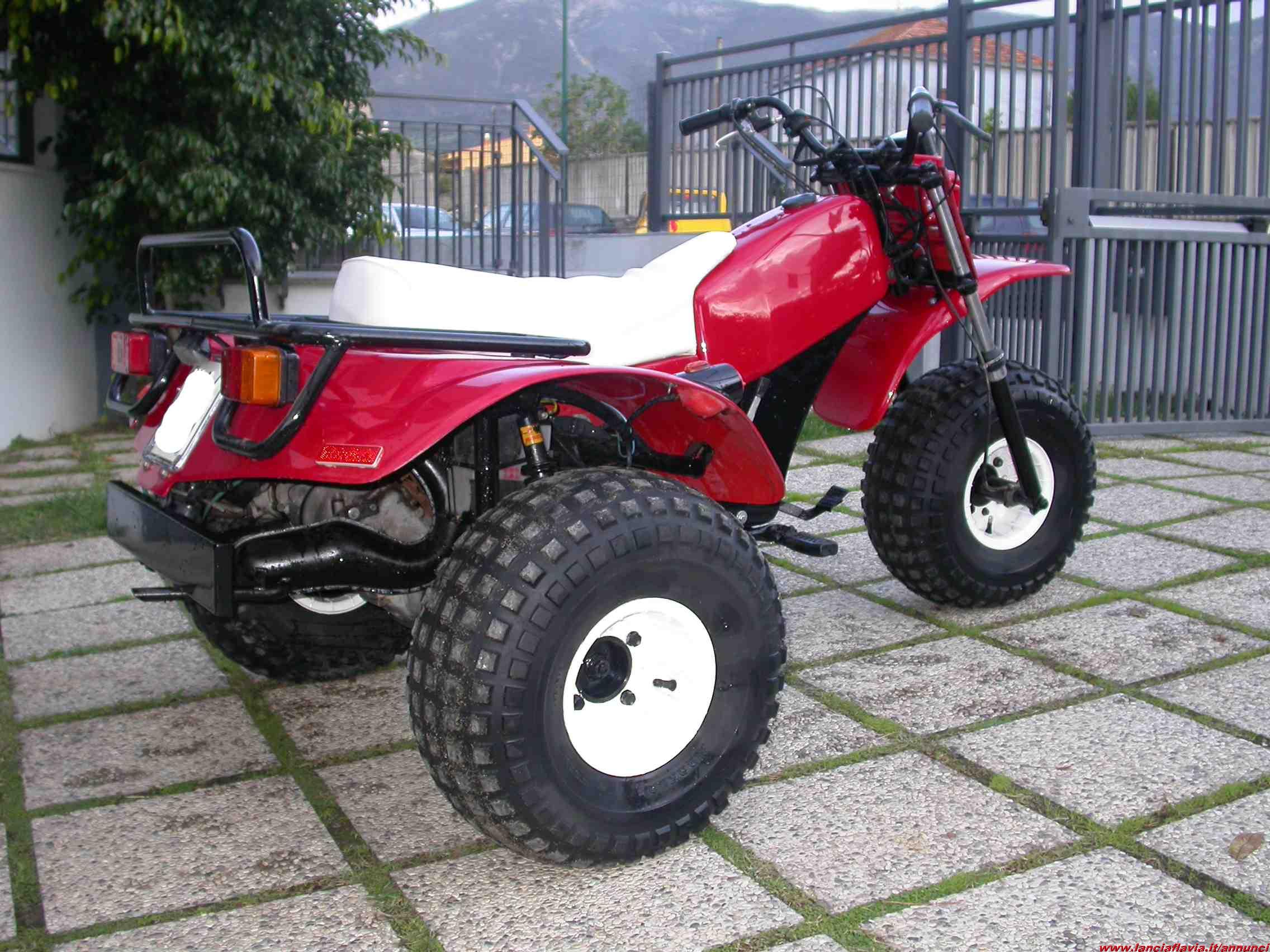

    http://www.lanciaflavia.it/public_ol...1241621299.jpg
    Bad angle but these came off the line with IRS. There are tons of IRS trikes overseas, so saying it won't work at all is really not an option here.
    If you want something, don't let people tell you you can't do it just because they think they can't.
