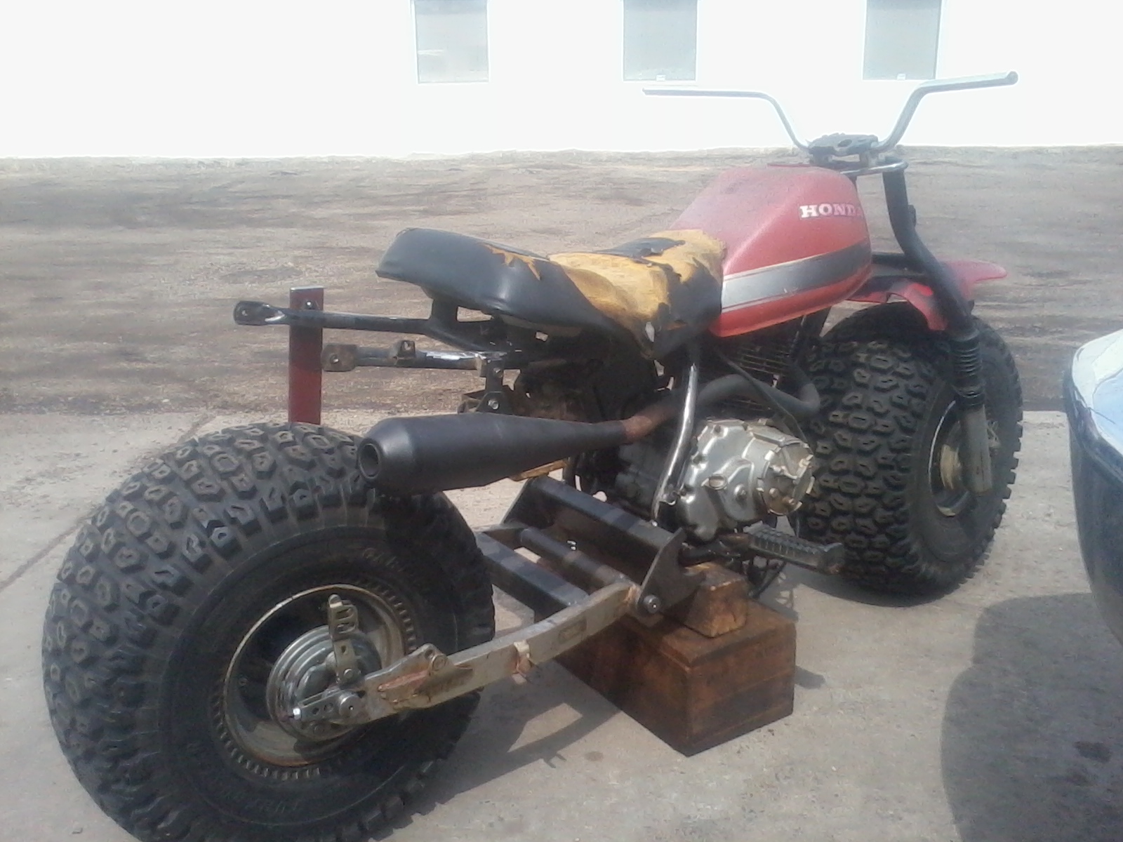

    I haven't gotten much done on the bike recently I cleaned the frame up a little and have done tinkering work with it and to it. I liked your rack you made for the back of your bike joefixit0. I had the rack for the back that i cut up and am welding it back together like you have yours. I have a question about shocks and how you guys think would be the best place to get some i need them to be around 18" extended and 14" bottomed out max to make it work with my bike. check out my photos in the album on my page about my build.(Album name "Fat Ass")

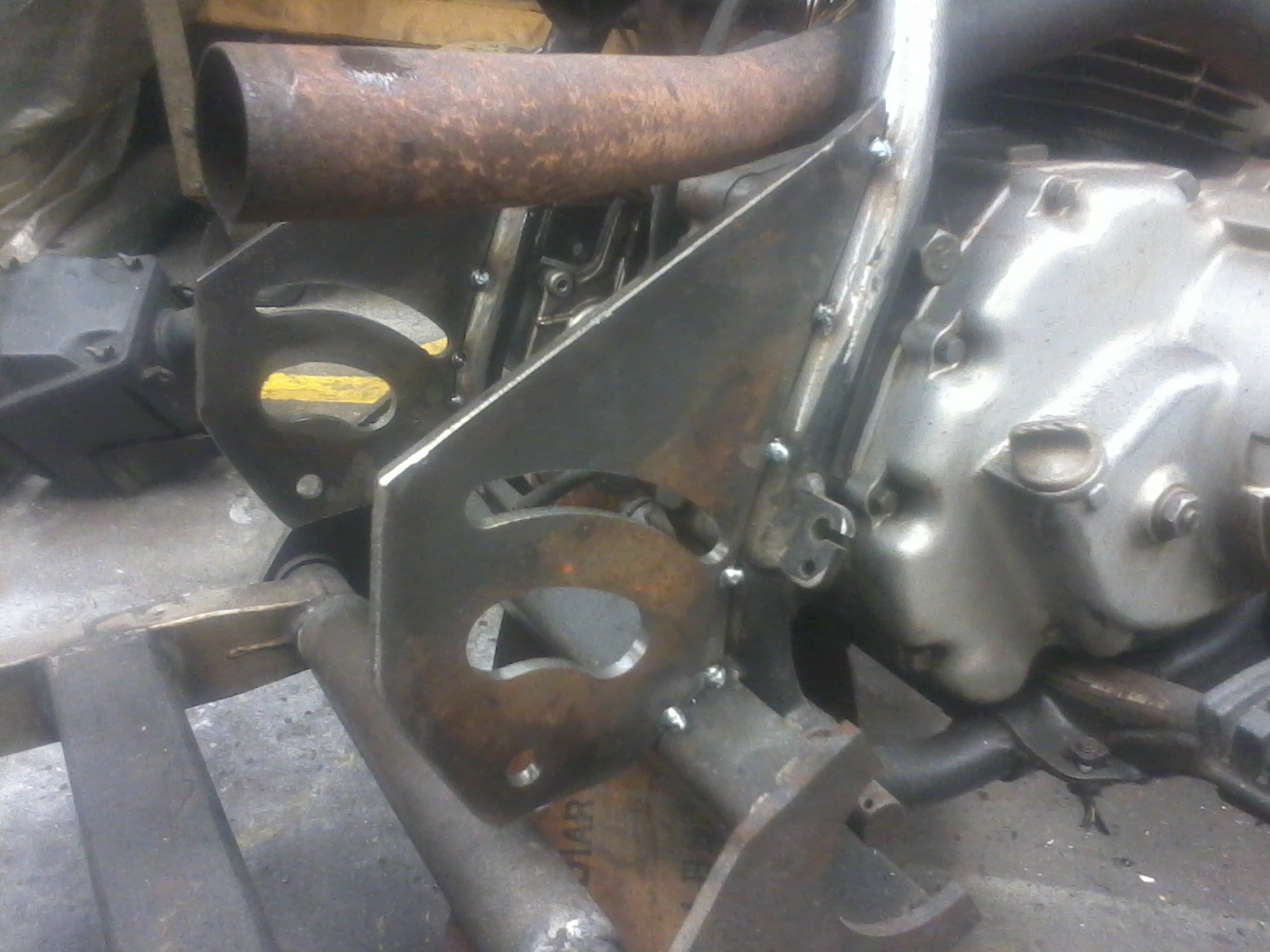

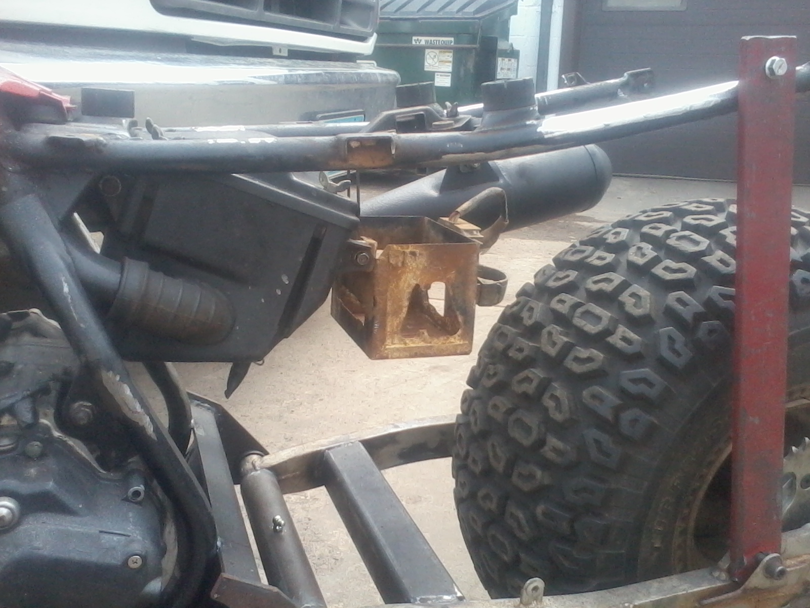

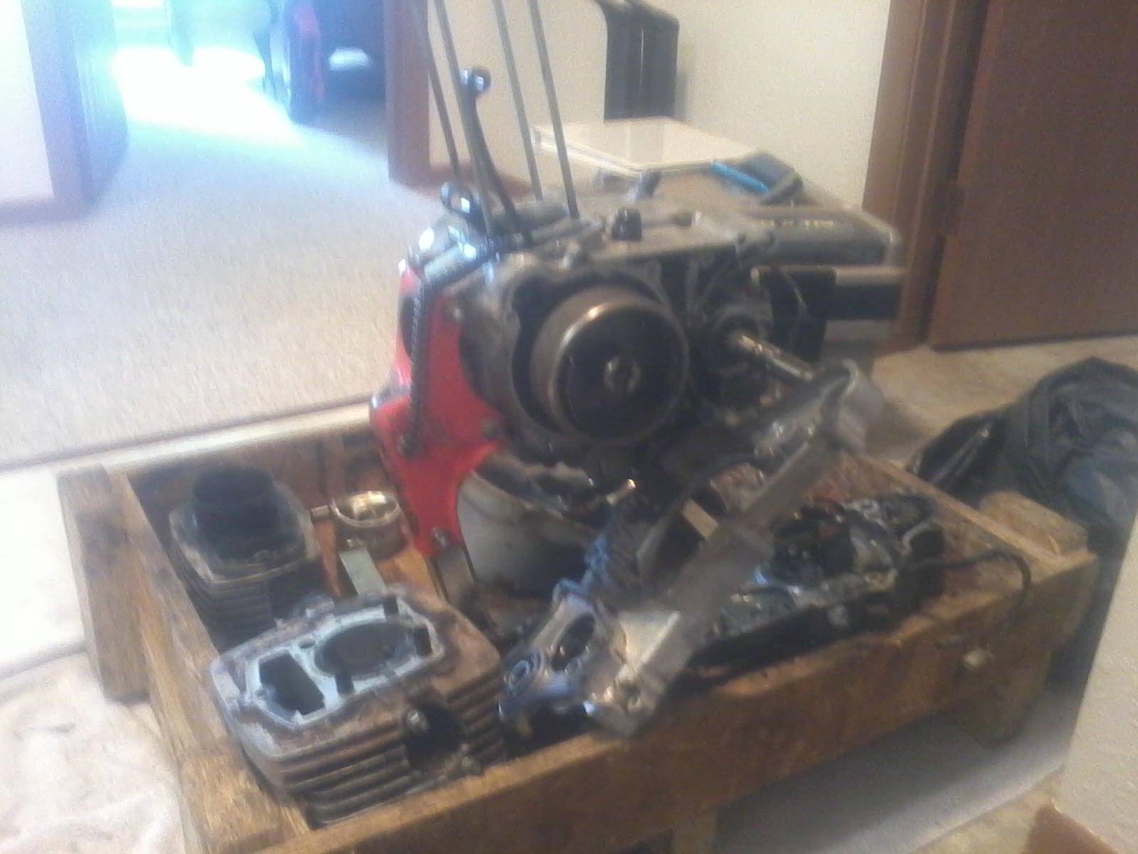

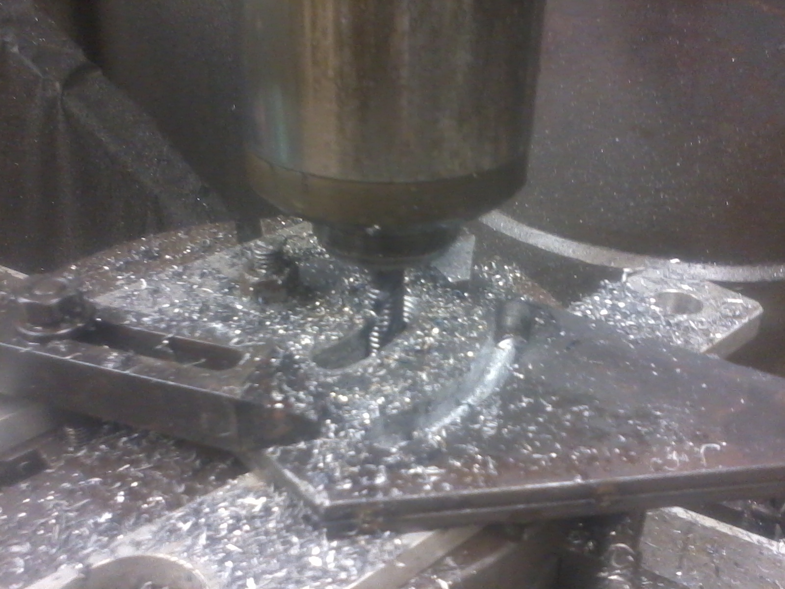

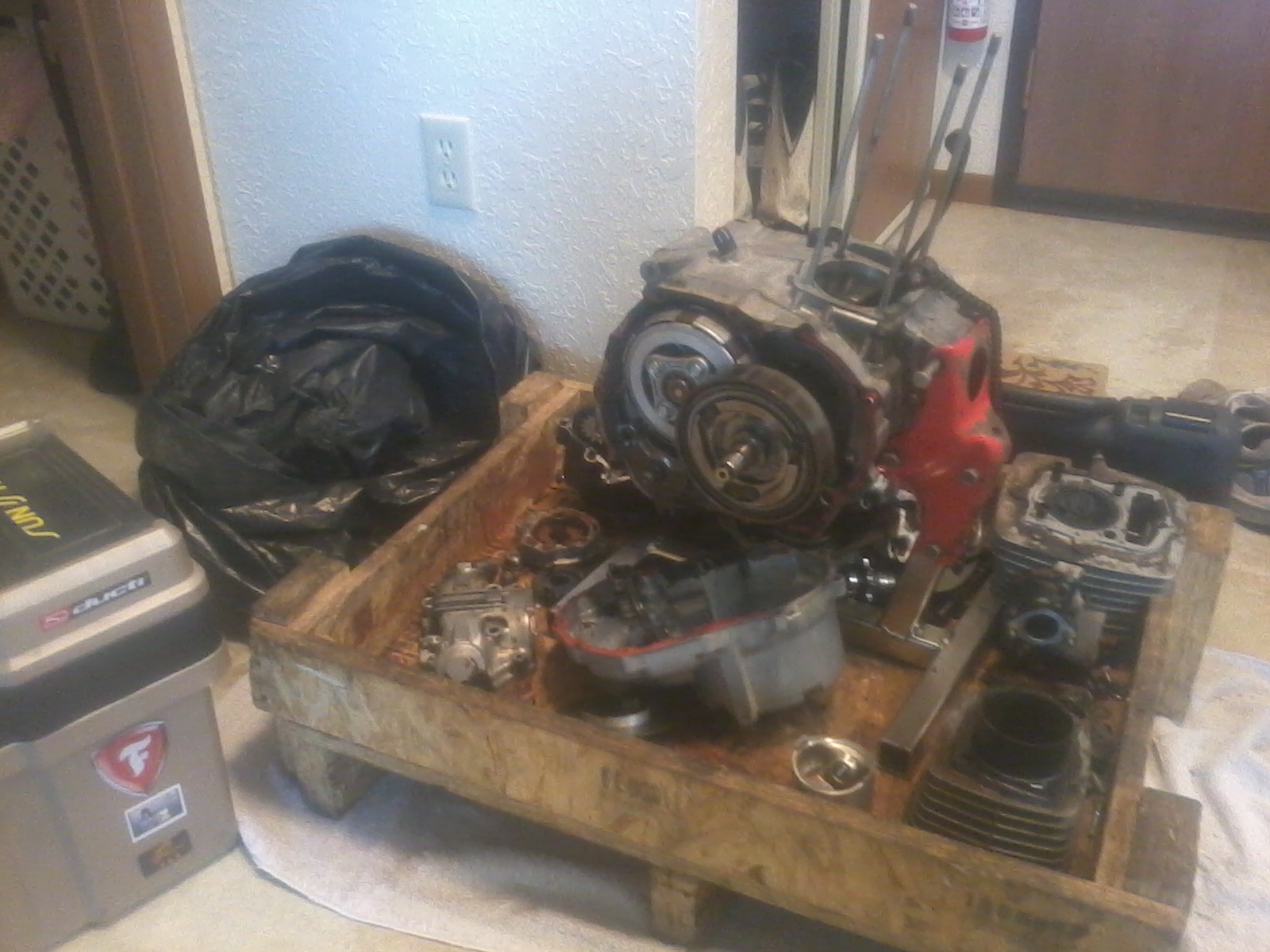

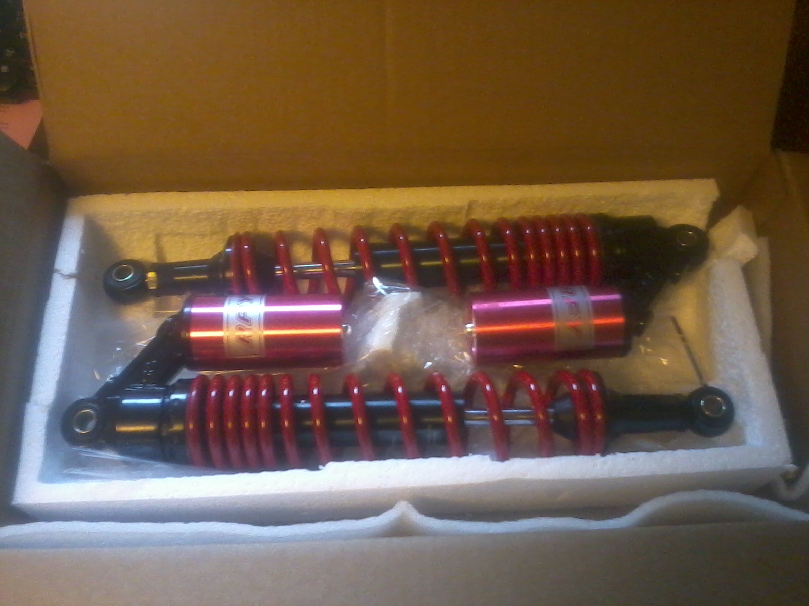

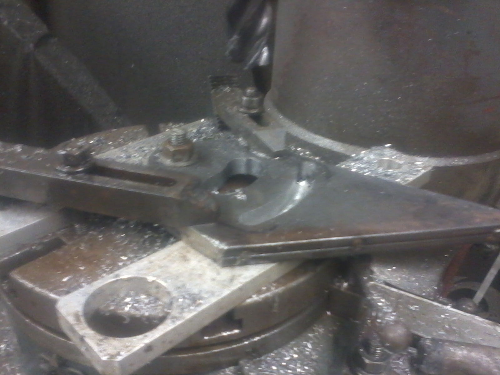

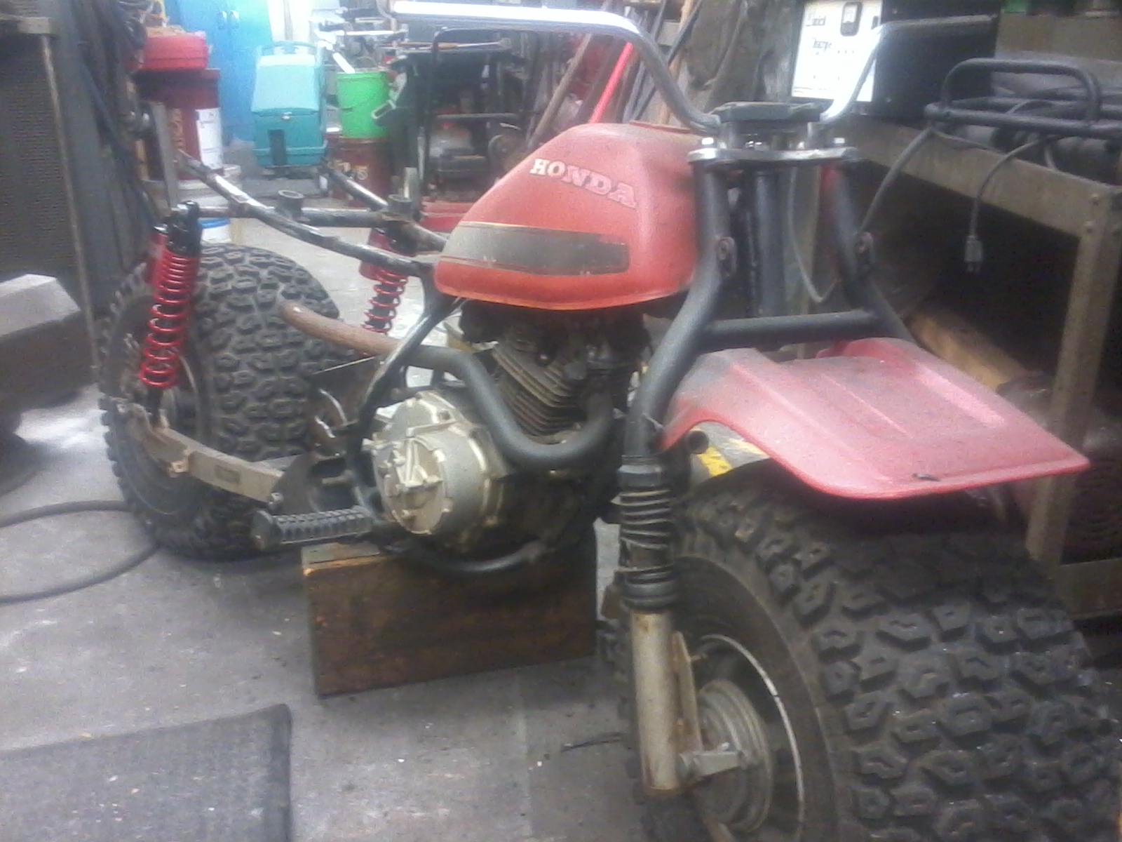

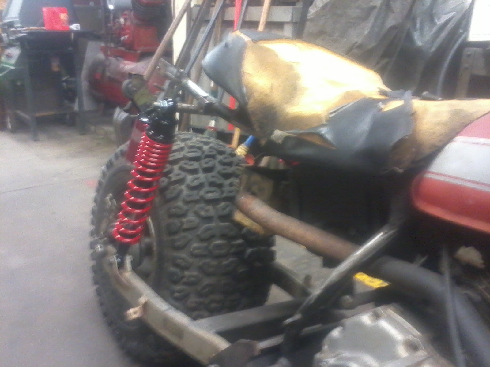

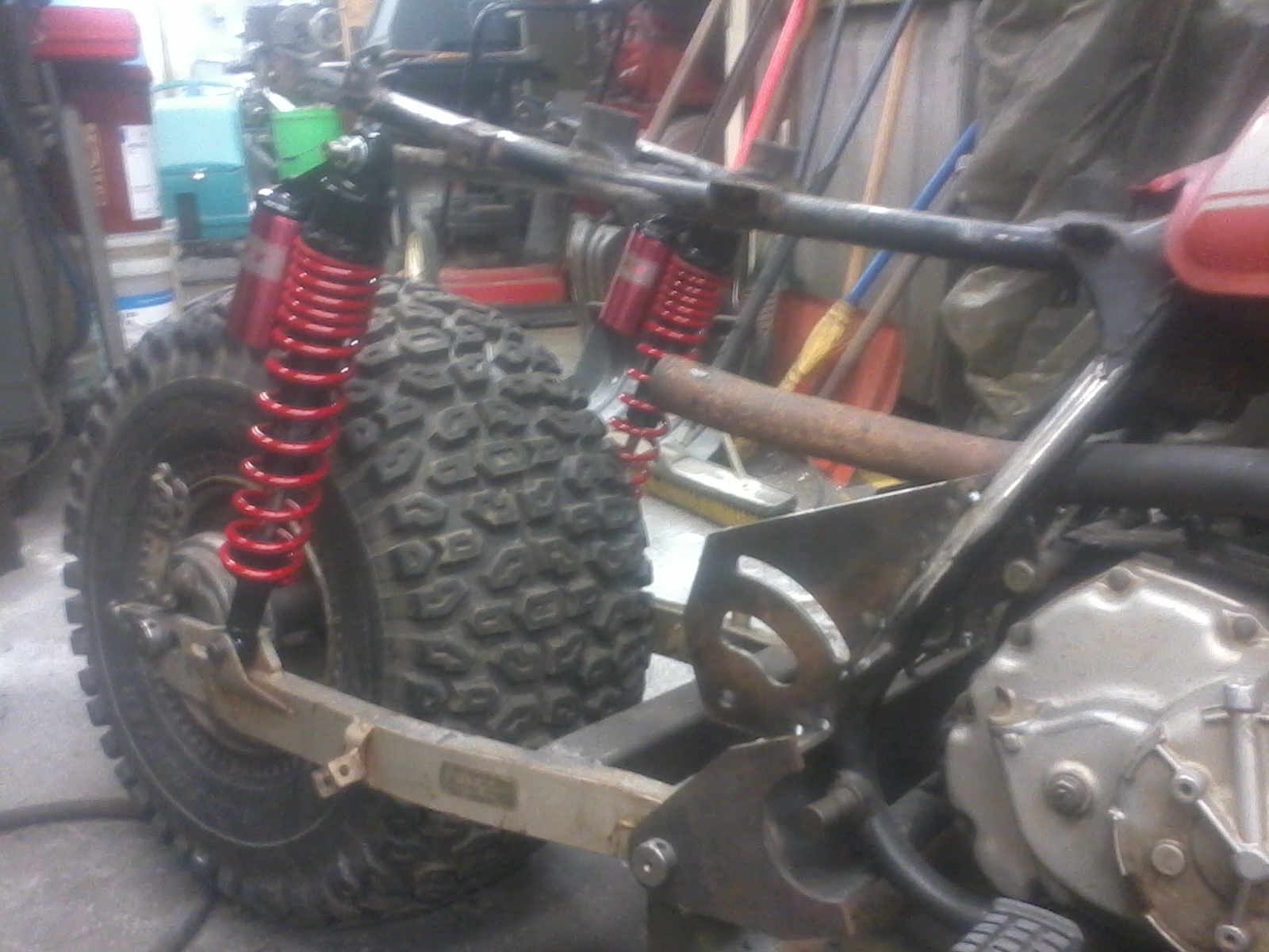

    So its been some time but i am posting again. I have been working on the bike seance my last post but not much. I have rear shocks now but i am not happy with how i have them mounted but that wont be hard to fix(I just want to make the bar that connects the two shocks out of bigger rod to weak for my liking). I made the jack shaft mounts and they turned out great but they wont work so i have to remake them(I make the pillow blocks mount to low the sockets wouldn't clear the frame) But you learn as you go. its been frustrating to have struck out every time that ive touched it recently but i can get it all straitened out and fixed. So i pulled the engine out to give it just a good look over and slight overhaul so it lasts forever like a good ole honda. I have it all tore apart just have to clean it all up and put it back together and bolt er in and hook er up to run so i can test drive it when i am ready.Click image for larger version.
