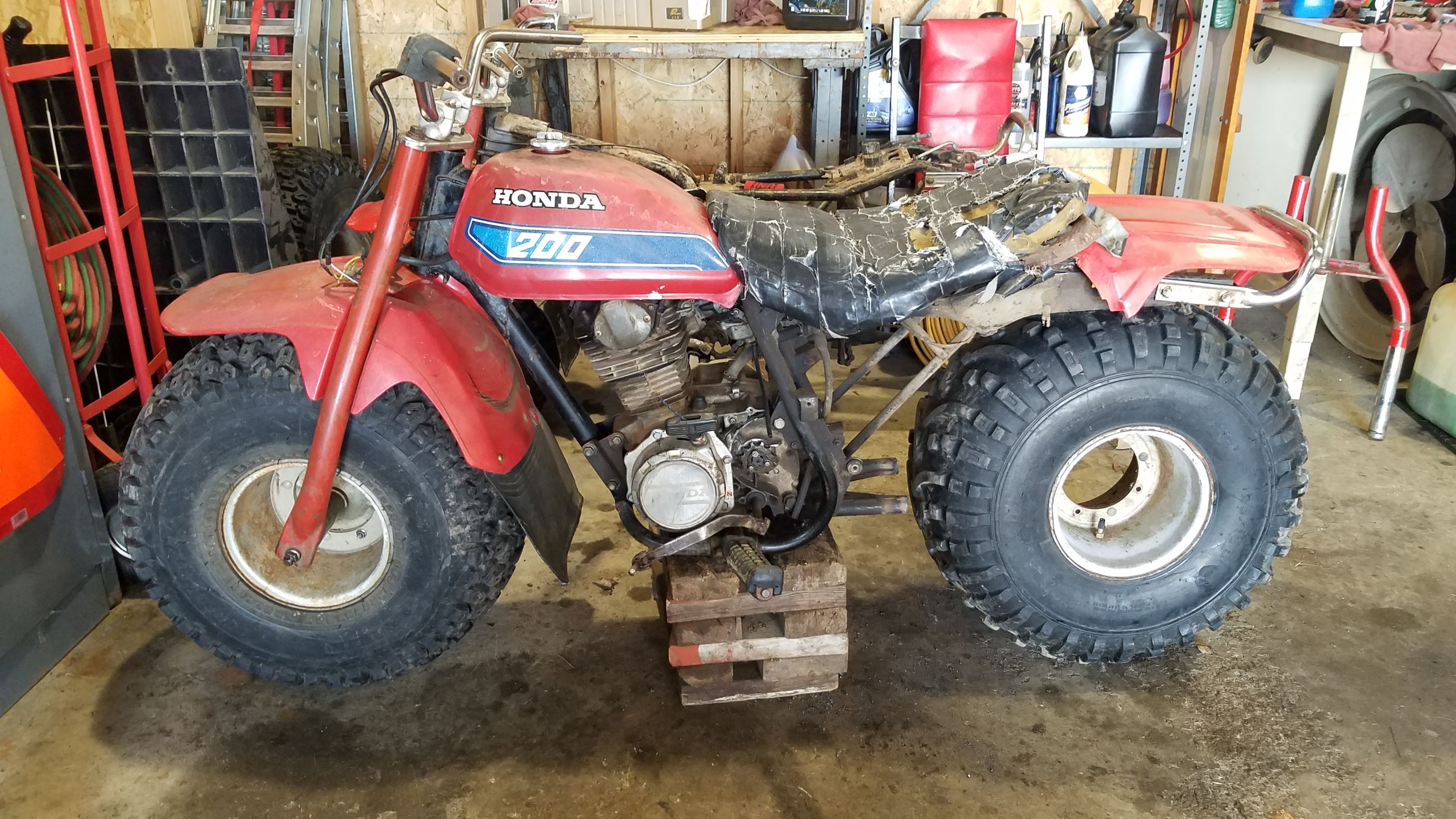

    After a weekend of testing I have learned a couple things. first it is way heavy to be lifting out when you are stuck. Possibly adding a small electric winch to the front for self recovery.(I end up riding alone in the deep woods a fair amount). I will also probably remake the rear axle assembly to make it lighter. The next biggest thing i will do is a kick stand. I thought it would not be bad to just lean against a tree but more often than not there is nothing there when you need it. I have a kick stand off an old honda 750. It rides quite well figuring what it is. runs down gravel nice through fields and soft ground nice. Mud is a hard place but it is for dirt bikes too which thats basically what this is just fat tires. soft ground is best very low ground pressure. being that it was a 1982 200e the electric start is really nice to have along with the high and low range transmission. High is great down the dirt roads and low is really nice for hilly of road and crawling through the woods.

    After a few years for testing it is time to fix the front lift. The factory forks for an 82 200e do not have very good suspension. With how high the back was lifted to add shocks I need to lift the front 4 inches. I built some temporary lift blocks and they fix the look and level the bike out. What is the best way to ether lift the factory 82 forks or upgrade to newer forks off a 250es? I could make my own triple tree and use proper dirt bike forks but that is a ton of work to keep my 25x12x9 tires.

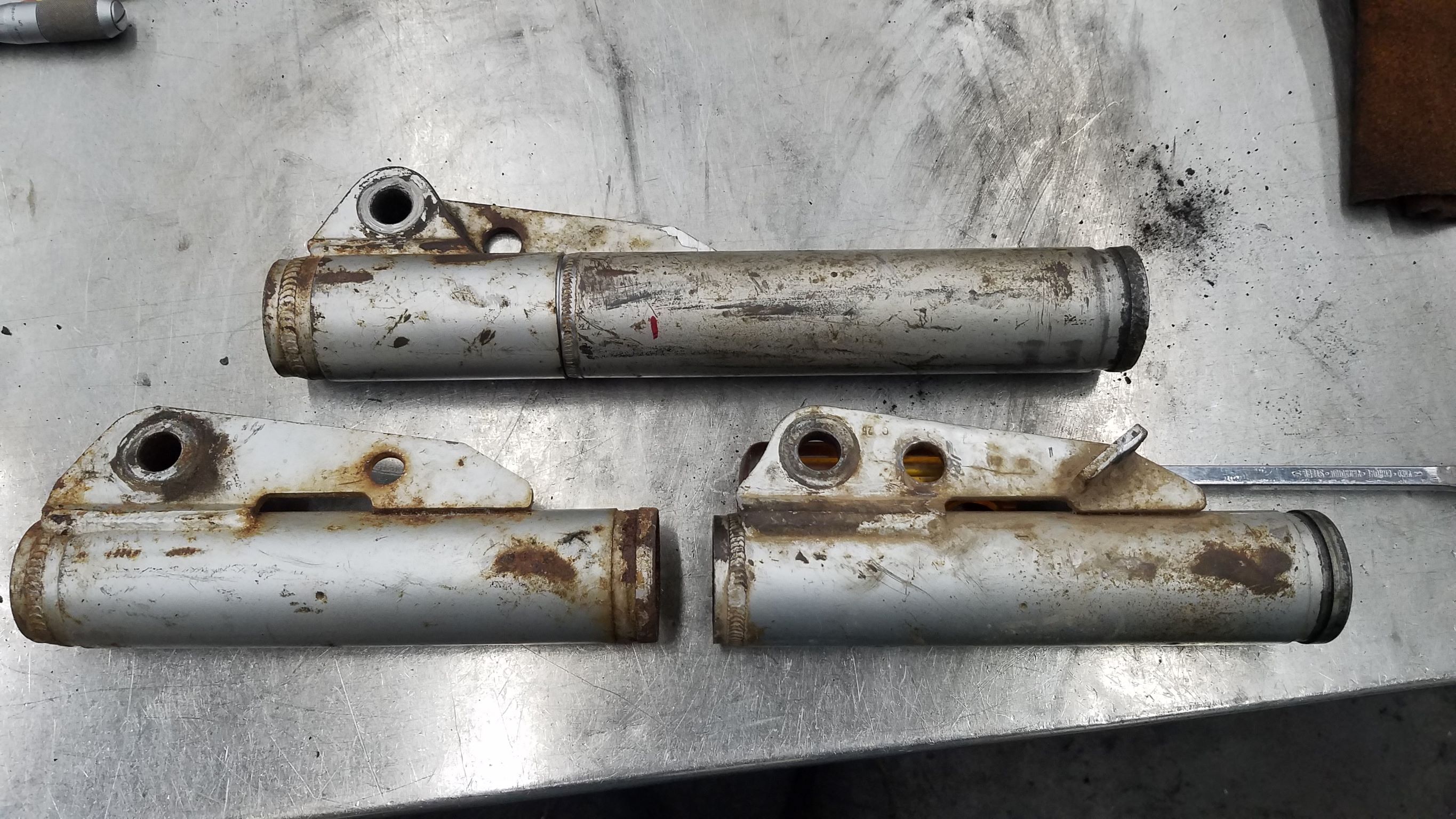

    I finished up my 4 inch lift for the front. I took a parts fork for an 83 or 84 big red and cut the lower tubes and welded them on to my original lower fork tubes. Doing it like this gives me 4 inches of factory appearance lift. It also lets me run the newer style aluminum brake housing. It also allowed me to continue to use the ski mount I made that uses the old style brake holes in the front fork.
