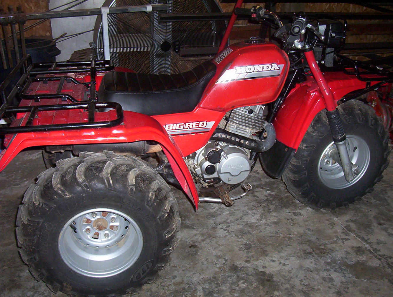

    I've had good luck with rear rims all the way around from an 05 trx 400, they're 11x7.5. The front needs a slight 1/8 inch shim to center it perfectly.
Name:	big red 250 001.jpg

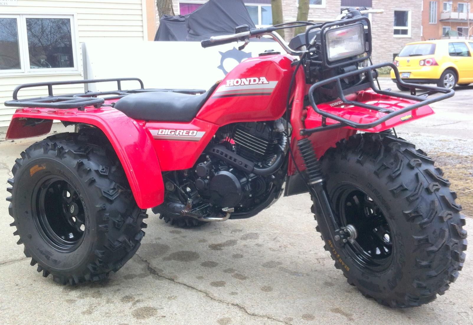

    I have a fair bit of experience at this as I have had a great deal of fun experimenting with tire/rim combos for the ES and SX machines..
    The rim you are looking for is off the shelf, cheap and don't need to be shimmed to get the front offset right. The ITP Steel 12x7, 2+5, 4/110 rim is a direct fit for the Big Red..it can be found at many retailers for about $35/rim
    http://www.amazon.com/ITP-Delta-Stee.../dp/B002OKHNMC
    Then you can experiement with a multitude of different 12" tires..I like the 26x12x12 for rear and the 26x8x12 for front. BTW, when you install the front tire, if it has a directional tread be sure to mount it on the rim as a right side tire to get the tread direction correct for the front.
    Here are a few of the machines I've done this with..have fun!!
