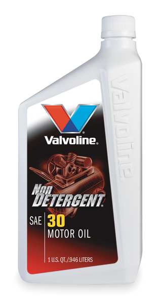

    This is incorrect, please post a link to where you got this information. They do need detergents. The oil Honda recommends has detergent in it. If an oil has no detergent it will typically, if not always, say so on the bottle and typically be rated SA or SB. See links for non detergent oil at the bottom of post.

    Here’s just a few non detergent labeled oils.
    http://www.summitracing.com/parts/cb...FQIT7AodJhoAuA
    http://www.foodservicedirect.com/pro...30-1-Quart.htm
    http://www.walmart.com/ip/ACCEL-Non-...-1-qt/17134765
    http://www.smittysinc.net/images/pro...view/sus41.jpg
