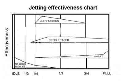

    Here is a jetting chart I use to refer to when jetting my bikes, it works well.

    Here is a url of a better pic of it.
    http://www.3wheelerworld.com/attachm...7&d=1384563055
