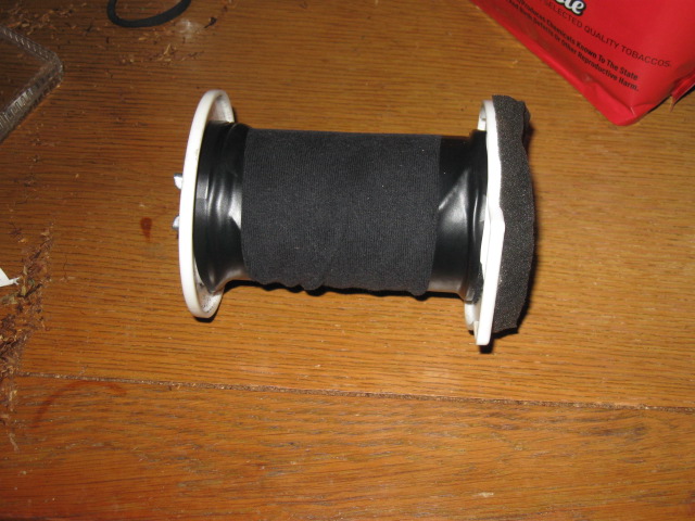

    well no one had an air filter locally.... so i ordered the moose racing one off ebay, it wont be here for a few days.... so using a bit of afro-engineering i put this together till my real one gets here....lol, i cut a piece of a t-shirt and am gonna spray it with a little k&n oil
    Hello kawaboy;
    That is certainly innovative, lol, however, I don't exactly know how to say this without sounding like some panty hose pervert or something, but in all seriousness [as if this can be taken seriously], you might find that the T shirt does not allow very much air through in which case it would cause your engine to run rich and reduce power.
    I suppose I am suggesting that you put whatever material you want to make it out of up to your mouth and try to inhale and exhale through it. If it is difficult then you might want to try something a bit more "sheer" shall we say, which might also slip over it without a seam and which could also simply be tied in a knot on the end to seal it if need be. And with that, I think I have already said more than enough.

    Quote Originally Posted by kawaboy-zx12r View Post
    so using a bit of afro-engineeringAttachment 192498
    I'm not familiar with this type of engineering. Can you explain what you mean by that?
    Looks to me like hack work and no patience so I guess I'm confused.
    Hopefully the rhetorical nature of this post is apparent, because I've nothing else to say about it.
    May 2014
    Portage, IN
    58
    yeah, pretty much thats what it is... a hack job, but anyway Barnett, you are correct, the shirt with the k&n oil is too thick and making it run much too rich, any thing over 1/4 throttle it bogs out and cuts in and out. its true, i dont have much patience.... i just got it yesterday and i am doing what ever it takes to ride it NOW, new toys rock!
