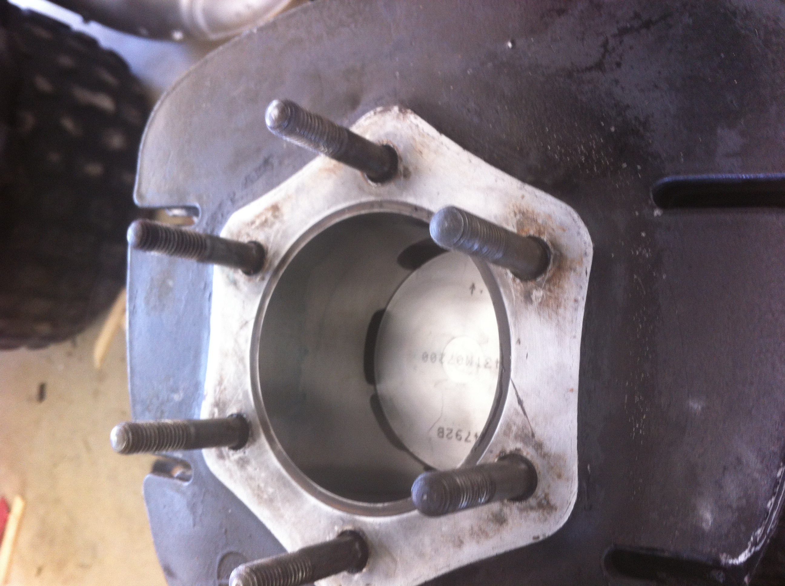

    Some Pics of Cylinder Head, and Jug. They got cleaned better before install

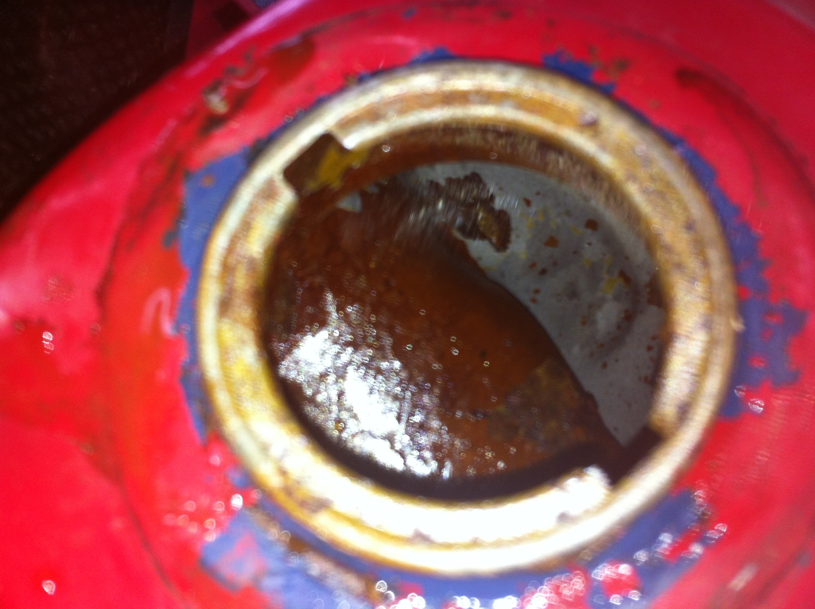

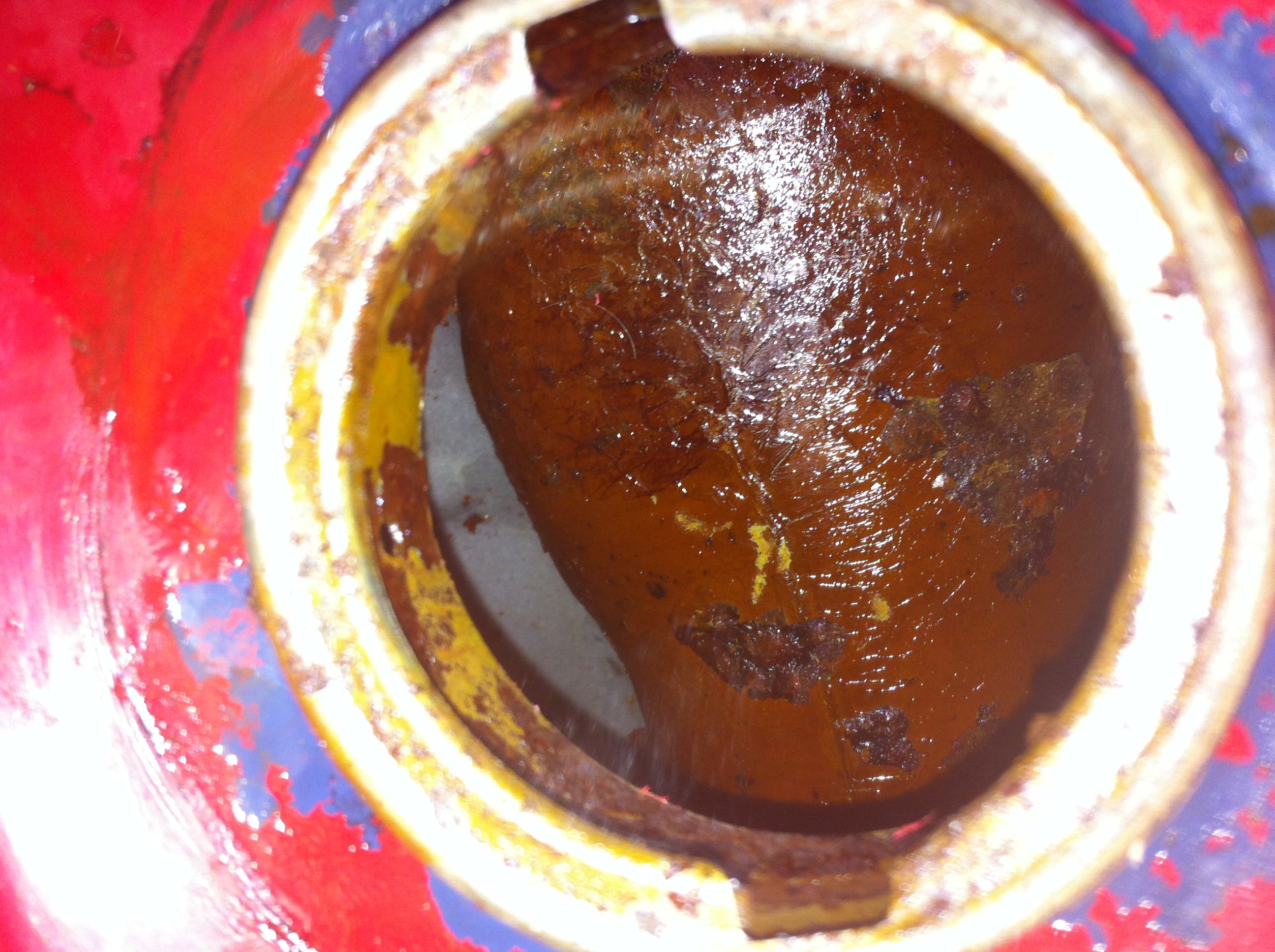

    Pics of Rusty Gas tank before and after Apple Cider Vinegar soak for a Day then Power Washed then Repeated a second Time. Worked really good. But if u hav the original petcock on there might take it off and cap if off with a nut , bc it ate my oem petcock which was prolly trash anyway.

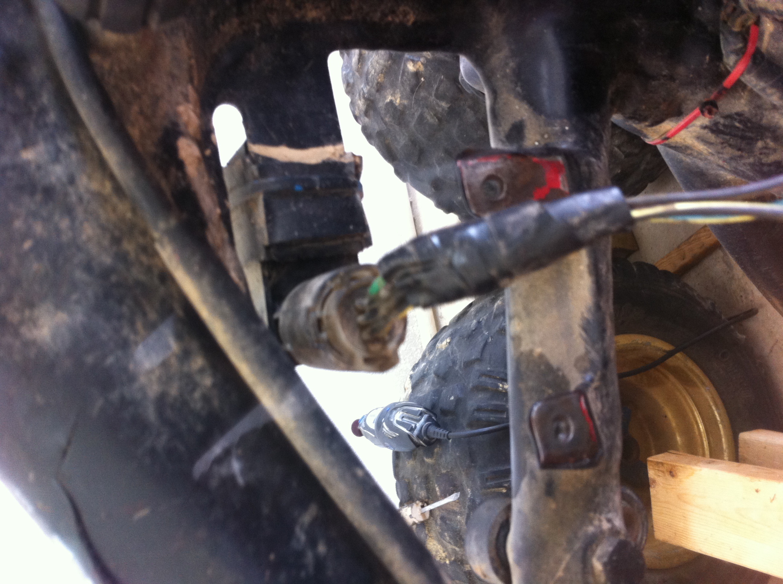

    Me tackling the wiring which was a mess and a splicing nightmare when I got it.

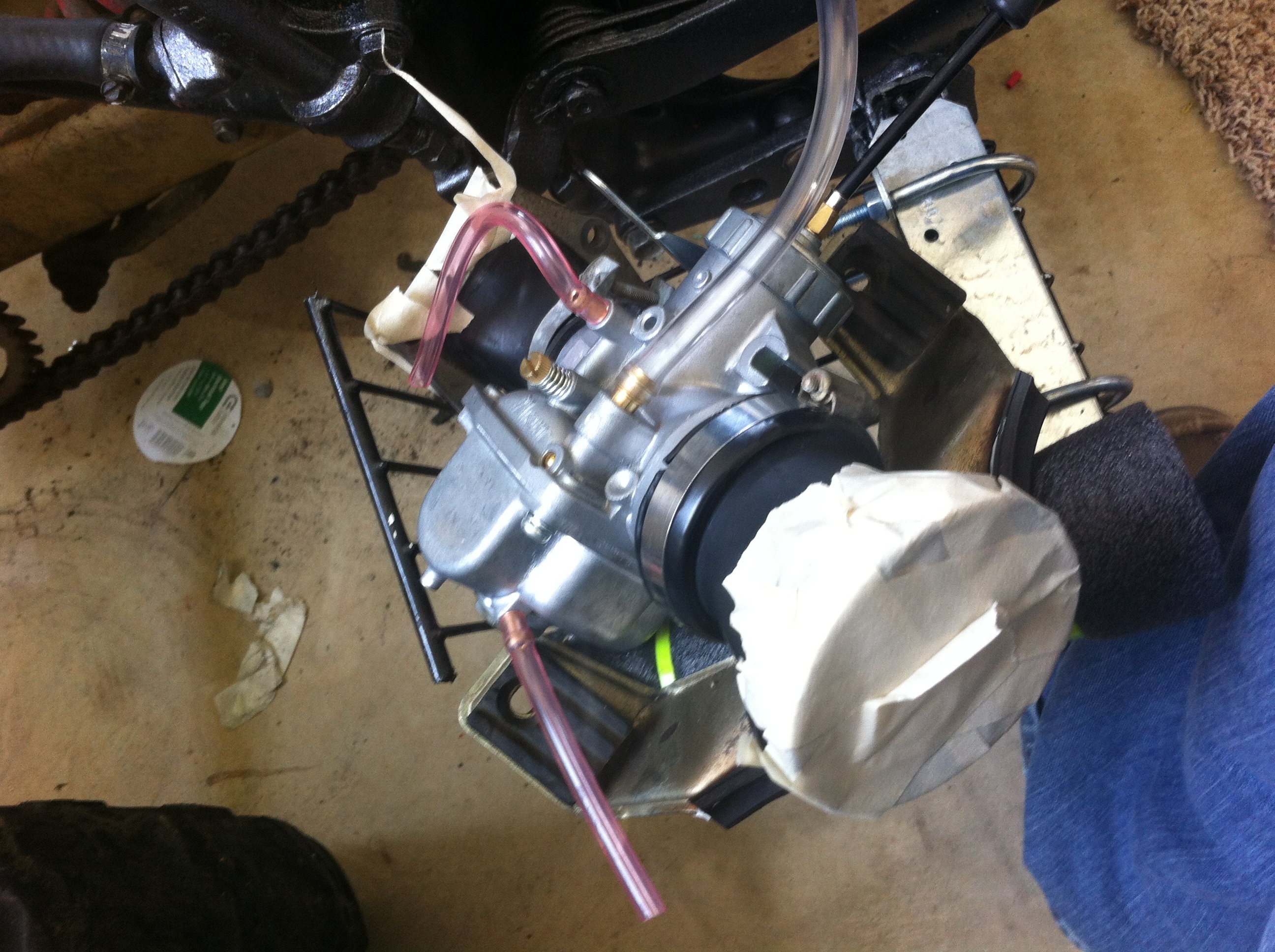

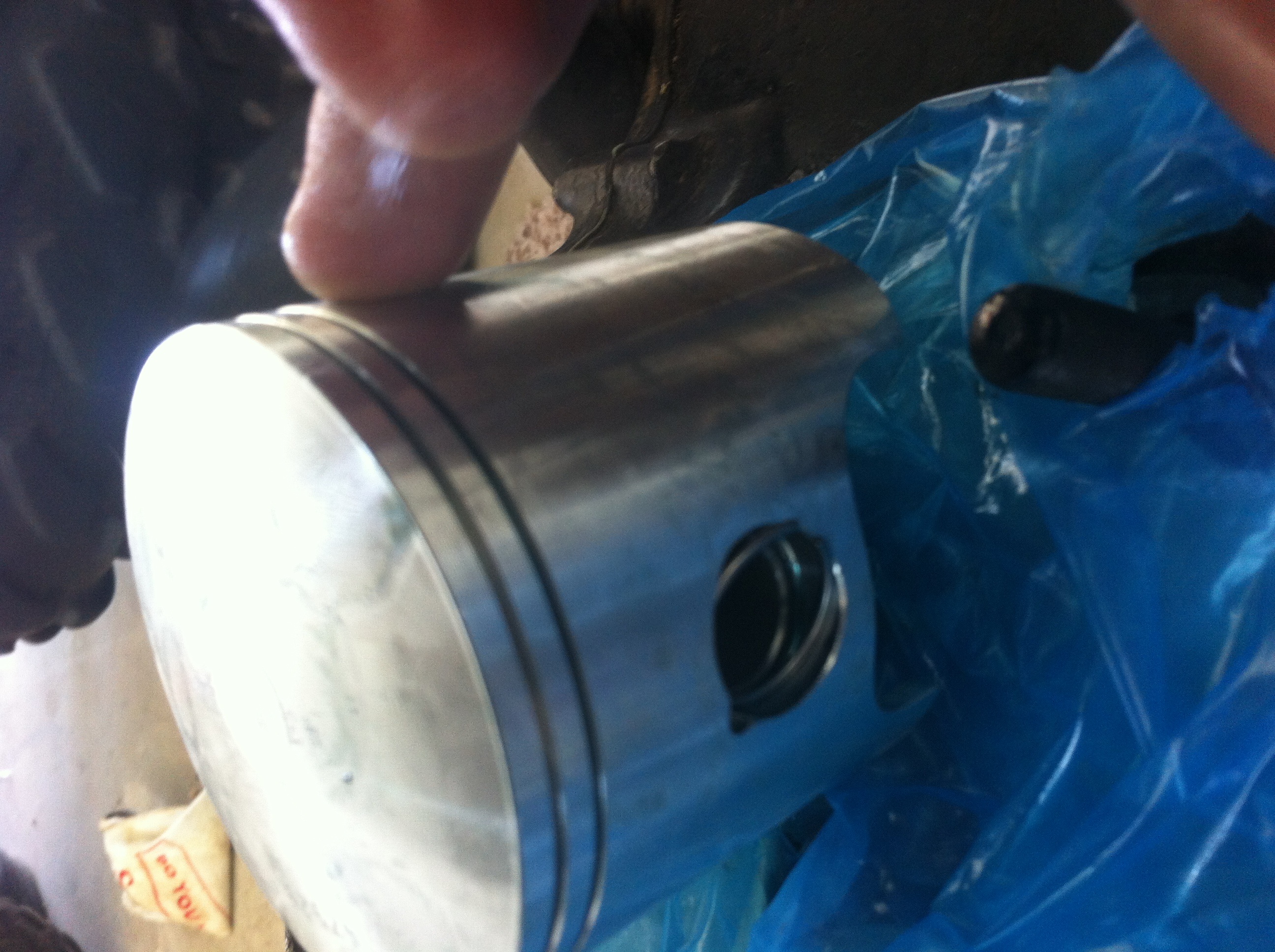

    Pics of Piston getting oiled up and jug installed, Me checking Spark Plug Gap, Getting Torque Wrench ready, and new 32mm Mikuni Round Slide Carb
    Petcock was a new one aftermarket off ebay. Sent me wrong size, then sent me right size but the outlet was one the wrong side so I hav a backwards petcock from now on as I didnt want my gas line to hav to loop around if it was facing normal.
    And there's some copper gasket spray I sprayed all the gaskets couple times and let them tack up.

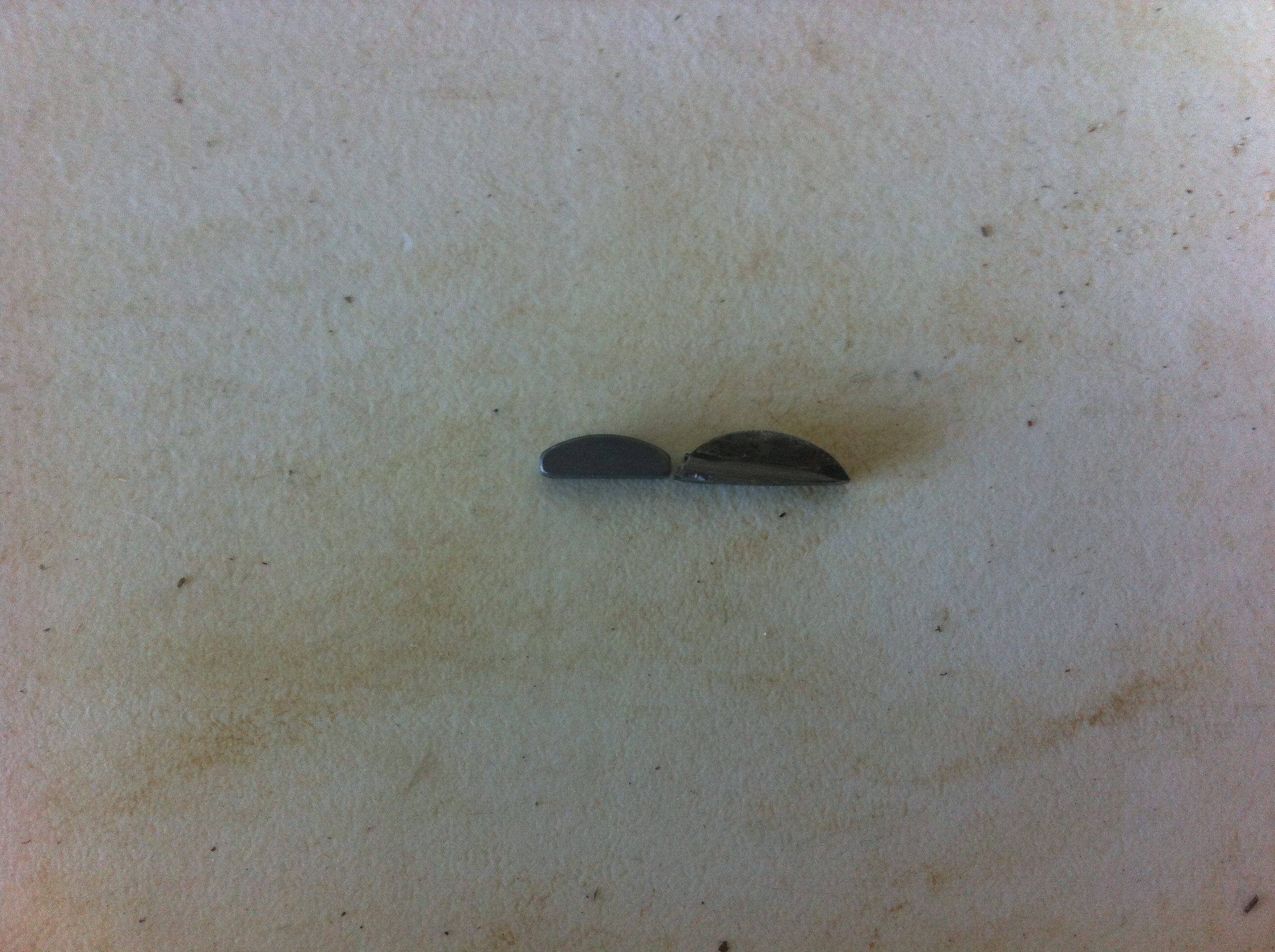

    I had no spark, had checked Ohms of stator and Ignition Coil decided to check stator out anyways, turned out someone had been in there before and couldn't get flywheel back on I guess so they beat the living hell out of it the threads for which a flywheel puller would go in were smashed square or flat so I couldn't remove with a traditional 2 stroke flywell puller so it took some patience and a steering wheel puller. Stator looked ok but went a head and replaced flywheel and made sure stator was lined up corectly with mark on engine case.Turned out the Woodruff key was a little bigger than OEM, my dad said oh just go to autozone there all universal. well that's what I think the last guy who had this did and its different size. same width diff height. I went to Honda and got OEM woodruff key for 1984 Honda 250r atc. and u can see the difference in the sizes. flywheel had no wobble and went right on with OEM woodruff key. and long story short bought oem Ignition coil and bypassed ON/OFF switch and Whala I have Spark. I should Have know that bc I remember when I picked it up the ON/OFf Key wasn't hooked up and the CDI wires wernt all connected.

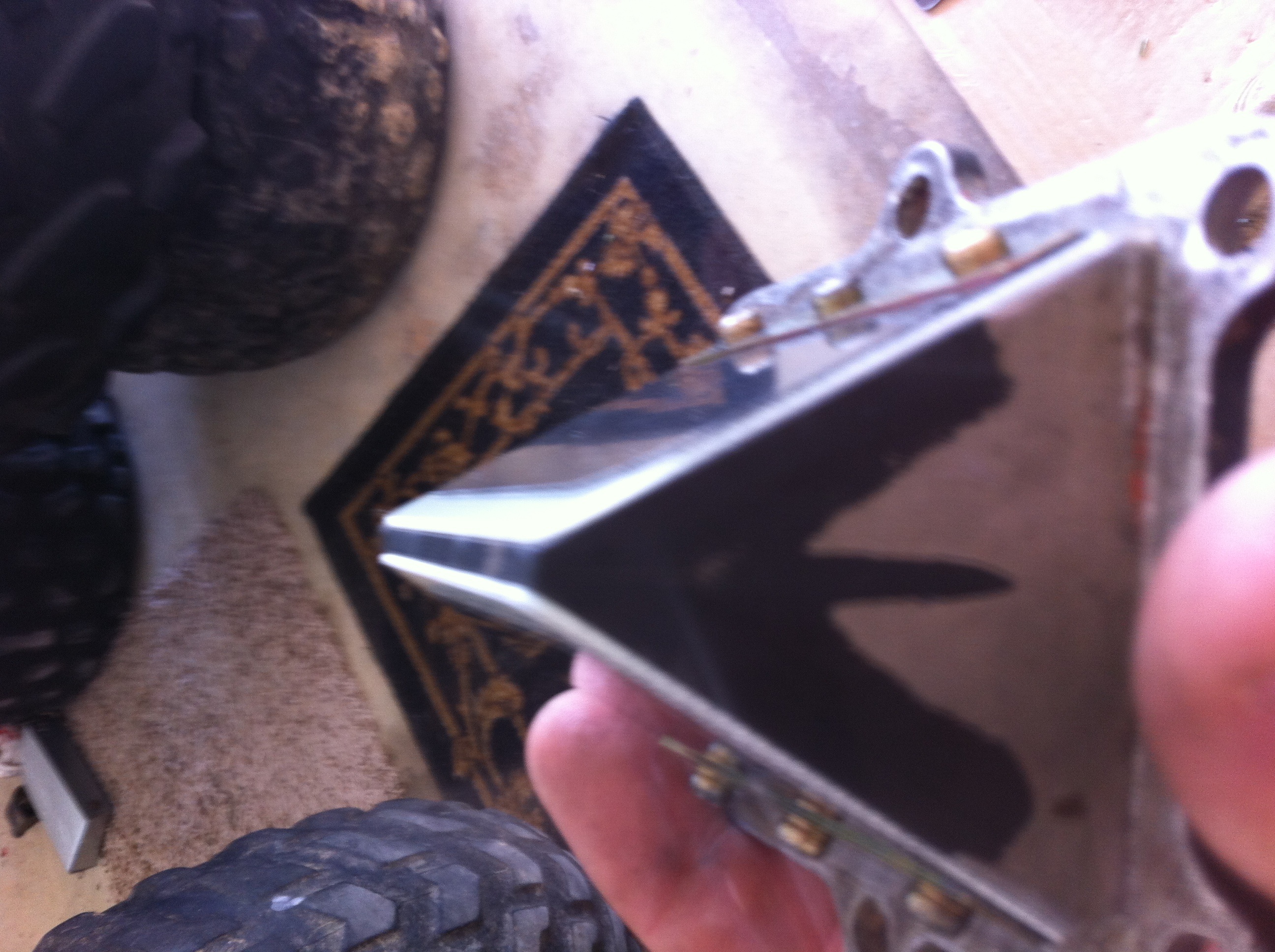

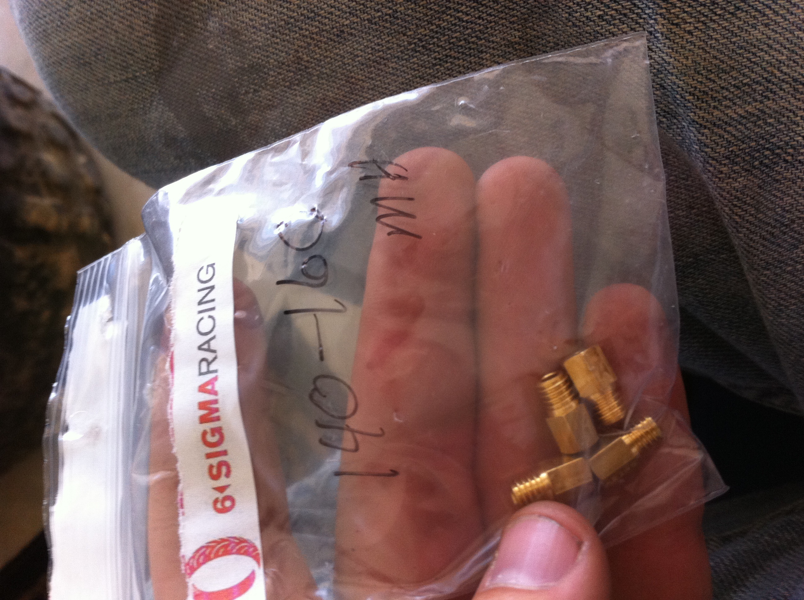

    Forgot to post this earlier, Me deciding to install new Boysen Power Reeds before and after u can diffinatley see the gap n the old reeds compared to the new.
    And Boiling 27mm intake boot in hopes to fit 32mm Carb which I don't recommend 5mm little too much to make it stretch
    And Me switching out 200 Main jet that it came with to a 160 In hopes to make sure its still rich for wiseco Break in but not 200 bc that would be way too rich and not in the general ball park I need. and prolly end up gradually carefully leaning out to somewhere between 145 150 or 155 and messing with needle clip

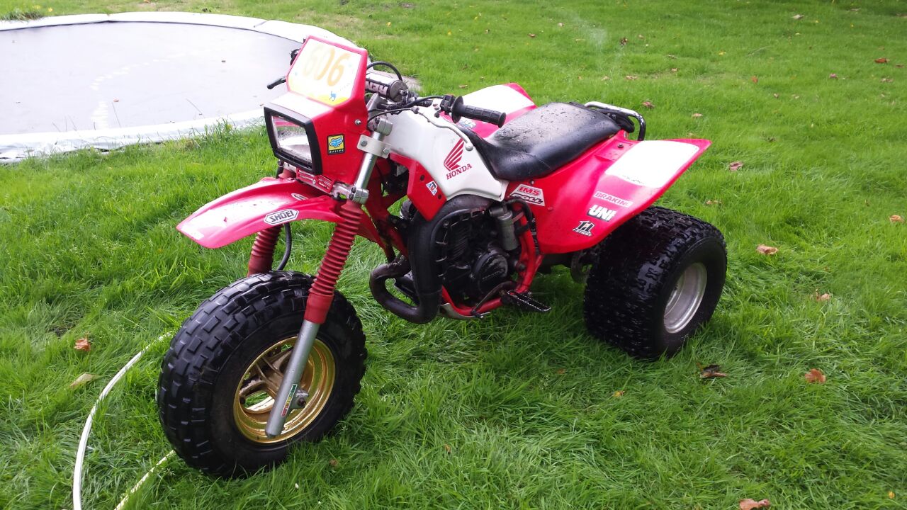

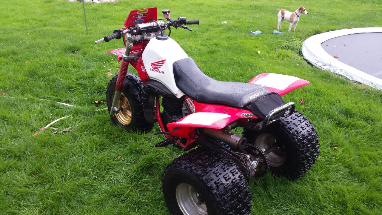

    I Recently picked up an 84 Honda atc 250r, for about $800. Great condition and Super Fast. Love these things. In the Netherlands where I live, these things are a rare item. Nobody heared of 3 wheelers here.

    welcome to 3ww do you know what rear fender that is??
