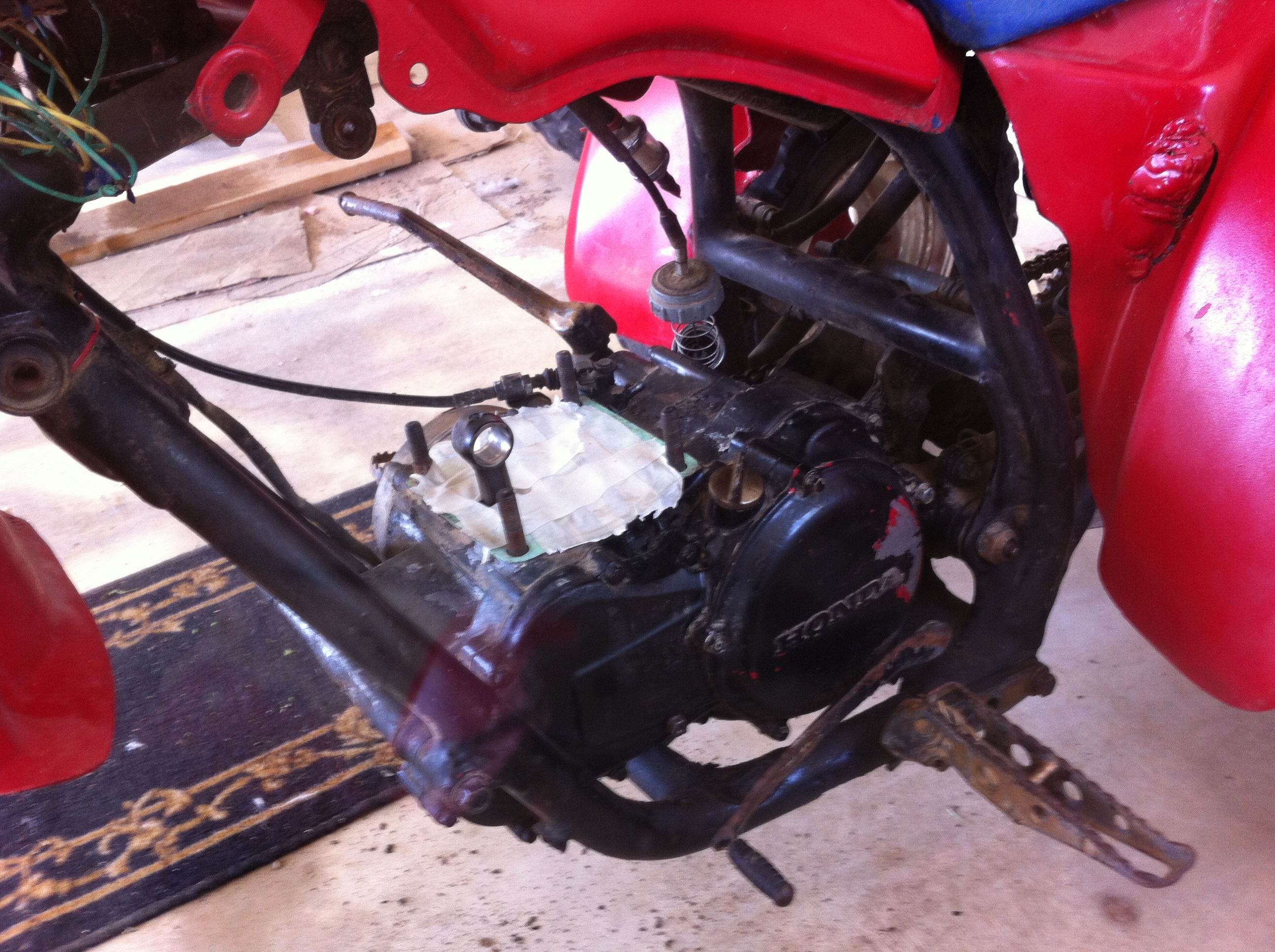

    Picked up 250r. Bottom end seemed ok transmission shifted through all the gears clutch felt good. But it didnt hav top end so could not here it run. It came with tri z head lights original gold rims and some aftermarket aluminum ones as well so 2 sets of rims and tires got it for $400. but il need to buy exhuast, carb, and jug and piston. Any suggestions for a carb, exhuast, and top end rebuild kit. I know ebay but don't know much about how the quality is. I'm not looking for a screamer just getting running basically. Il post so pics shortly

    Needs lot of work. Tri z head lights gold rims and aluminum ones forks looks like needs to be flipped around. But that's least of my worries. Gonna start ordering parts.

    Yep thats a project, those rear rims, tires and hubs are off like a 400 ex or the like, good swap. Looks like the engine has been apart for a while. there are a # of 2nd gen R builds going on right now. Go through the build threads and get some info and ideas. They are great trikes. I am redoing an 84 right now. Find out what you need for engine parts and what not and make a list of what you need. Where are you located?

    Quote Originally Posted by pipeline triker View Post
    I'm in Misery, I mean Good ole Missouri
    Need:
    Carb, top end rebuild kit, jug, header, Reeds, intake manifold, air box and hoses, skid plate, Throttle cable, tail light, grab bar.
    If I go to a 72mm Bore would I run into heat problems? I found a jug 71.8 mm bore.

    the carb size depends on the cyl porting, pipe, engine size and riding preference but a 36 mm is a good all around size for a performance bike or around a 32 for a cruiser.
    the best deal on a carb is an old school mikunui VM style. they are around 75.00 new. even if you are marty hart or jimmy white you do not "need" a $200.00 Octo Port Dragon Slayer XXX 2000 made of Prefabulated Amulite because it ain't gonna make you any faster. Spend the money you saved on the beverage of your choice.
    vm 36 ebay $99.00.
    http://www.ebay.com/itm/Mikuni-Geniu...3#ht_451wt_884
    look here for the intake boot
    also check mossbarger and boysen for reeds and intake boots or buy stock type reeds.
    Jan 2013
    minnesota
    5,911
    Quote Originally Posted by jacobfour View Post
    Yes, do it right the first time and buy one that is a decent 71 mm max. this way you can bore it when you get it and still bore it a few more times. if you use wossner, you might need to re-angle the squish band in your head.
    you can buy orig cast pistons in the last link which are good. wiseco and wossner also sell them. also see pro x pistons and sleeves in the la sleeve link below.
    http://www.wiseco.com/ProductSearch.aspx
    http://www.wossnerpistons.com/produc...-name=2+Stroke
    nos oem parts supplier
    http://www.cmsnl.com/honda-atc250r-1...188/partslist/
    you can also buy a trashed cylinder and buy a sleeve for 125.00 and get it installed for around 165.00.
    http://www.lasleeve.cc/index.cfm?mod...R&model_ID=121

    No you will not have any heat problems with a 72 mill piston. I ran one for years at 72 mill and didnt have any trouble.A member on here 1upfront has a stock cylinder bored to 74 mill and he hasnt had any heat issues.
