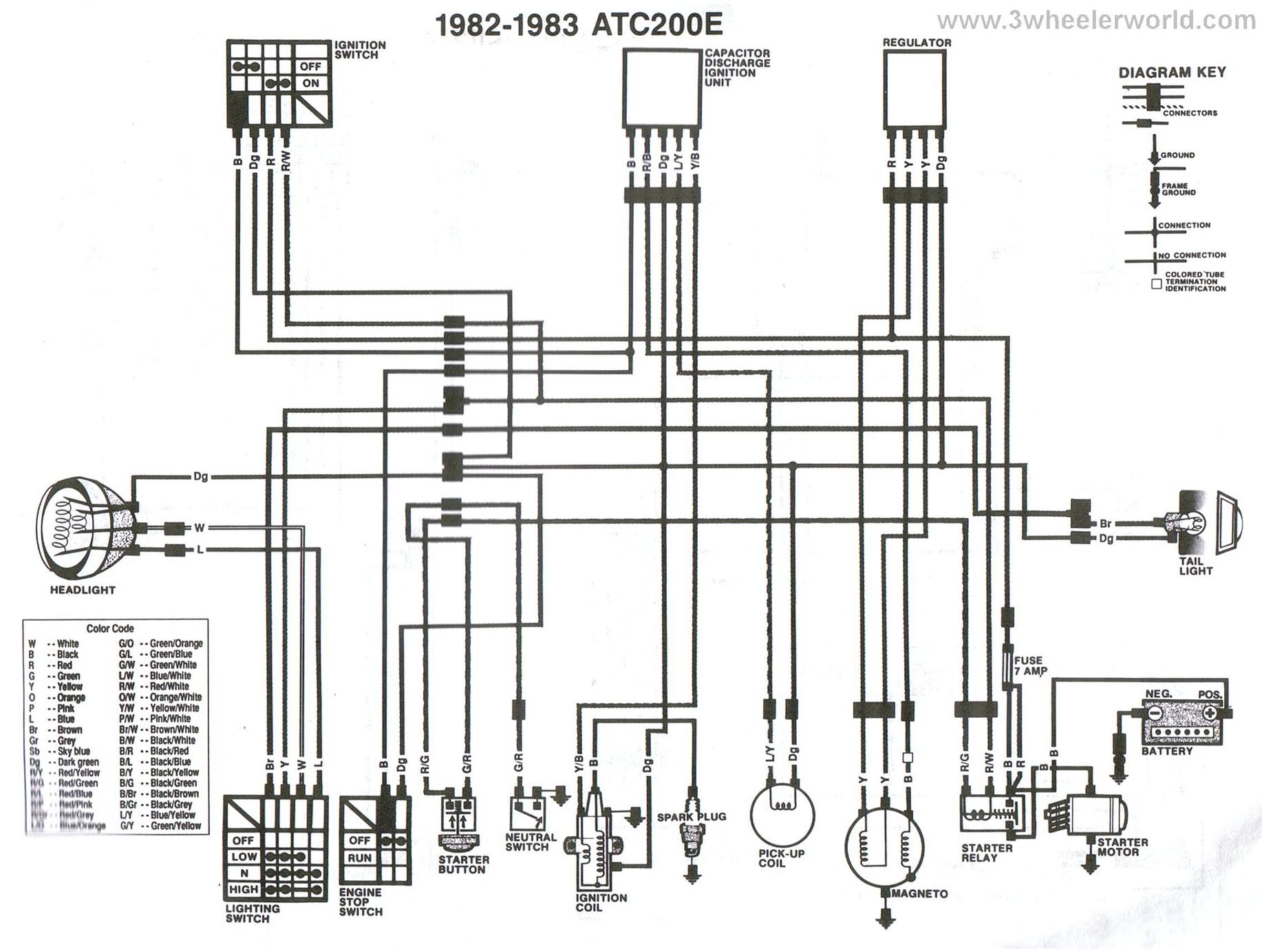

    hello;
    there's a few ways to check it, here's a couple.
    1. unplug voltage regulator
    2. on the half of plug that goes to the stator, check ohms or continuity of one yellow wire to ground, it should be 0.
    3. check the other yellow wire, it should be 0.
    4. set meter to ohms and check from one yellow wire to the other. there should be a reading.
    4. set meter to volts, connect meter to both yellow wires, start bike and check voltage at idle and around 1/2 - 2/3rd throttle. if it stays at around 15 or below it is bad.
    wiring diagram
    http://www.3wheelerworld.com/attachm...9&d=1261801941

    oops, if the stator is good your regulator is most likely bad.
    check all connections and clean as necessary rhen plug it baxk in and retest before buying one.
    make sure your battery is good.
