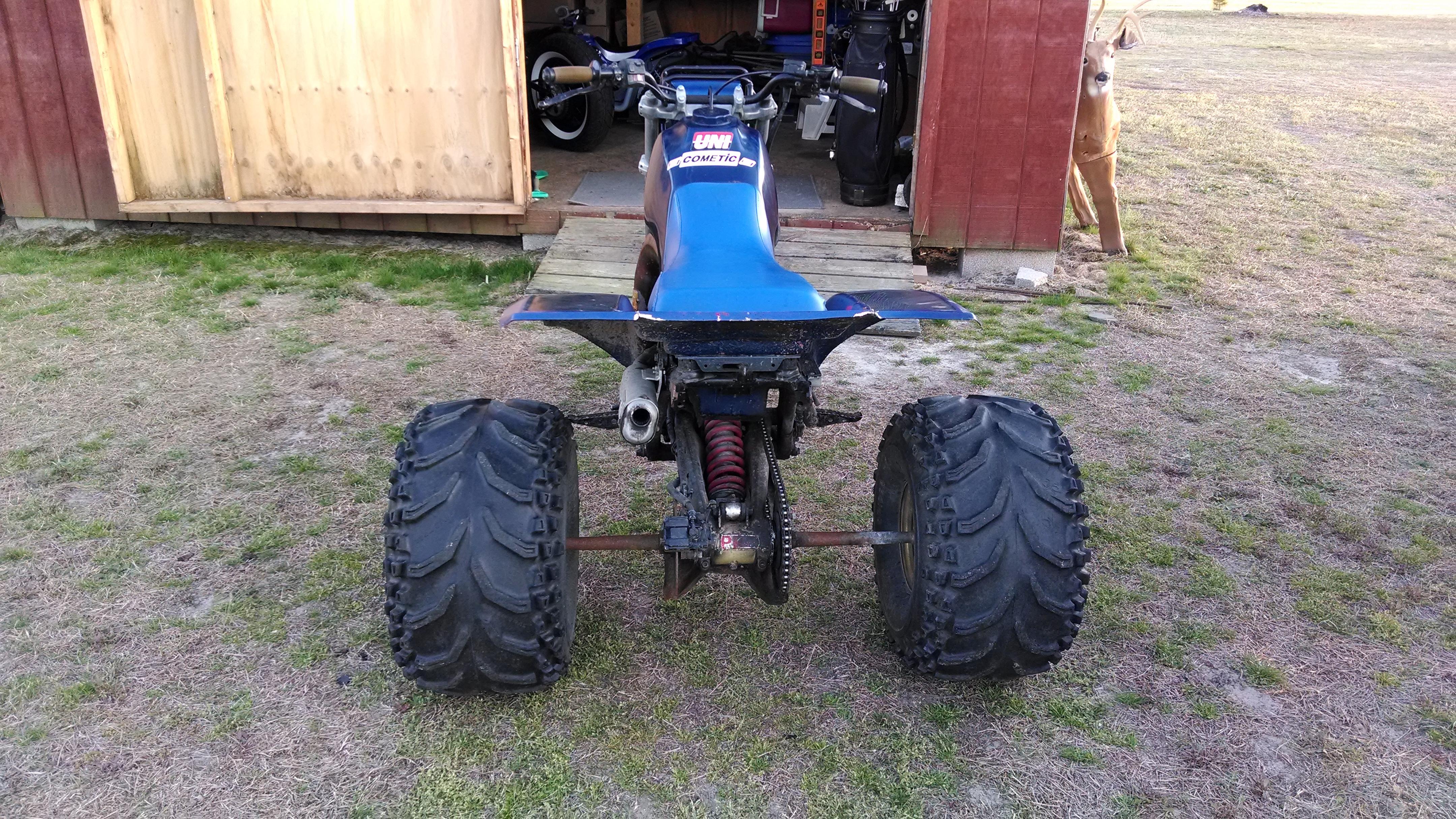

    I recently bought a 1983 ATC 250r and noticed it wasn't running the best at low speed so I drained the gas and trans fluid put in new transfluid and new gas. I used Lucas semi synthetic at 32:1 went to ride it but it seemed worse than before. The gas I drained out of it almost looked like it didn't have any oil mixed in at all so I'm not sure if the guy was running straight gas or what. The guy I bought it from was selling it because his son got in some trouble and the dad didn't know much about the 3 wheeler. He said the top end was rebuilt and cylinder was supposedly bored .70 over recently. I put a new spark plug in and it was still doing the same thing. I drained the gas and put the original back in and it seemed to run better for a little while but then started lacking power in first gear and toward the top end would bog down sometimes it would cut off when slowing down. Tonight I checked the carb and reeds and noticed a very small gap on the reeds and the pilot jet was pretty nasty. I flipped the reeds and that looks a little better so i think I'm going to clean the carb in the next couple days and see if that helps.
    The carb that's on it is a keihin with a 140 main and 50 pilot jet. Is this the stock carb for this bike? The only numbers I see on the carb are 30aauky. The y could be a 4 though not really sure.
    Sorry for the long post! Any help is appreciated!
