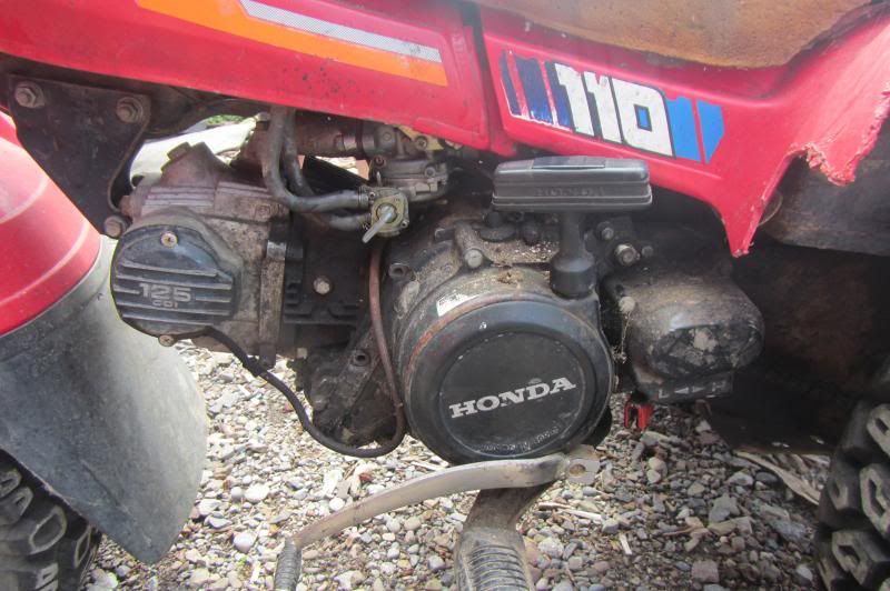

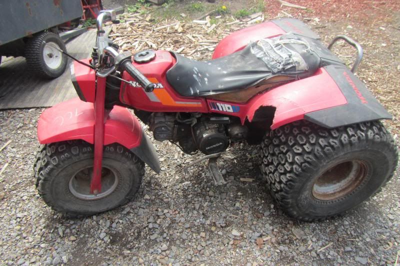

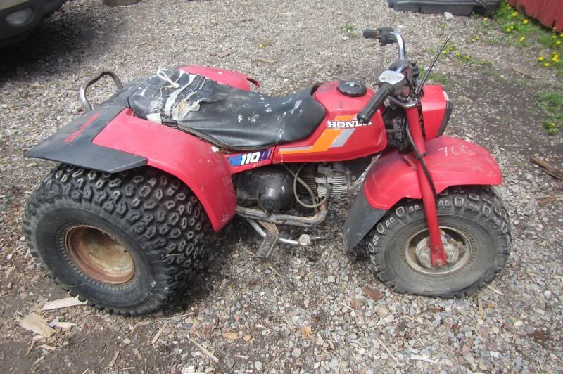

    pics
    Some pics of it Not bad for 100 dollars

    To clean out the sludge, you can take some old gas and slosh it around and dump it out. To remove the rust some people soak it in apple cider vinager and that works. There are replacement plastic tanks out there, but I like the metal ones. They look WAY better.
    Try and find the rubber hose on eBay or ask for one on here, if you do decide to go with a pod filter you WILL need to rejet. You have to compensate for the increased air flow.
    No they did not make nerf bars for this model, maybe you can fab some up yourself.
