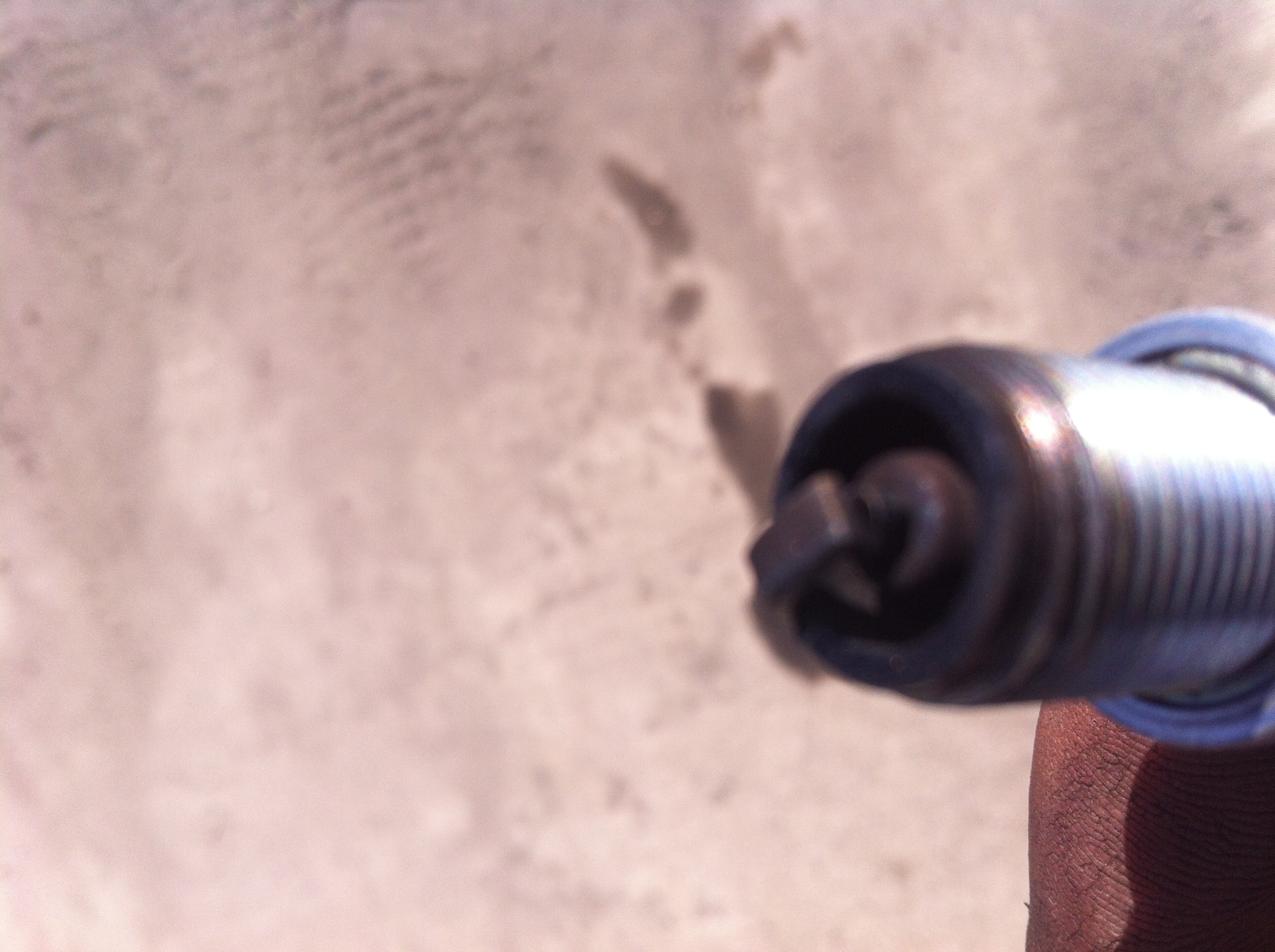

    post a photo of the spark plug.

    Thanks for the advice. Got the trike from the original owner and its 100% stock. I'll get a pic of the bike and the plug posted this afternoon.

    ok cool, look forward to photos.

    That's easy to get at. I'll check if that's the problem. Personally I think it's in need of a carb clean but I don't know lol all I know is that the plug is dry when I checked. Lots of spark tho. Found that out the hard way
