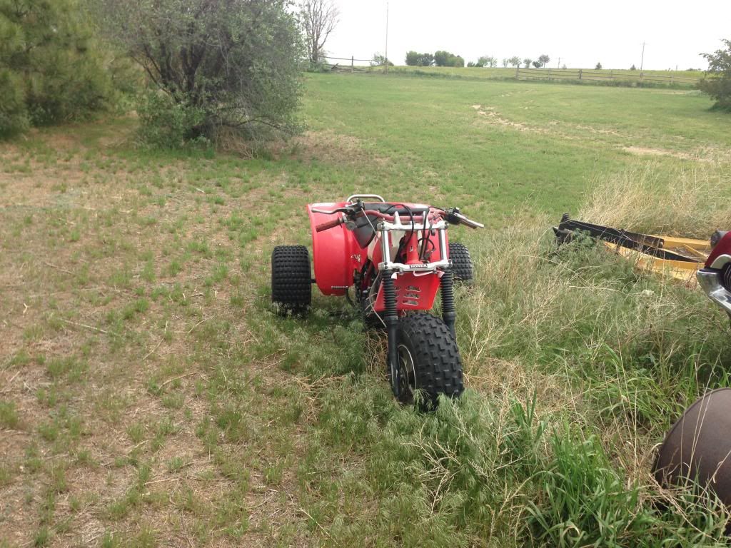

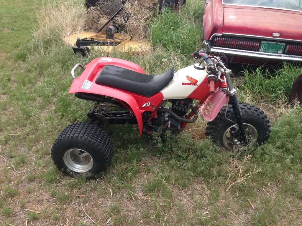

    Just had my father in laws race 200x passed down to me. Been sitting in the weeds for a while but I already have a good parts list built and some on the way. Picked up a 22x7x11 front tech4 tire, new chain and sprokets, an new 86 250r front fender. It already has an extended swinger, extended axle, hi comp piston, ported head, supertrap exhaust and a larger carb. I will post some pictures Thursday of it being pulled from the weeds and the progress of the build. I also have another 200x for parts.

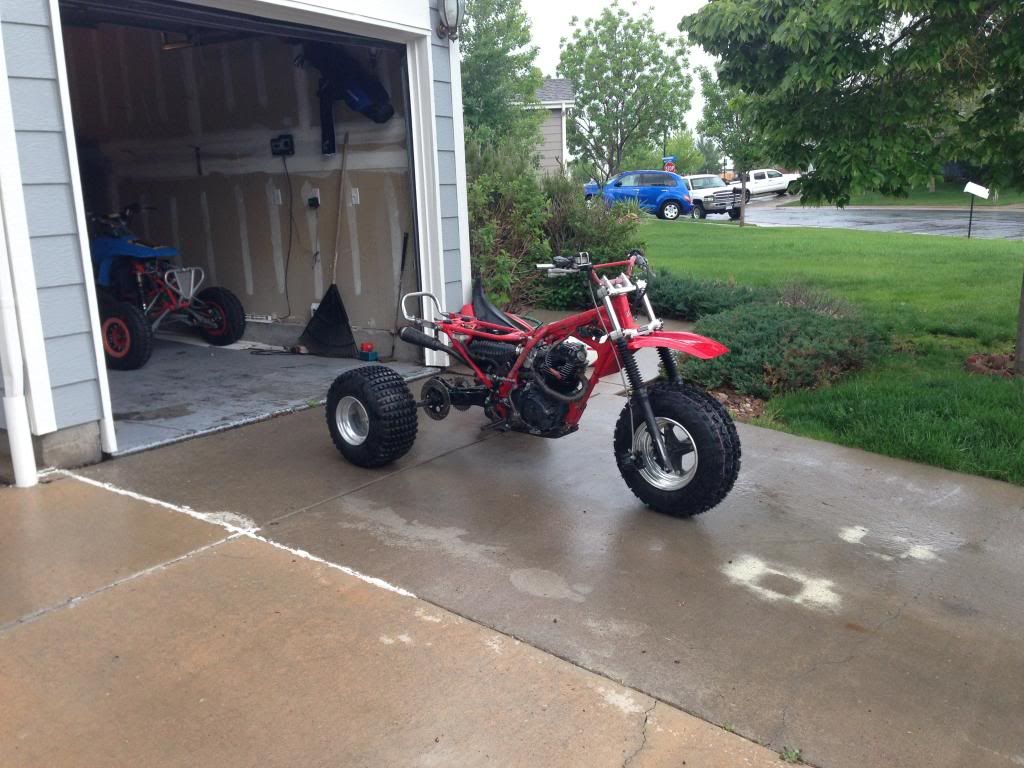

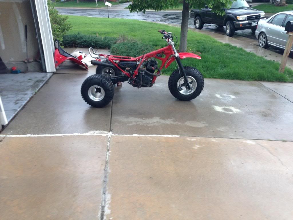

    Here she is. I got a little bit done today.

    Just got on the new 250r fender and clutch cable. Carb is off soaking and tank is full of vinegar. At 5000ft she pumped 160psi on my cheapo compression tester.

    Thanks guys! Ya, my father in law ended up getting cancer a few years back and is still recovering so off to the weeds it went. There is also another 200x in full parts that's mine to pick from and an ATC70 in the weeds that's complete. He also has a mint 86 350x in his shop. I will keep updating this post as I progress on the revamp!
