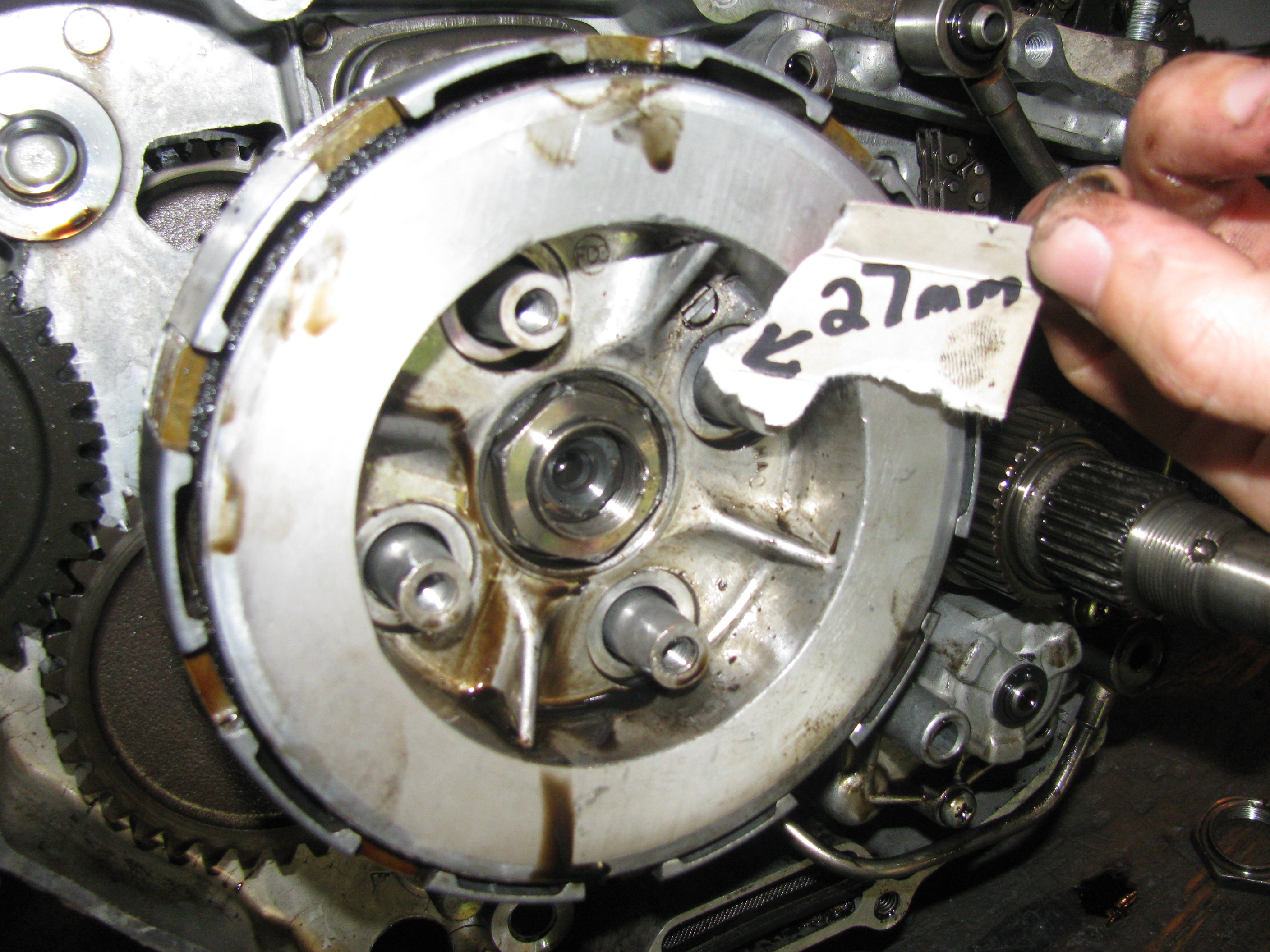

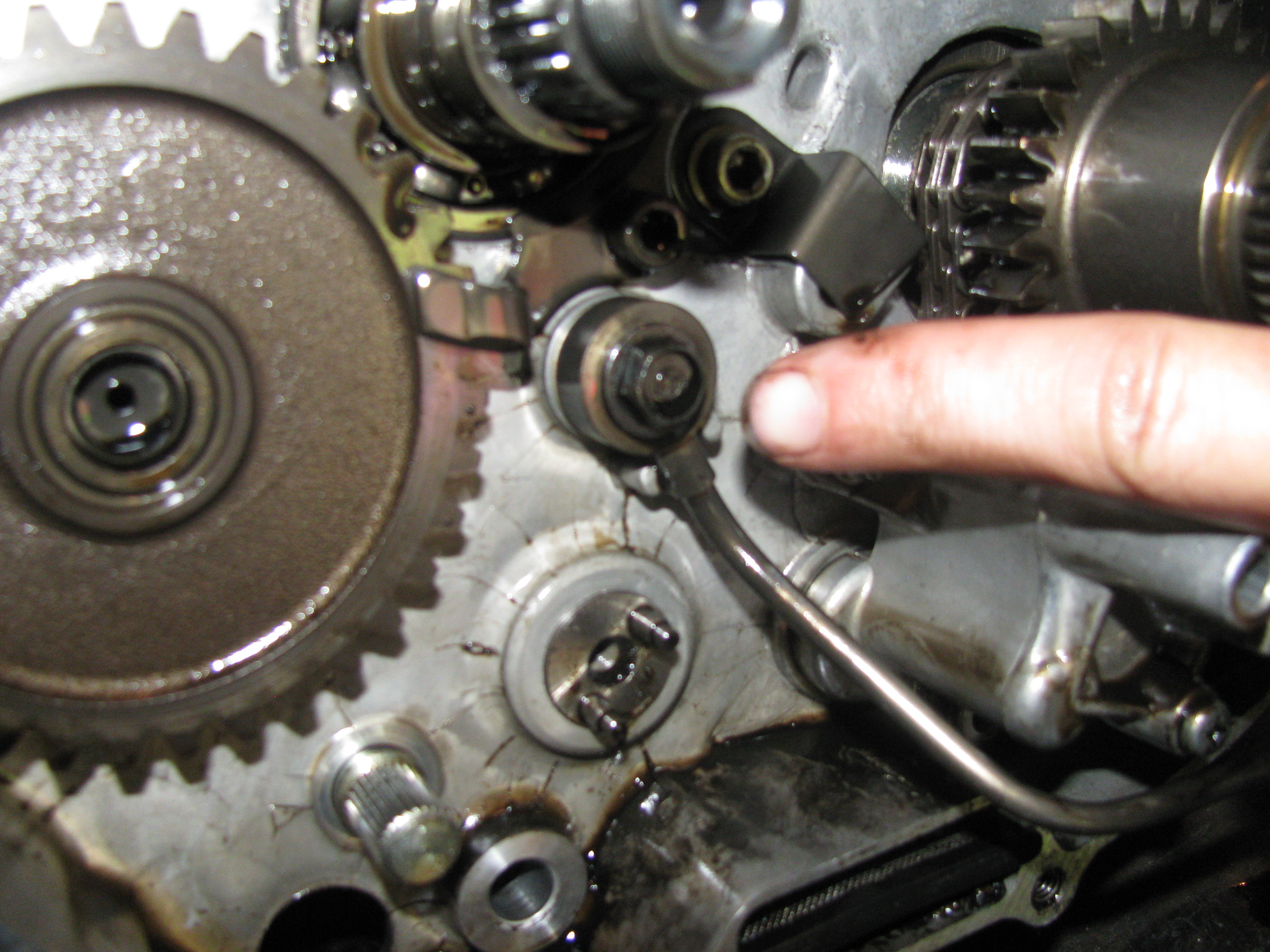

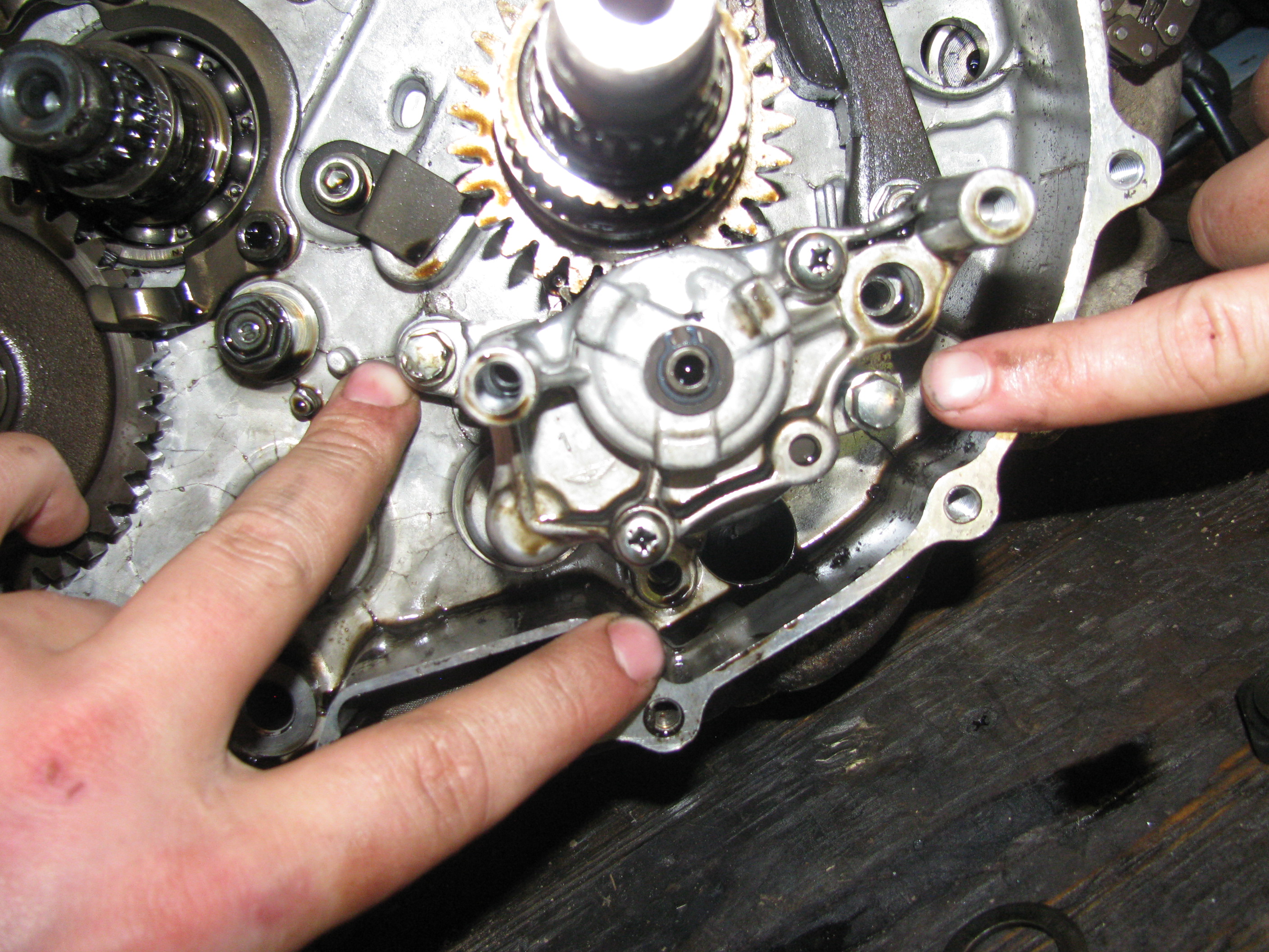

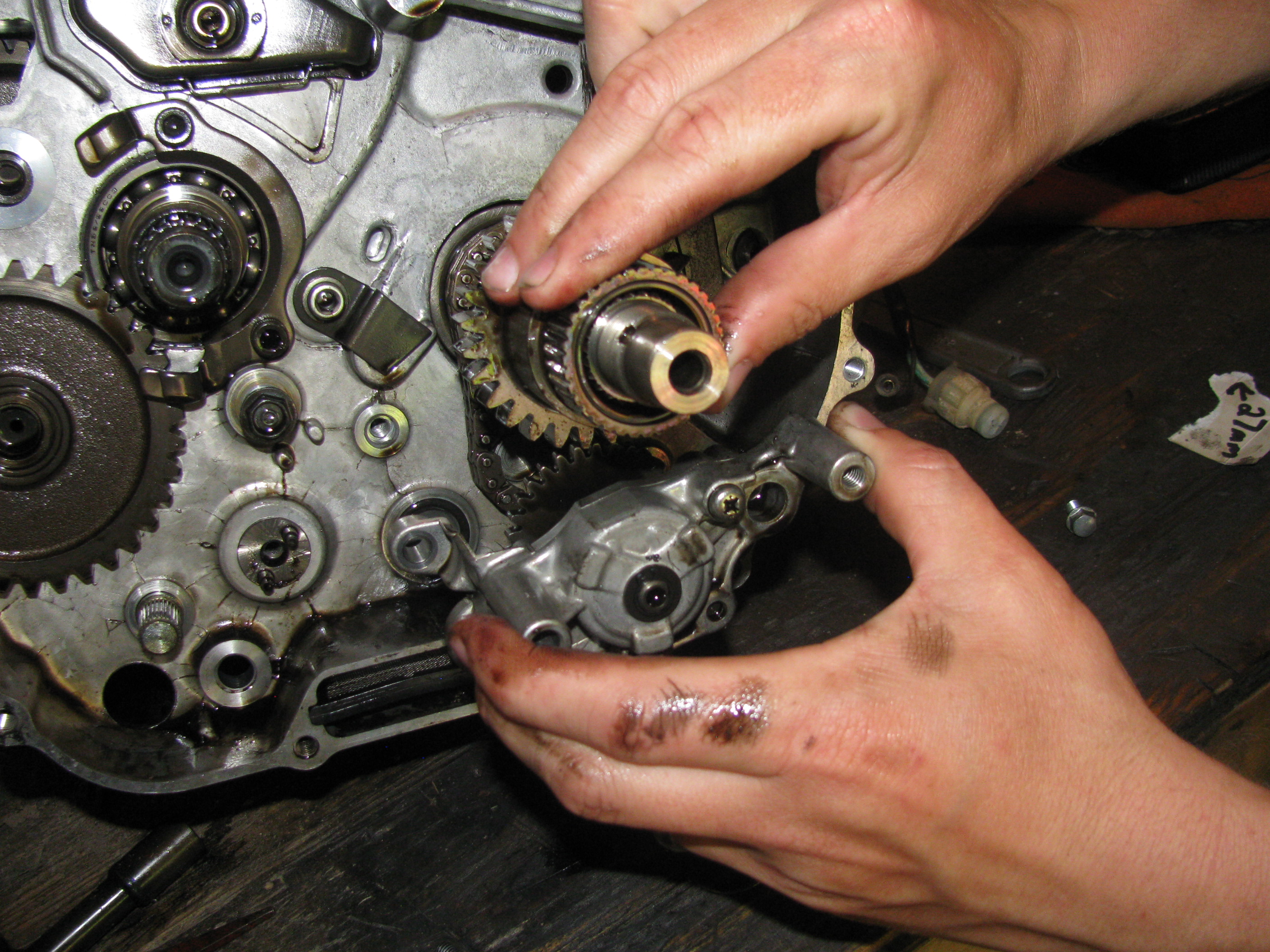

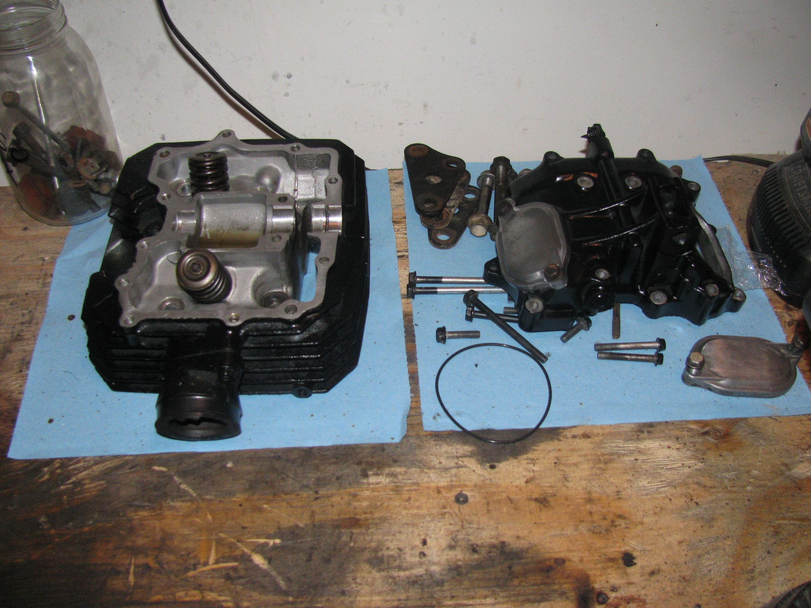

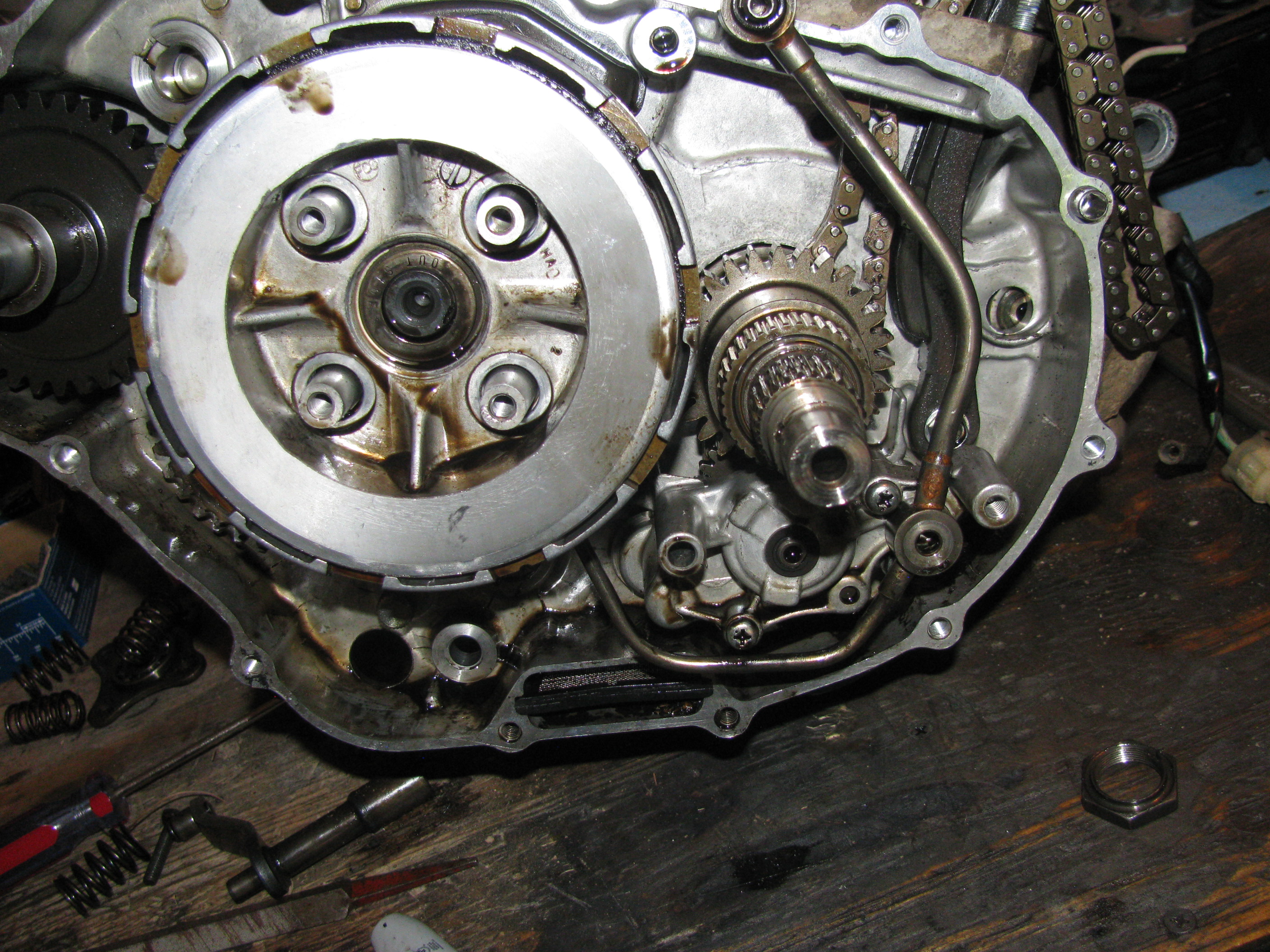

    Okay did a test run on my parts motor; 86' 250ES pretty much the same motor as 250SX. Step by step plus some pictures hope this will help someone!!!
    Step 1: Take Valve cover and cam shaft off/out 8MM and 10MM wrench/ratchet. Pretty simple and self explanatory, (valve cover on right you don't need to remove head but makes the process easier).

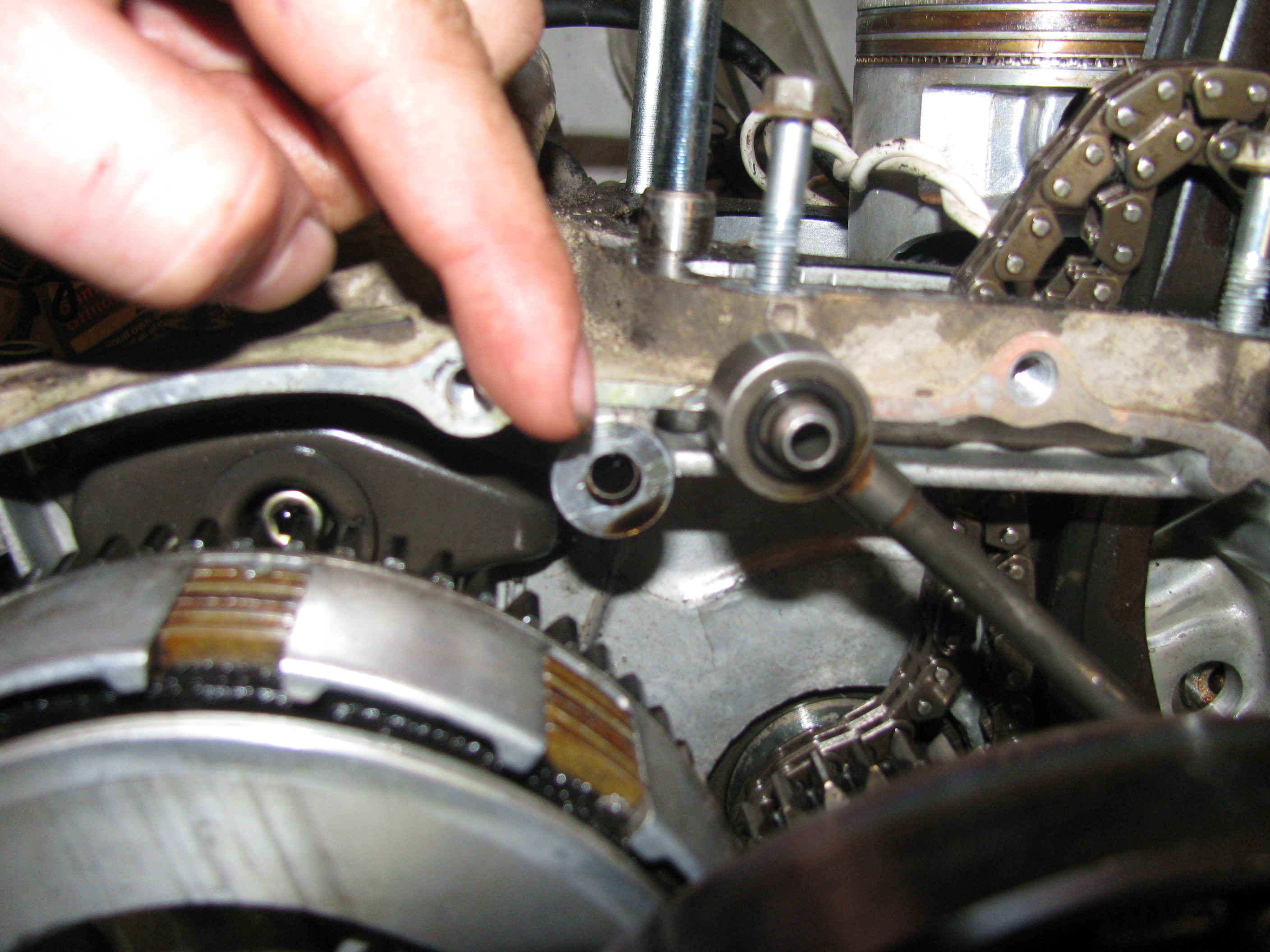

    Step 3: Remove oil line, it just pulls out, be careful not to bend excessively.

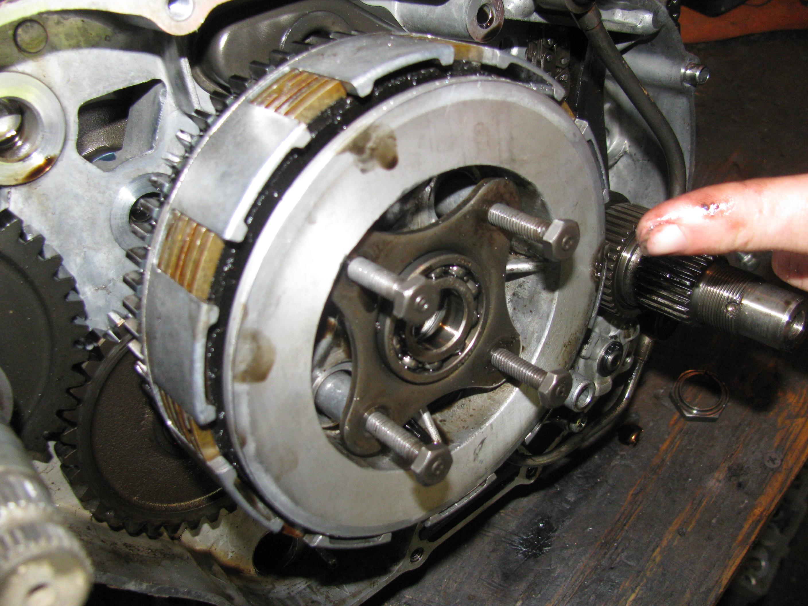

    Step 4: Take centrifugal clutch nut off using 27MM socket (LEFT HAND THRED). And simply pull clutch off.
ID:	194371Click image for larger version.
ID:	194372Click image for larger version.

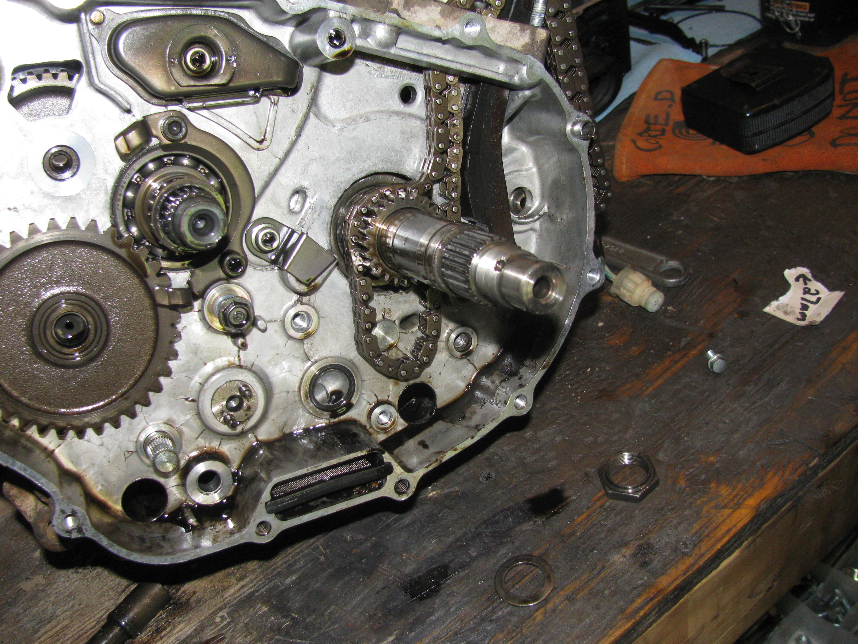

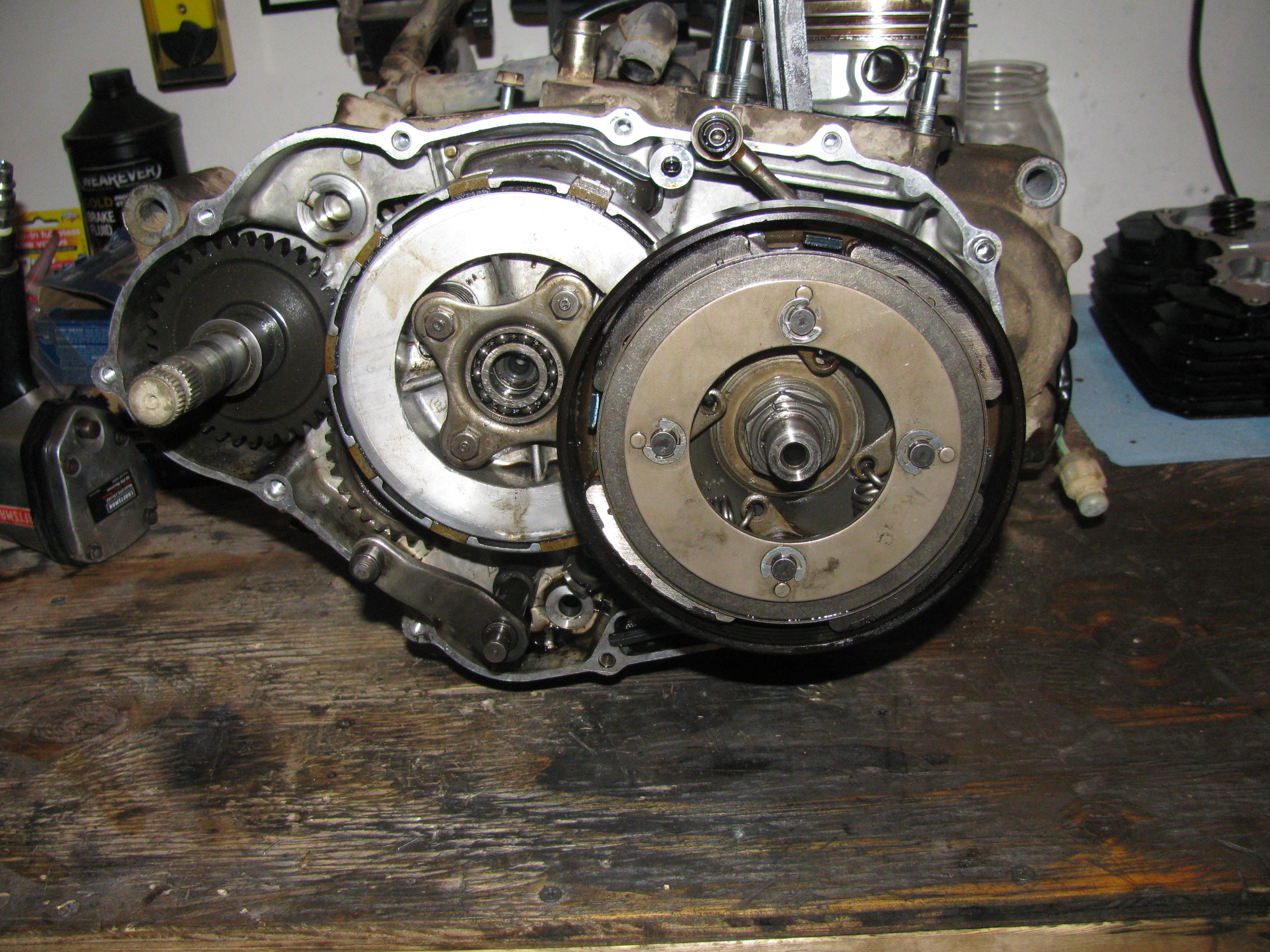

    Step 5: Remove 4 bolts, plate and springs off manual clutch. Take manual clutch nut off 27mm (RIGHT HAND THREAD), and slide manual clutch off.
ID:	194374Click image for larger version.
ID:	194375Click image for larger version.

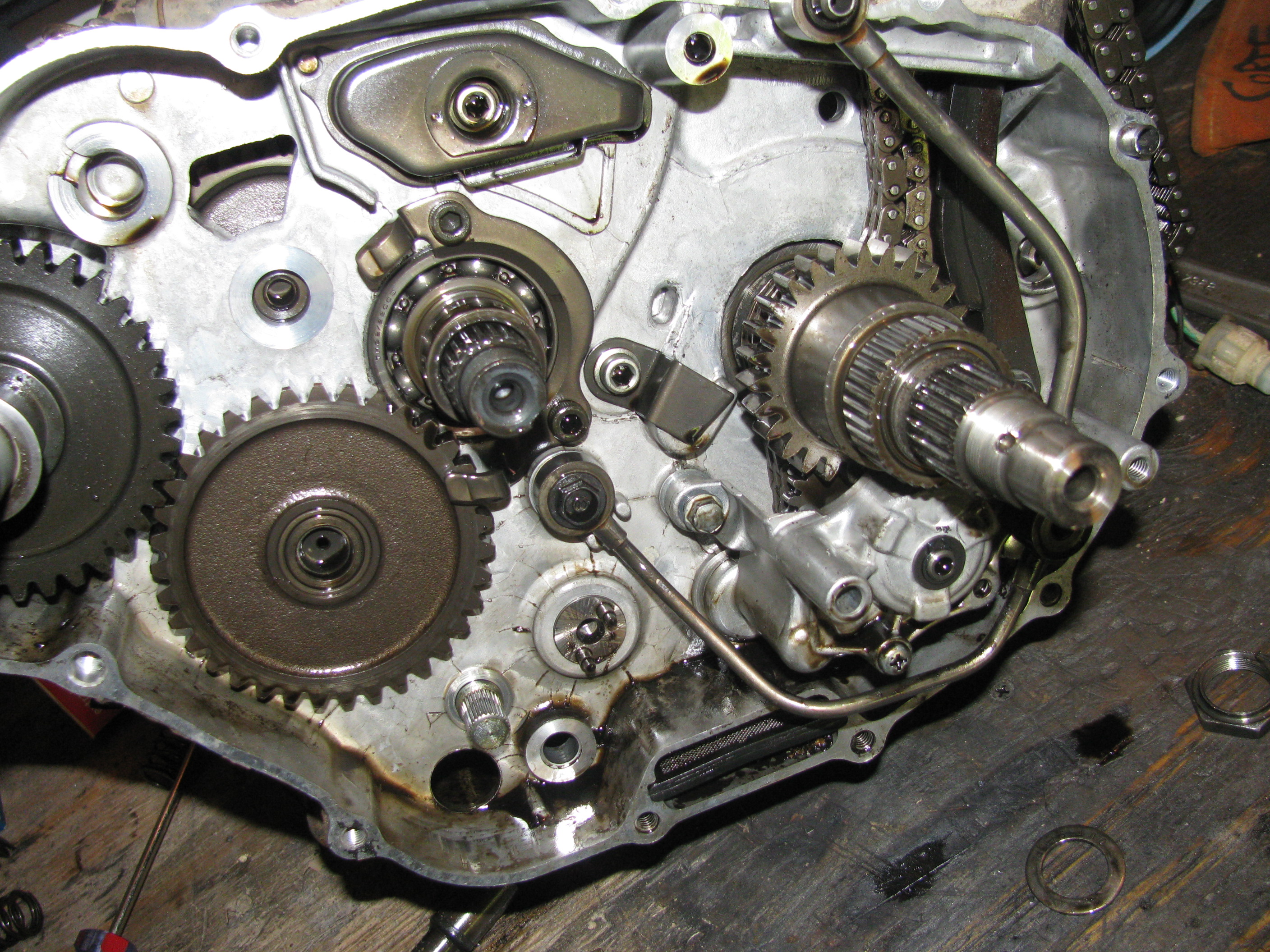

    Step 6: Take two bolts off that are holding oil line on 10MM wrench and remove oil line.
    Step 7: Take three bolts out of oil put 8mm wrench, and simply slide oil pump and gears behind off at one time.
ID:	194378Click image for larger version.
    Step 8: Now your chain is exposed, take old one off put new one on feed up through the cylinder, head, and onto your upper cam gear. As far as I know reverse the process to put back together. Look at manual for torque specs. please look back at my pictures and ask any questions. Hope it helps!
