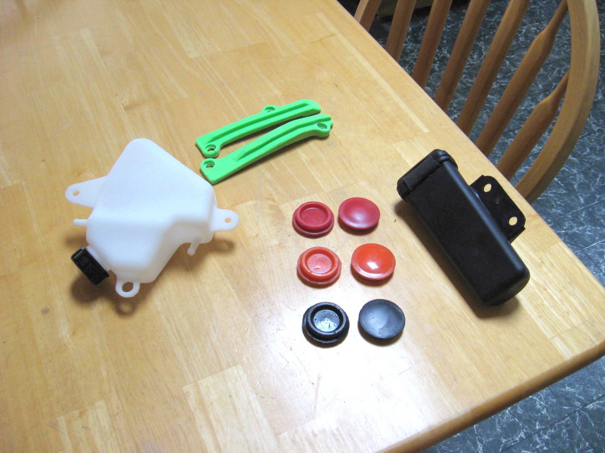

    The Clarke tank is an exact copy of the OEM tank with the exception of using a different cap.

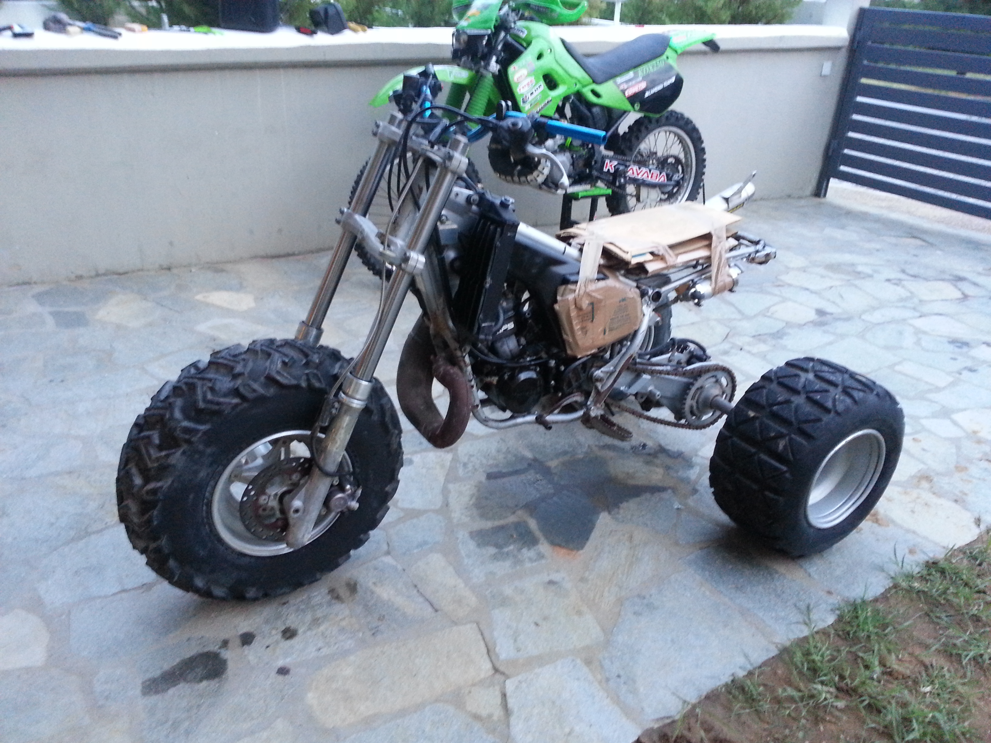

    She's alive!!!!
    Wooohooo!!
    This thing rocks!
    Stuff some premix in there, a new plug and she fired right up!
    There's a small issue with the gear lever not springing back (the return spring is prolly gone, easy fix, got the part) and the carb DEFINATELY needs a good old clean,
    BUT everything works! She pulls strong and hard! The motor has a tonne of power, doesn't bog down and feels really healthy!
    Happy times...
    Here's some pics...

    Please note the home made airbox cover and seating arrangment...
    And here's a lil vid....
    http://youtu.be/5jDSW1bWv_w
    Now off to get more parts...

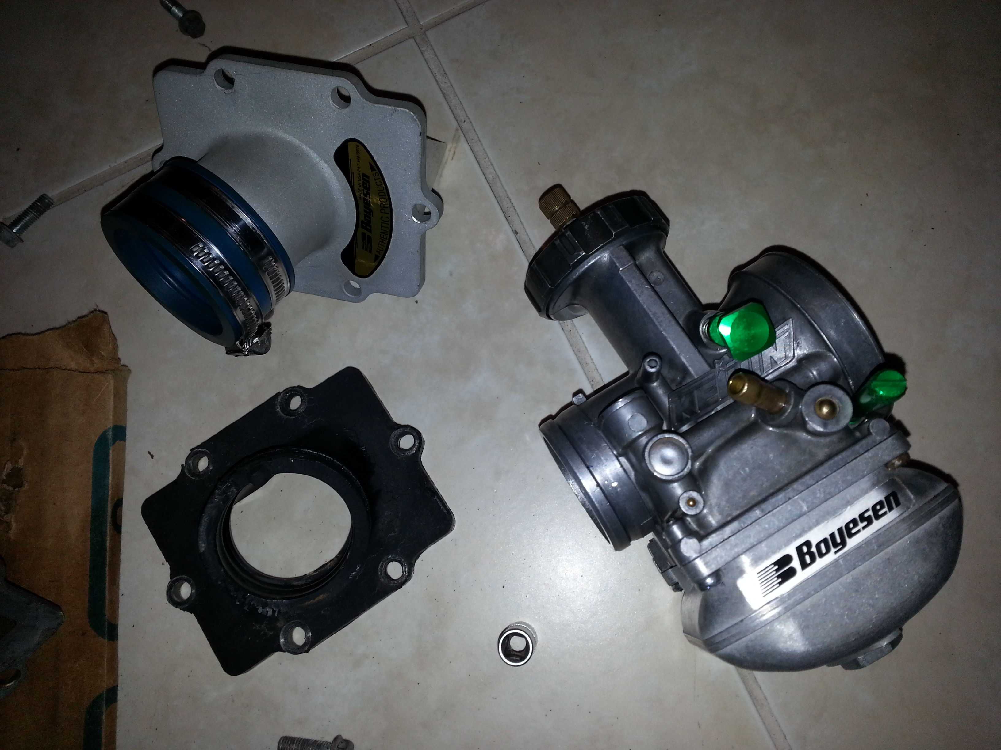

    So I played a lil more and pulled the airbox and carbs off..
    Carb was pretty filthy but no near as bad as I expected it..
    I hate these old mikunis. I really do...
    The carb rubber boot is shot, rotted away and I was talking to john about making me a new one, but it seems its not gonna happen for a while.
    Furthermore the reed cage plastic insert is fairly disfigured, yet the reeds themselves seem pretty decent.
    So I got the idea to swap in my boyesen rad valve. This is a 1987+ kx 250 item (kx 500 and kdx 250 too)so the neck points further to the left and sticks a lil more out. about 1 cm more or so.
    Then I mounted my spare PWK38 with the boyesen bowl and goodies.
    I find these carbs to be much easier to tune right and work on.
    So....this is the dircetion I think I am gonna head with this. I will not be able to run an airbox, which I dont have the lid for anyways, so a pod filter is on the carbs..
    The new neck direction will actually help a lot with mounting the pod filter. Nothing else seems to hit (dont have a tank one atm though) so I think its a go..
    Comments please?

    Nice work !
    I would recommend to secure the carb some how so the intake manifold is not doing all the supporting. Glad you had a option on that part.

    Thanks John! That sure is something to consider man.
    Having said that the boyesen rad valve has a cast alloy uni-body and should take the load easily. The connecting rubber piece is pretty heavy duty too and easily replaceable.
    Its like hitting 2 birds with a stone this. 3 birds in my case with the delapidated parts..
    What are your thoughts on dirt and dust retention on these pod filters? With a precharger unit on.
