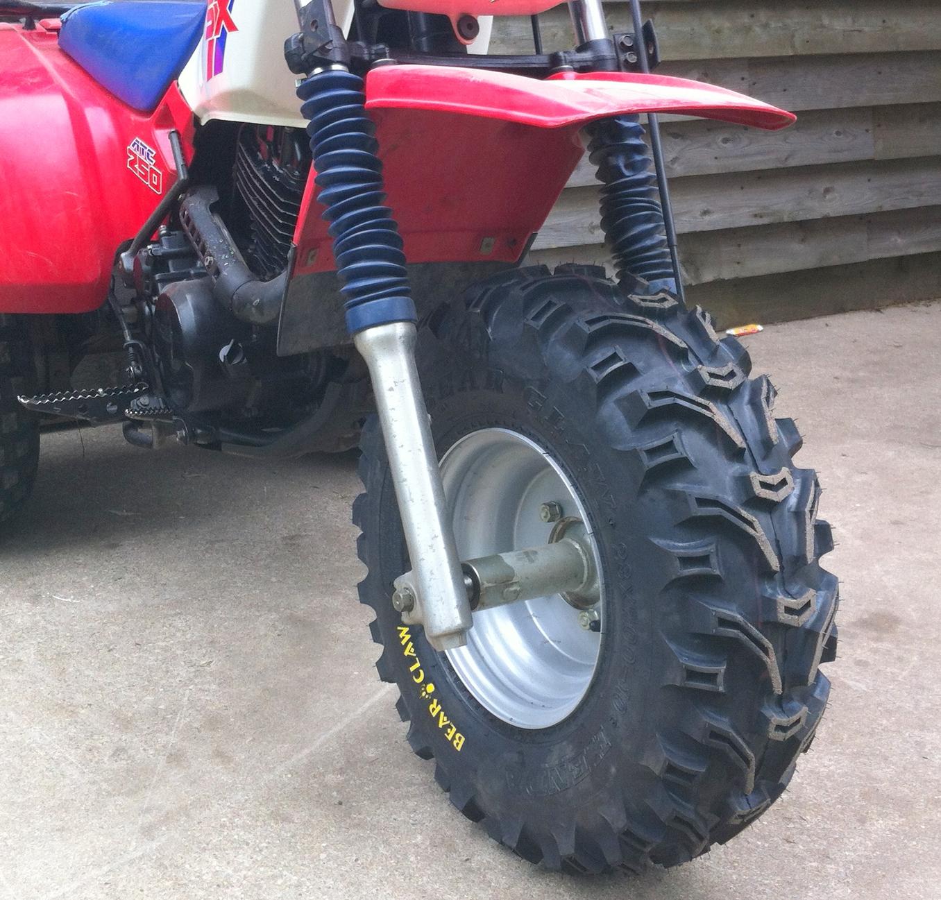

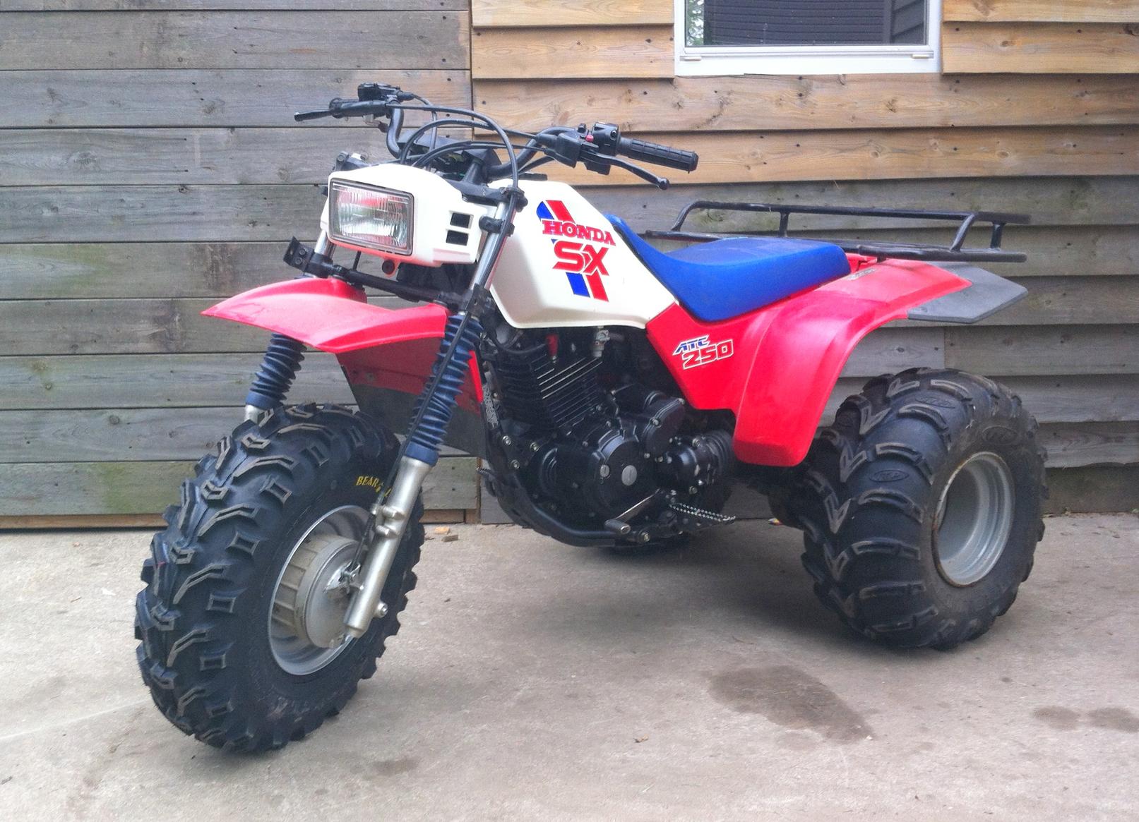

    I'm agreeing with every word so far..but as a guy who makes it his hobby to experiment with new tire/rim setups hear this!!
    New front plan for you..
    Rim: 4/110 ITP Steel Wheel 10x5 2.0 + 3.0
    Tire: Kenda Bear Claw ATV Tire 23x7-10
    It's inexpensive, a direct bolt on without the need to shim, and will improve the handling incredibly!!
    Oh yeah, it looks pretty bad aZZ also without the need to do a frontend swap like some of the guys have done!!

    Rocky Mountain ATV is my favourite tire supplier online(or others) and should be able to fix you up..the front tire and rim will run around $100 from most vendors.
    One more thing..mount the front tire as a 'right side' to get the directional tread pointed in the right direction. But truth is it doesn't matter..I've got it backward on my 250ES and it's all the same!!

    Hey Doug... Doug here. Ha ha!
    That Claw on the front is sexy! I was almost thinking Kenda Front Max. I have that style on my Auto-X. I may end up with a 3rd Claw now. Have you experimented with a Front Max style at all? Just curious if it makes a difference from a smaller 200 cc to the 250's with almost 100 lbs more dry weight.

    Yeah Doug, I have a Kenda Front Max on my 350X and it's great on the trails/sand/fields..but no never on a smaller machine. Don't know what to tell you about that!!
    But then I like the mud like our friend Mr Whiskers here.
    The Bear Claw (or Mud Lite) rules that turf!!
