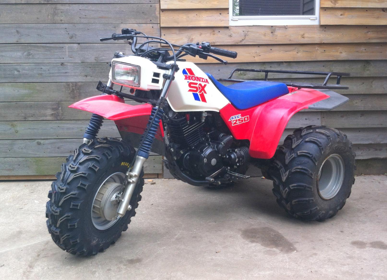

    I just put a set of 22x11x10 Swamp Foxes on our 85 250sx. I wanted a little more selection for tires so we upgraded the wheels to a 10". I really like the way they perform. Good tire for just about any terrain. A little washy on hard pack terrain, but not terrible. Definitely better than the stock tires we had before. Wheels are AMS .190 aluminum 10x8 3+5.
Name:	250sx complete 2.jpg

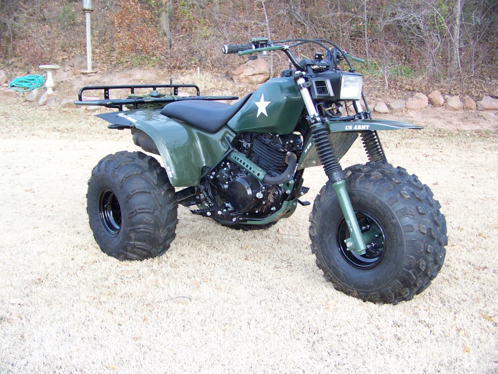

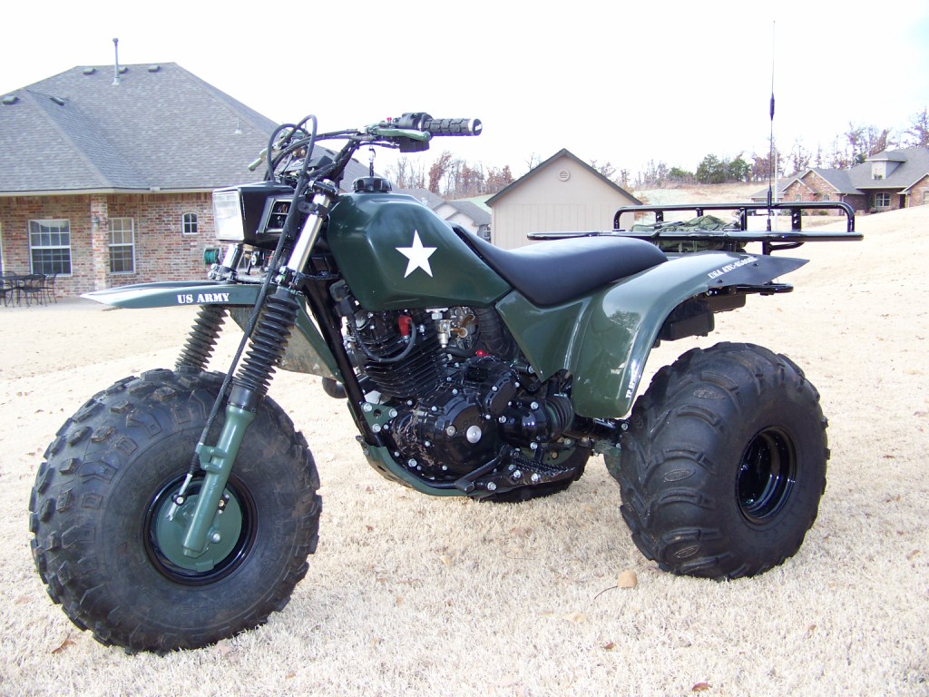

    Ya baby!!!!
Name:	100_0474 [1024x768].JPG
ID:	195317   Click image for larger version.
Name:	100_0472 [1024x768].JPG
ID:	195316   Click image for larger version.
Name:	100_0470 [1024x768].JPG
ID:	195315   Click image for larger version.
Name:	100_0469 [1024x768].JPG

    Good lookin' set-up!!!
    If you don't mind me asking... what is your front tire/wheel combo? Is that an aluminum wheel? What is the diameter and offset? I like more of the 200X front end look like your rig has.

    Quote Originally Posted by Marksman View Post
    Thanks Marksman.
    I am using an 85 200x complete front end (hub, aluminum wheel, forks and triples). Tire is a 23.5x8x11 Pro Vector. Stock 83-85 200x front wheel if I remember right is 6" wide by 11" dia. with a 3+3 offset and a 4/190 bolt pattern. (Correct me if I’m wrong guys)

    Quote Originally Posted by Motorgidd View Post
    Thanks Marksman.
    Okay, I could not tell for certain if that was a stock 250SX front-end or a 200X. Thanks for the info!!!

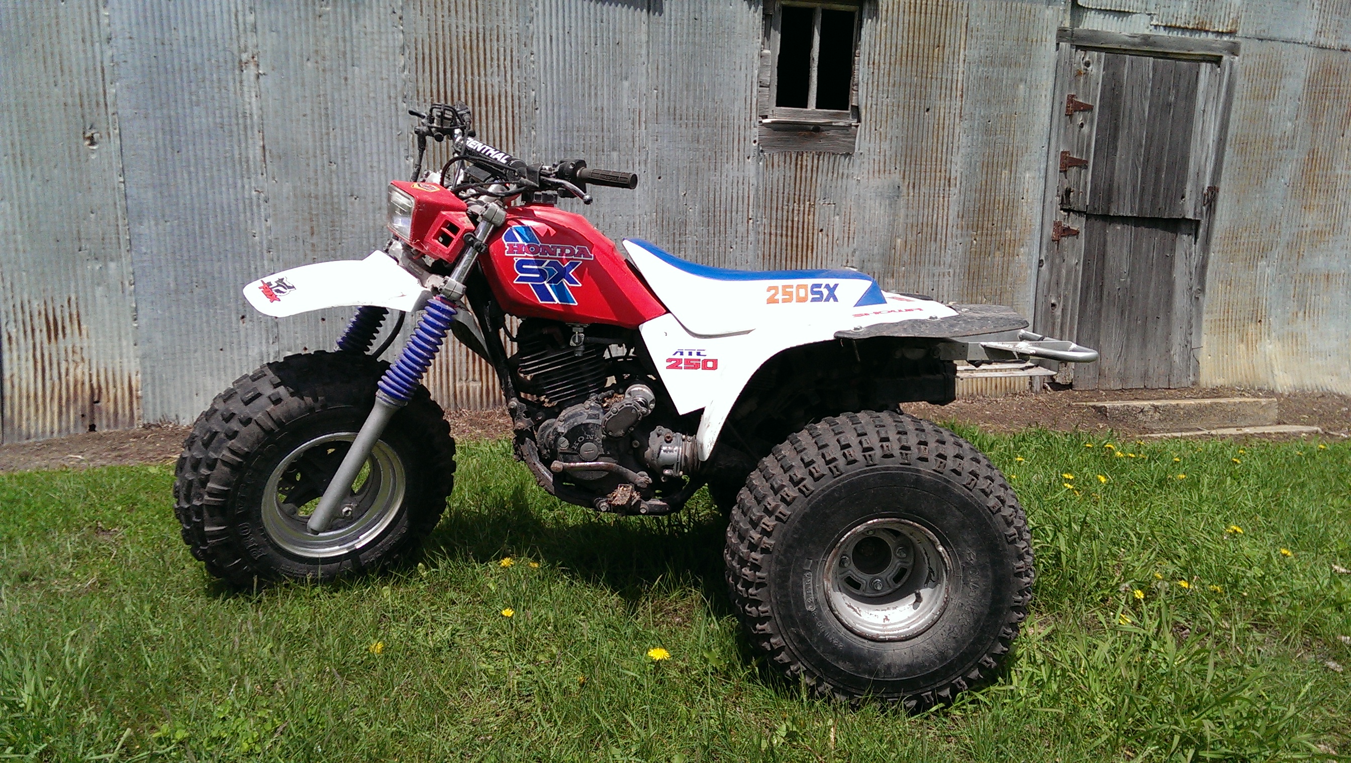

    Hey Doug, I love your combo, and I'm going with Bear Claws on all 3 corners. However, I am thinking about going with aluminum wheels.... what do you think about the following wheel for the front (you'll have to click the option of "front" to get the correct size to come up):
    http://www.rockymountainatvmc.com/p/...0-Wheel?v=1919
    The spacing is correct. Is this rim strong enough to use on the front of a trike? I have the same brand and thickness of rim on the rear of my '85 SX, and am looking to go with this on the front of my '86 SX. I plan to go with the OE rim and tire combo for the rear.
    The silver steel rims would give much more of a 250SX OE look, while the aluminum option would make it look a little more like a 200X. What are your thoughts?
    Marksman,
    I can’t speak for Doug but that wheel is plenty strong for the 250sx. I noticed the offset on Rocky Mountain is reversed from what Doug posted though.
    Doug’s post: "Rim: 4/110 ITP Steel Wheel 10x5 2+3"
    Rocky Mountain: 4/110 Douglas Wheel 10x5 3+2
    The first number "2" in the offset "2+3" is the inside of the wheel (if there is such a thing with a front). The second number "3" is the outside of the wheel also called the valve stem side. You could just flip the wheel around… But If I remember right the valve stem is on the right hand side of the trike when mounted. If you flip the wheel to get the correct offset the valve stem will be on the left side… My concern would be the valve stem might hit the brake drum and it might be hard to put air in with it mounted. I would look for a wheel with a 2+3 offset like Dougspcs said.
    http://www.rockymountainatvmc.com/do...d%20Offset.pdf
    Marksman,
    I have that exact setup on my sx, 3+2 offset, (this exact rim http://www.rockymountainatvmc.com/p/...0-Wheel?v=1919) it works fine just a bit of a tight fit for the air chuck. The only thing I don't like about the setup is the 7" tire is a bit to narrow and doesn't float as much as I would like it to in the mud and snow, personally I will buy and 8" wide tire next time but each to his own
    Marksman,
    Great advice... and Doug gave me the same advice in a PM. I decided to go with the exact set-up that Doug had used with Bear Claws all around, with ITP steelies. Just got the front mounted up today and was pleased to find that the front axle came out without too much trouble. I would like to have the look of Aluminum rims, but didn't want the hassle of the valve stem being behind the brake drum. I never could find an aluminum rim with the 2+3 offset, only the 3+2.
    Now on to my next question... with the now more narrow front wheel/tire combo, I'm looking to narrow up that front fender a little. Will a 200X front fender bolt right up? What about a 250R or 350X? Are they all universal as far as mounting holes? Which would look best on that 5" rim with the 23x7-10 Bear Claw on an SX? I do want to stick with the red-colored fender.

    Quote Originally Posted by King Trikester View Post
    If you get a minute... could you post a pic. of your SX with that set-up?
