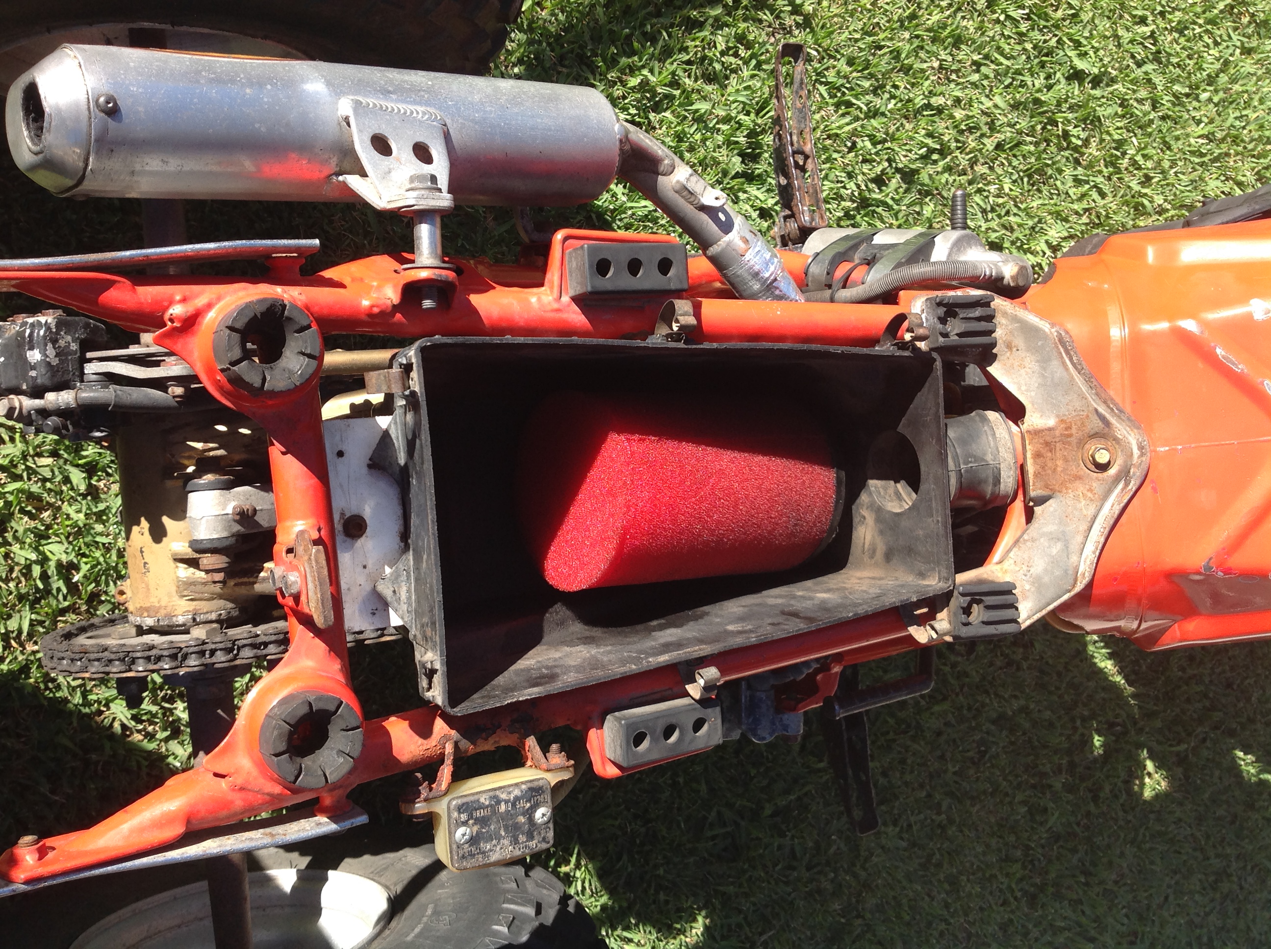

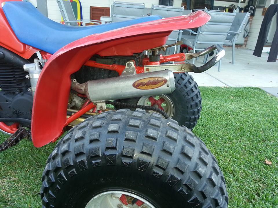

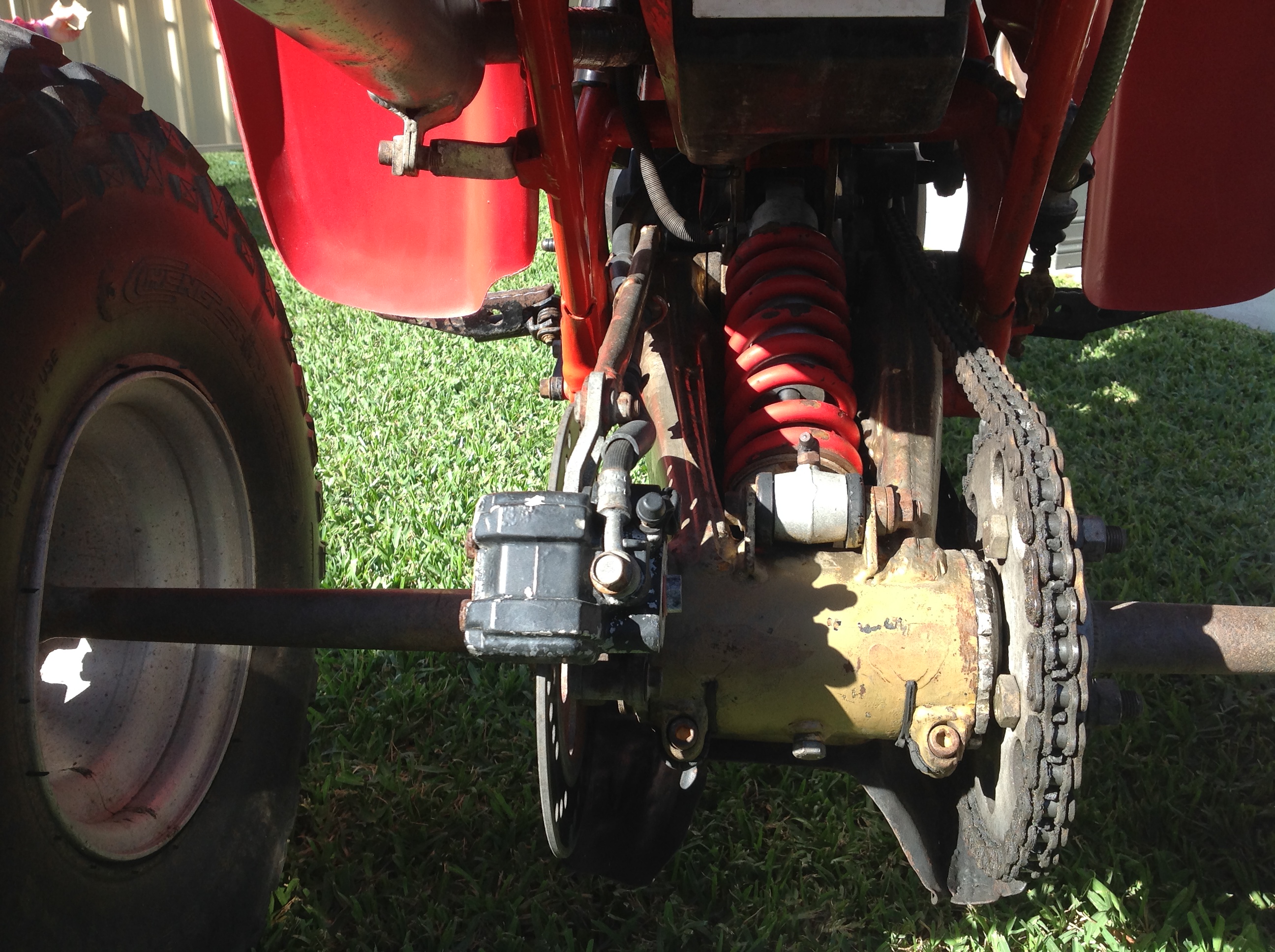

    Hi guys,
    I just bought this and wanted to restore it as much as possible.
    I know that it's missing a few things and the headlight and front fender aren't correct. I've noticed the rear fender is also a little odd, but, I couldn't find what model it came off as I know it's not OEM for an 84.
    Please post up what you see as being wrong. I need to know what I'm up for.

    The light appears to be off an '85 250R so I would surmise that the rear plastic is as well.
    Other than that, Matt is right .... and welcome...

    look around in Australia, theres a few guys on here with Air cooled 250r's that may have some parts for ya. honestly it already looks pretty complete, i would ride it for now and get to know the machine before you tear into it for a restore. You look to have most of the usable parts you need already in hand, the bike looks like it wasnt to mistreated aside from the spray bomb on the motor. check out http://s.com/ for more info on your machine. welcome!
    Carthage NY 250r rules
    2,355
    The rear looks like a 83 250r judgeing by the rear dogbone.The rear fender is 83-84 250r Maier.

    NEPA
    7,051
