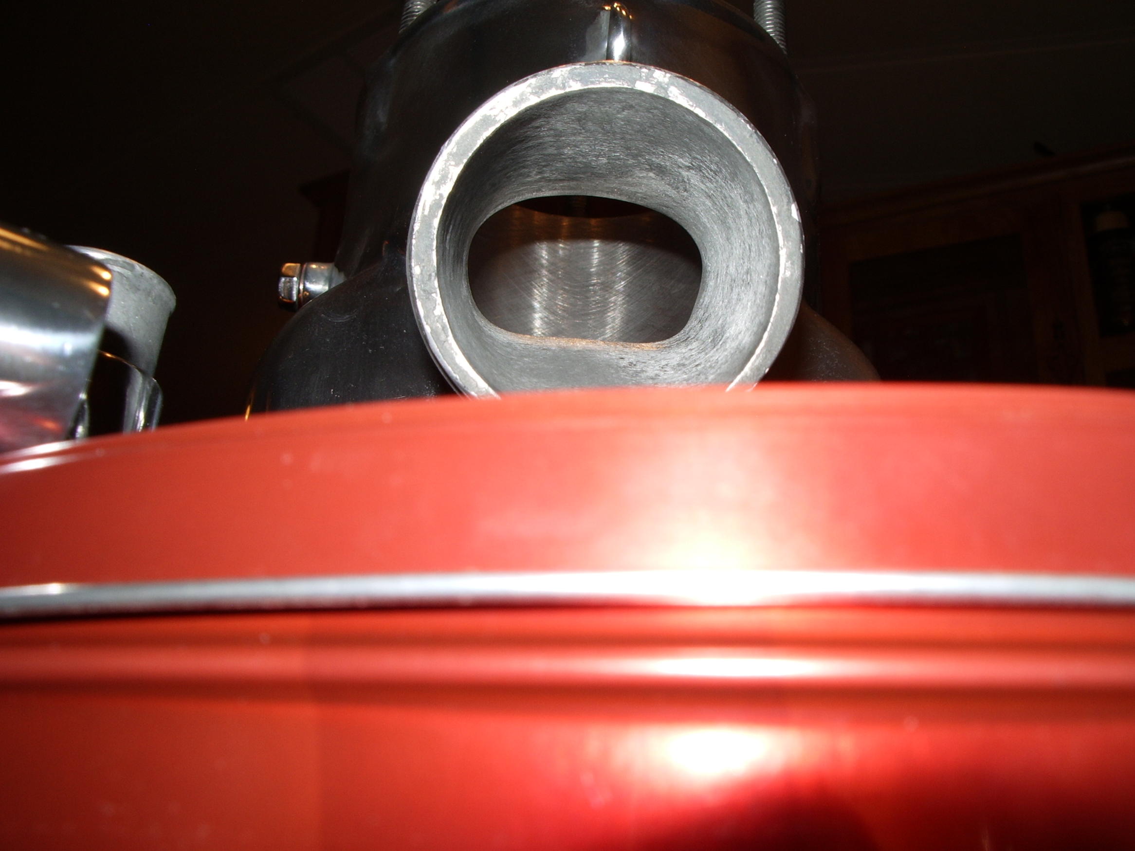

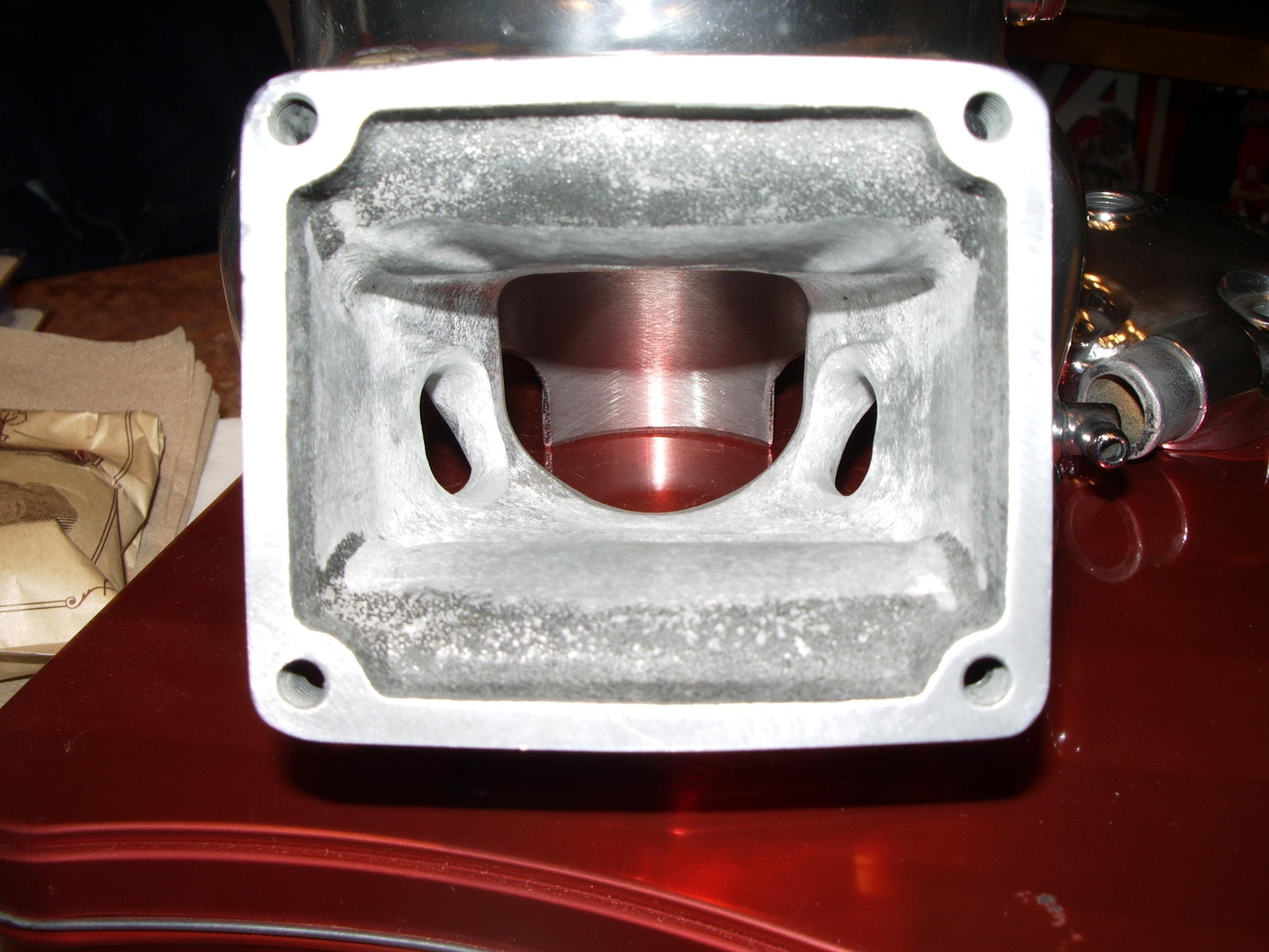

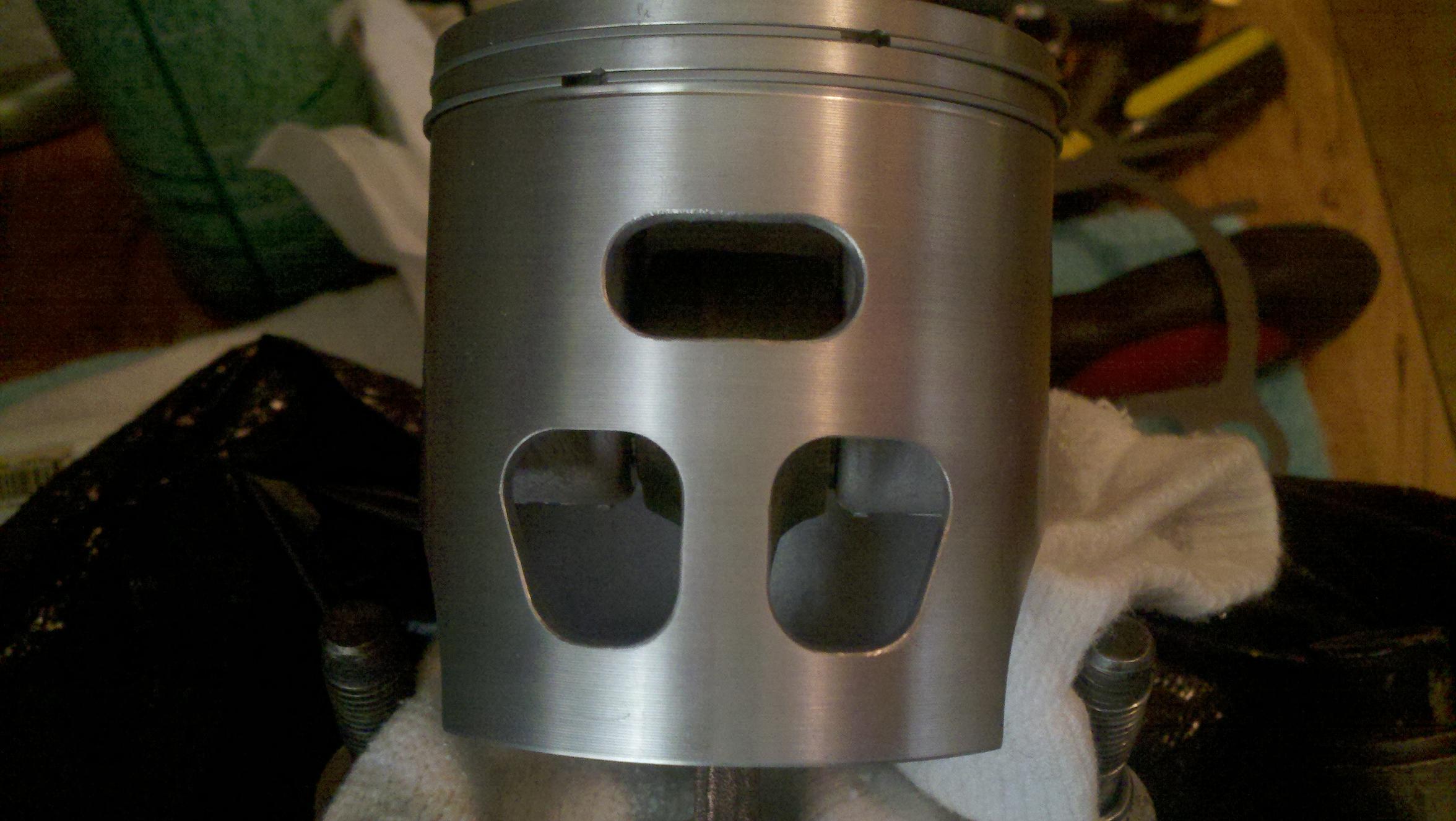

    yup Rise the exhaust port 2mm's,, extra boost port, window the piston, 38mm airstriker,,This is Halls work and it runs and runs waaayyy fast!
