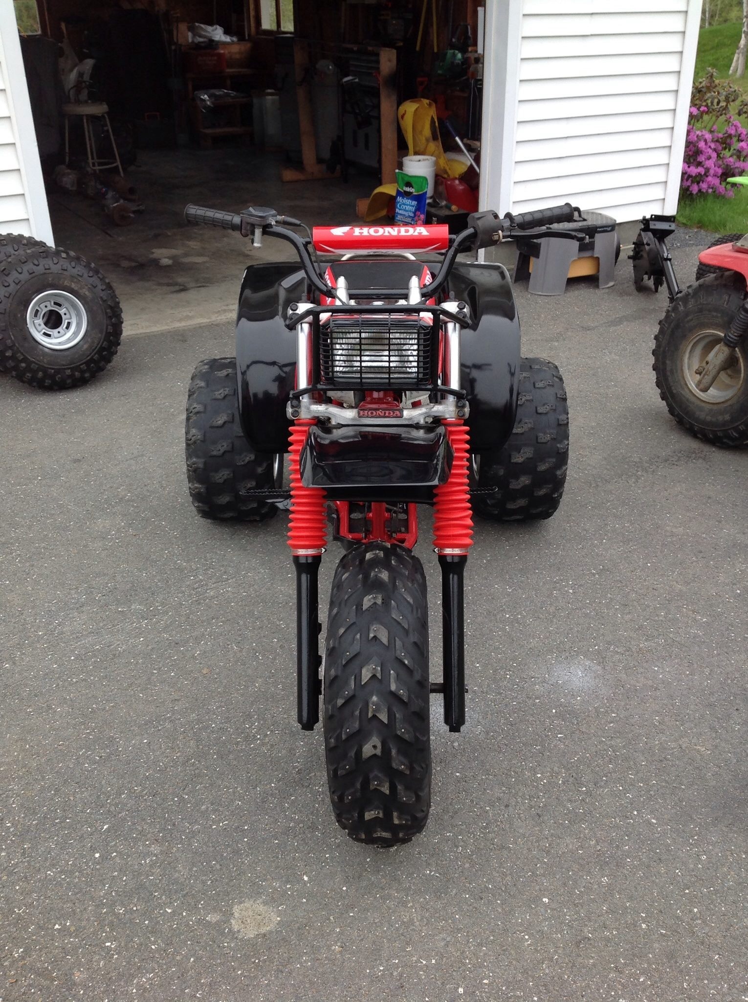

ID:	196093 this is my 83 with about 1400 into it, this one is in the process of having the tank fixed and the motor painted as well

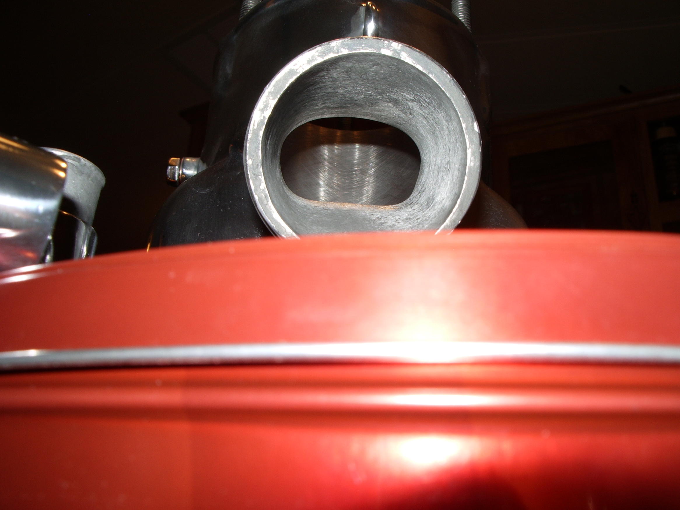

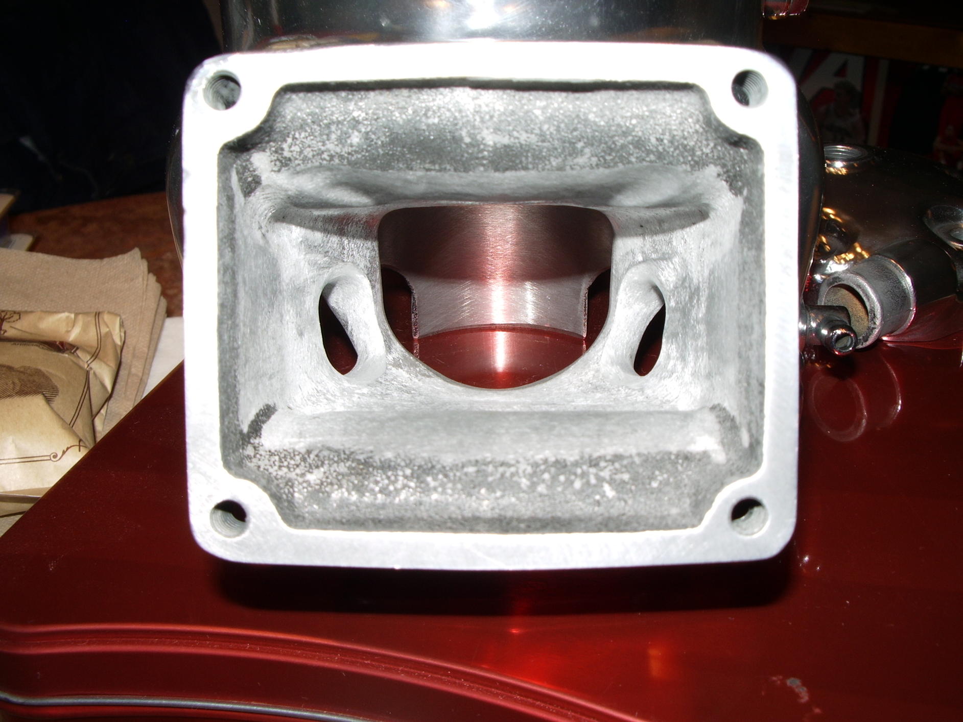

    Quote Originally Posted by badass350x View Post
    yup Rise the exhaust port 2mm's,, extra boost port, window the piston, 38mm airstriker,,This is Halls work and it runs and runs waaayyy fast!
    Attachment 196043Attachment 196044Attachment 196045
    When windowing the Piston, what measurements? How exactly do you know where to put the window? Yes I know, old thread but I'm not going to get a beat down for starting a new thread.
