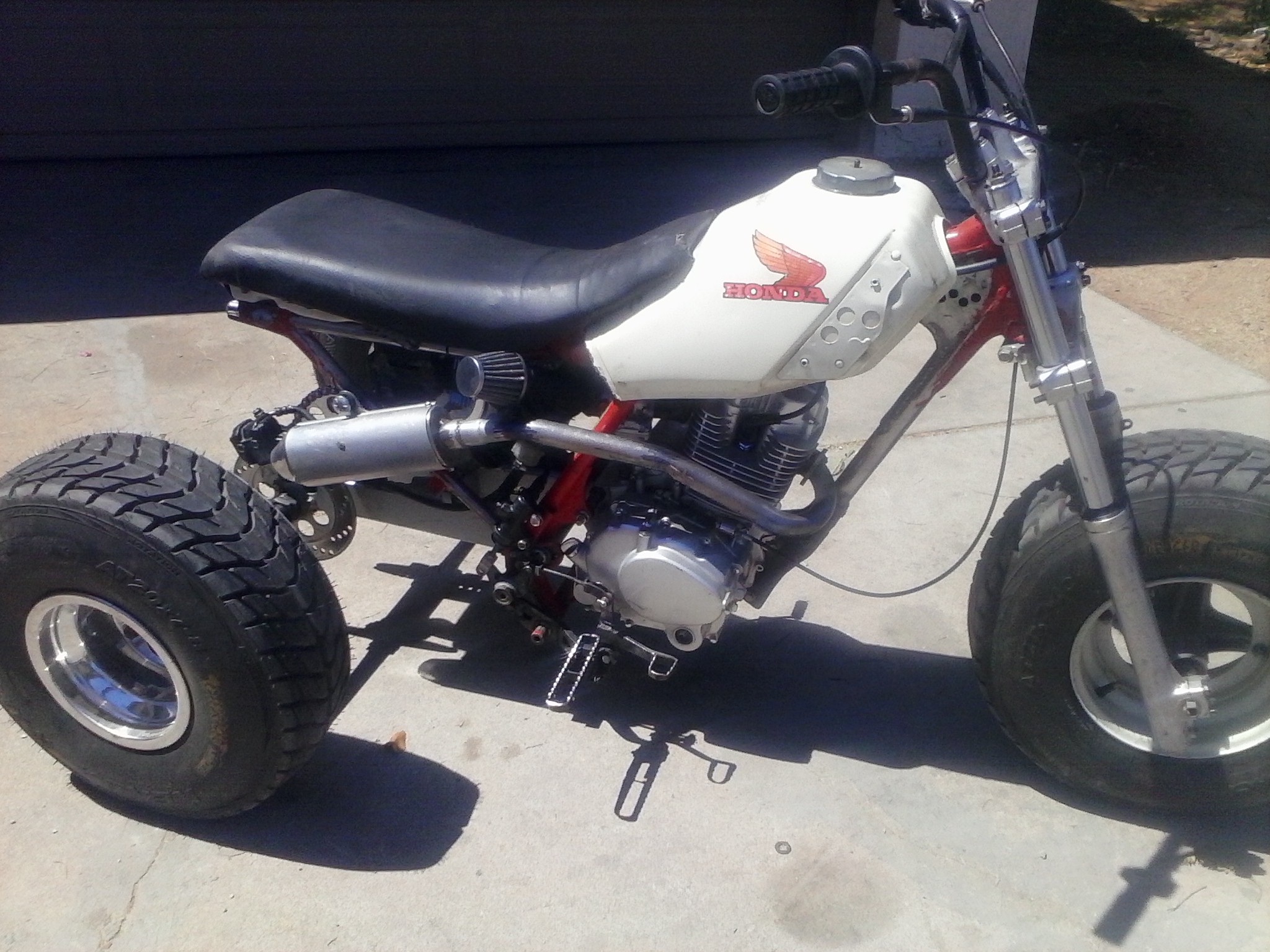

    I know a guy that's building something similar to what you describe.
    If you wanna be the king of anything around here, I would not shoot for the 'strange' crown. There are many ahead of you.
