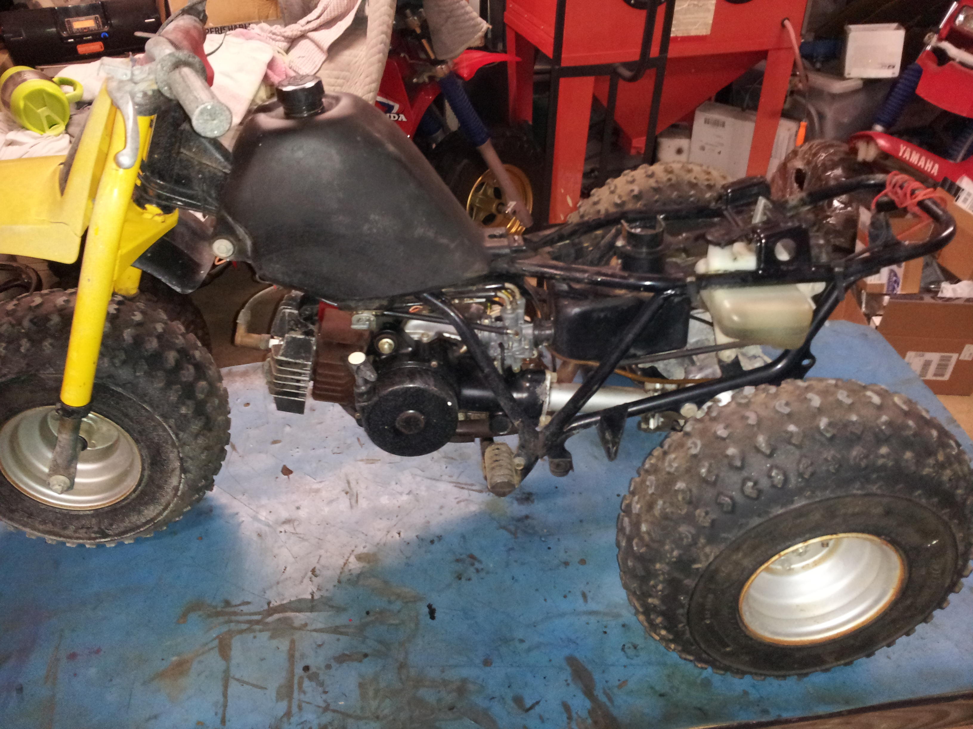

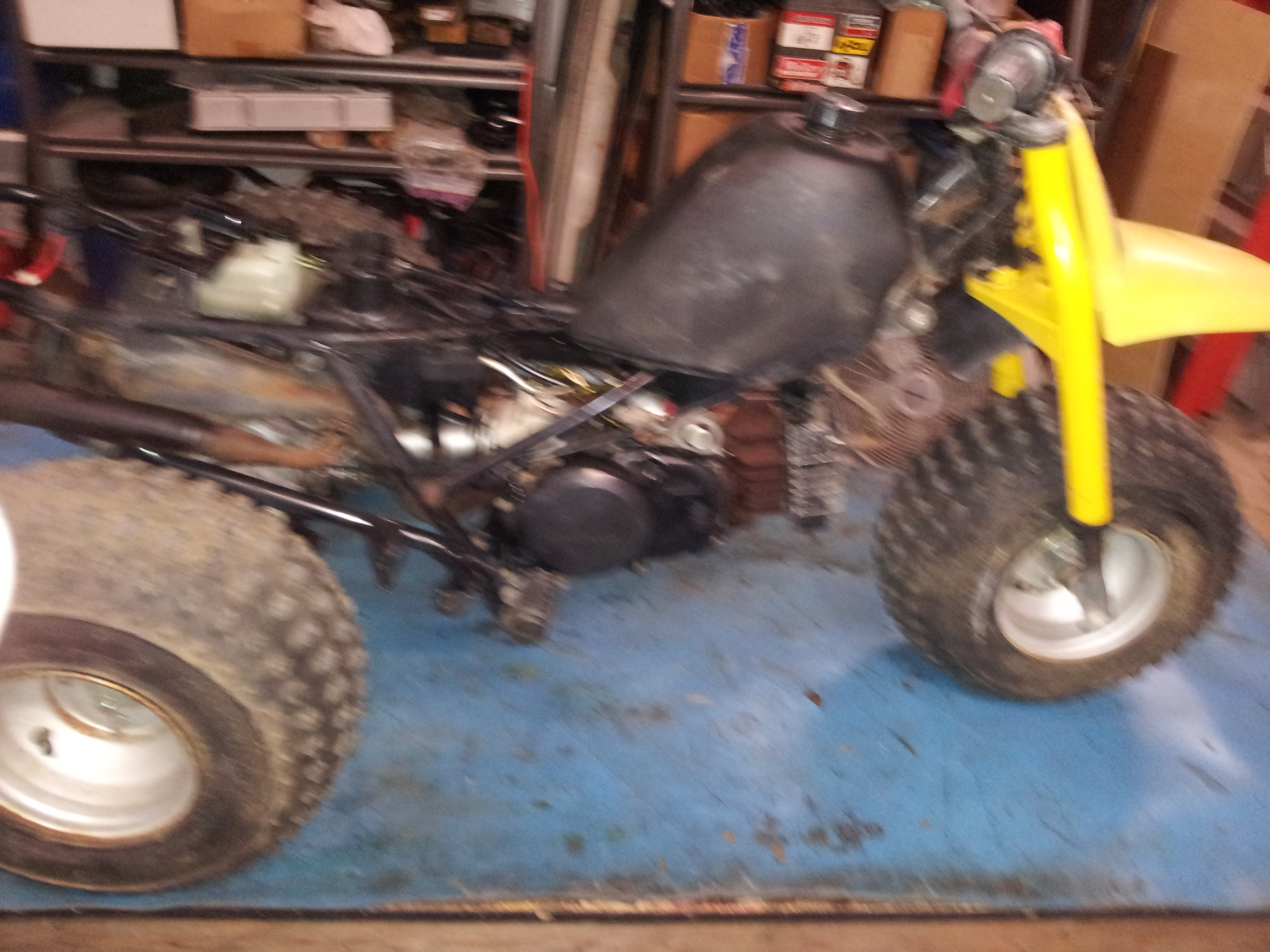

    These are the only pictures I have right now. Should be some in the camera - these are before:
    The stock exhaust is notorious for getting plugged up with carbon. If yours won't rev, that's a possibility.
    Also, the kill switch has 3 positions off-run-start. If yours is stock (the rev limiter can be bypassed).
    Off is obvious
    Run is almost obvious but can't start
    Start let's you start and has a rev limiter - below clutch engagement basically so jr. can't hurt him/her self
    If you can find a donor, you can have a 2-speed automatic Tri Zinger... google it
