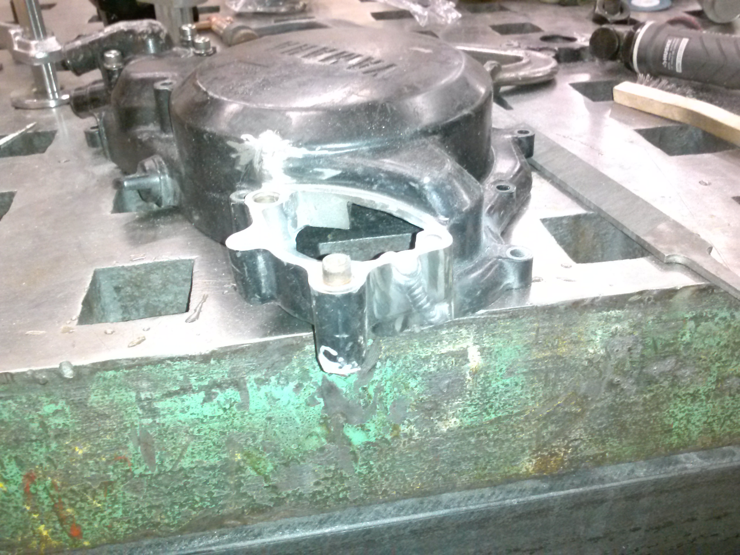

ID:	197186heres a crank seal area .i welded up,welding is the only real fix .

    Definitely right!! They make a cool jell stuff for welding works really well with aluminum...depending on location and heat worries that is probably the way to go, no splitting cases! Totally forgot, it is not something I use very often...worked really well with a repair I made on my forks after a fresh rebuild!! Here's a couple of picks of my repair on my kick start.. repaired really well and is holding up great!!
