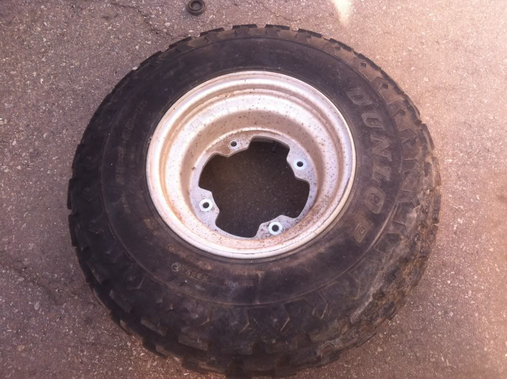

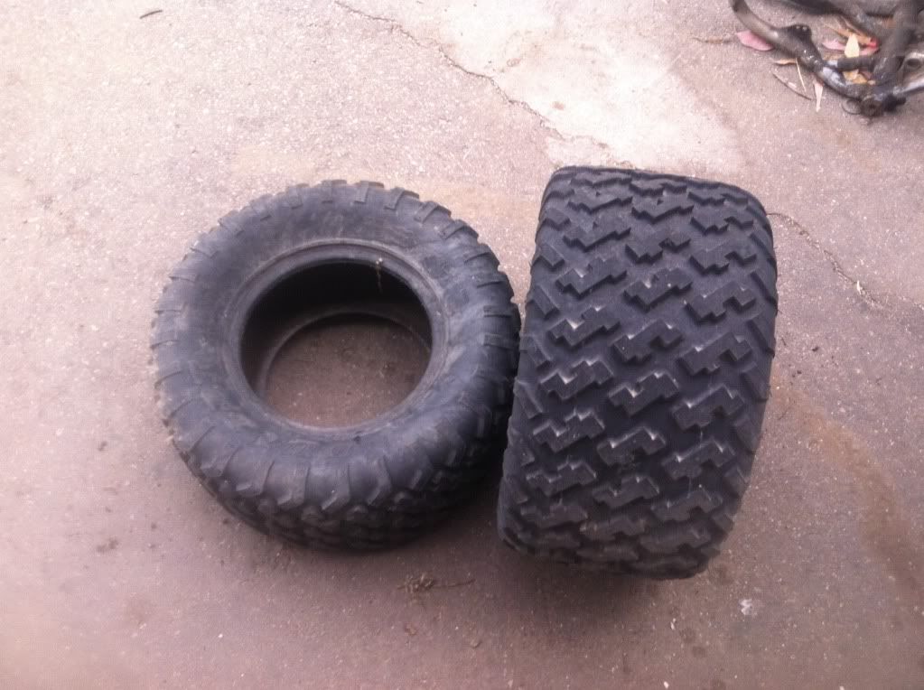

    are you talking about the wide tire version? it had 22x11-10 all around. some of the others are 23x9-11 front and 20x10-10 rears. you would need to use either a 23x8-11 or go up to a 24x9-11 for the front as no 23x9-11 tires are made anymore. and dunlop doesn't make trike tires anymore. you would need to go aftermarket. i suggest a 24x9-11 kenda scorpion for the front and any low profile 10" rear tire. i would use the holeshot if it was me.
