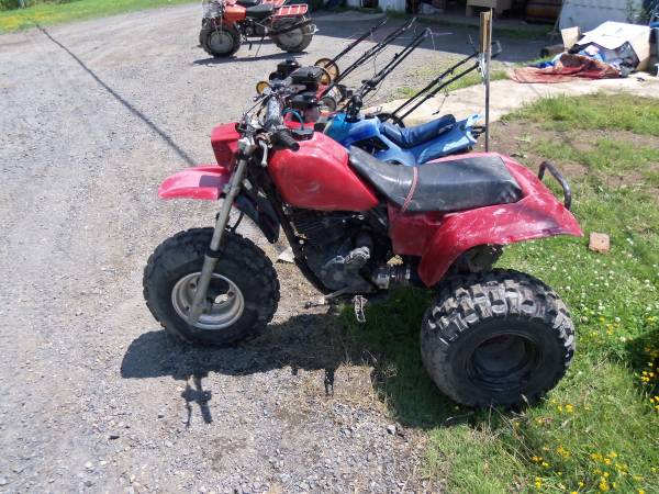

    Just picked it up and took her for a spin. She's not perfect but she loves life. The 350x front end is a little weird cause it sits up so high, I can pick up the front end in every gear real easy, and it keeps up with my neighbor's crf 230 no problem. I took a look at the identification tag thing on the front and it says 1/85 on it does that mean it's the first one made in 85 or something? Also there is some fluid leaking out of the top of the forks, anyone know what could be causing this?

    Quote Originally Posted by beastybaconman View Post
    ... Also there is some fluid leaking out of the top of the forks, anyone know what could be causing this?
    The bashed schrader valve on the fork cap.

    I thought it looked a little rough, I just wanted to make sure it wasnt something else, are those valves pretty easy to replace?
    Austin, Massachusetts
    1,591
    your forks look a bit bent. also, i'm no 350x expert, but i think its supposed to be a leading front axel. i think. not sure. i think your forks are backwards. your wheelbase is weird... any help from someone that knows??

    Thanks for mentioning that I looked at some pictures of 350x's and it looks like my forks are on backwards. Thats probably why it's so easy to wheelie

    Just turned the forks around rides a lot better, they are bent a little is there any easy way to straighten them up or am I better off just getting new ones?
    Bring them to a machine shop with a good press...a shop in my area straightens them for $30 a pair.

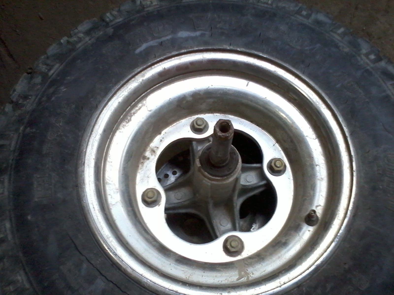

    I was just messing with my front wheel to get it centered more and I found that the axle bolt has different threads than the threads on the fork. Because of this, where it threads into the fork it's a little beat up. From what I can tell it is the front wheel from a 350x so I don't know why it isn't fitting, anyone know what could be going on? Maybe the previous owners used an axle bolt off a different rig or something?
