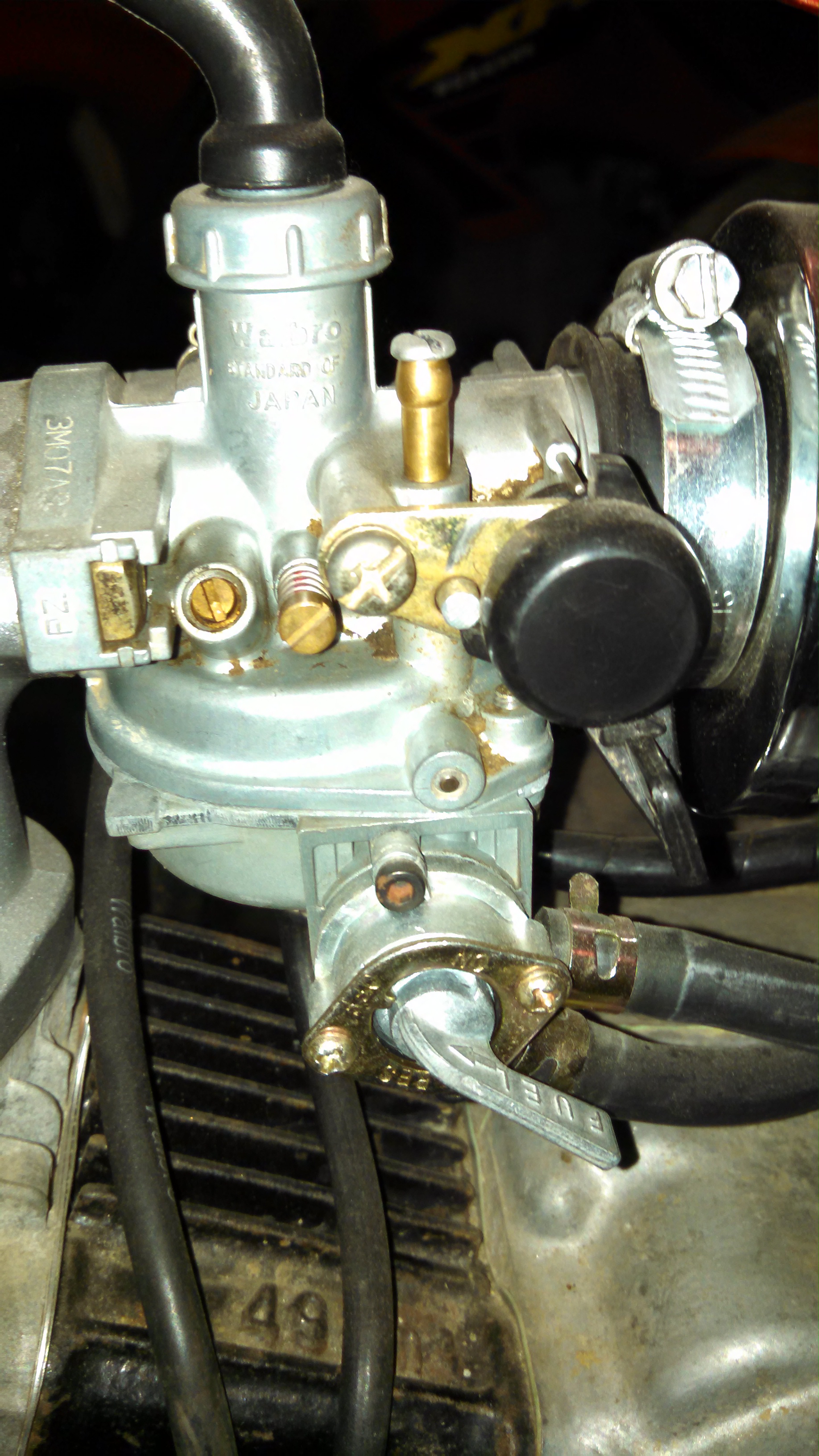

    I used a Chinese carb from an xr50 clone/big bore engine that had no petcock, by drilling the vertical hole up through the casting, plugging the top fuel fitting, and using the Honda atc70 bowl and petcock. Worked like a charm! I'll take a picture and post it up.
ID:	198071 This in on my CT70. I did have to go up one jet size on the main, and one clip position lower on the needle since the carb was originally intended for a 110cc, and its on an XR50 engine.
