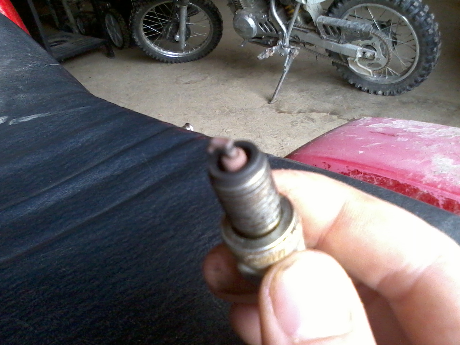

    I don't have a compression checker, but I just went out and kicked it over with my finger on the spark plug hole and it seems like it has all sorts of compression. The spark plug does look like it has been running a little lean, so I think I'll richen the mixture with the air screw a little and go easy on it, until I can get the right jets. And I'm pretty sure there isn't anything blocking the fuel flow, I just had the carb apart the other day and cleaned it out pretty good. Which way do I turn the air screw to richen the mixture?

    Quote Originally Posted by beastybaconman View Post
    Ok, I don't have the stock exhaust, any idea what the jets should be for the cobra?
    There is no magic number for any given exhaust. Every motor breathes differently. Fatten it up 2 or 3 sizes and do a plug chop. The plug will tell you how its burning. Since its popping on deceleration, then fatten up the slow speed jet until the popping stops.

    Ok thanks I'll try changing them. When I took the plug out to check compression it definatly looked like it was burning a little hot.

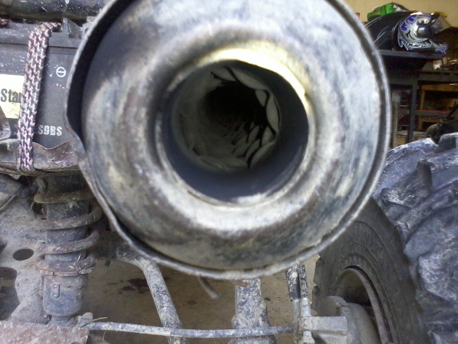

    I just took a look and the main is a 130 and the slow jet is a 38. How many sizes do you think I should go up? It's probably pretty lean right now because there isn't much for baffles inside the muffler.

    Jan 2011
    Choctaw, OK
    2,755
    Try starting at 134 and 42 and see what that gives you. Its a bit of trial and error.
