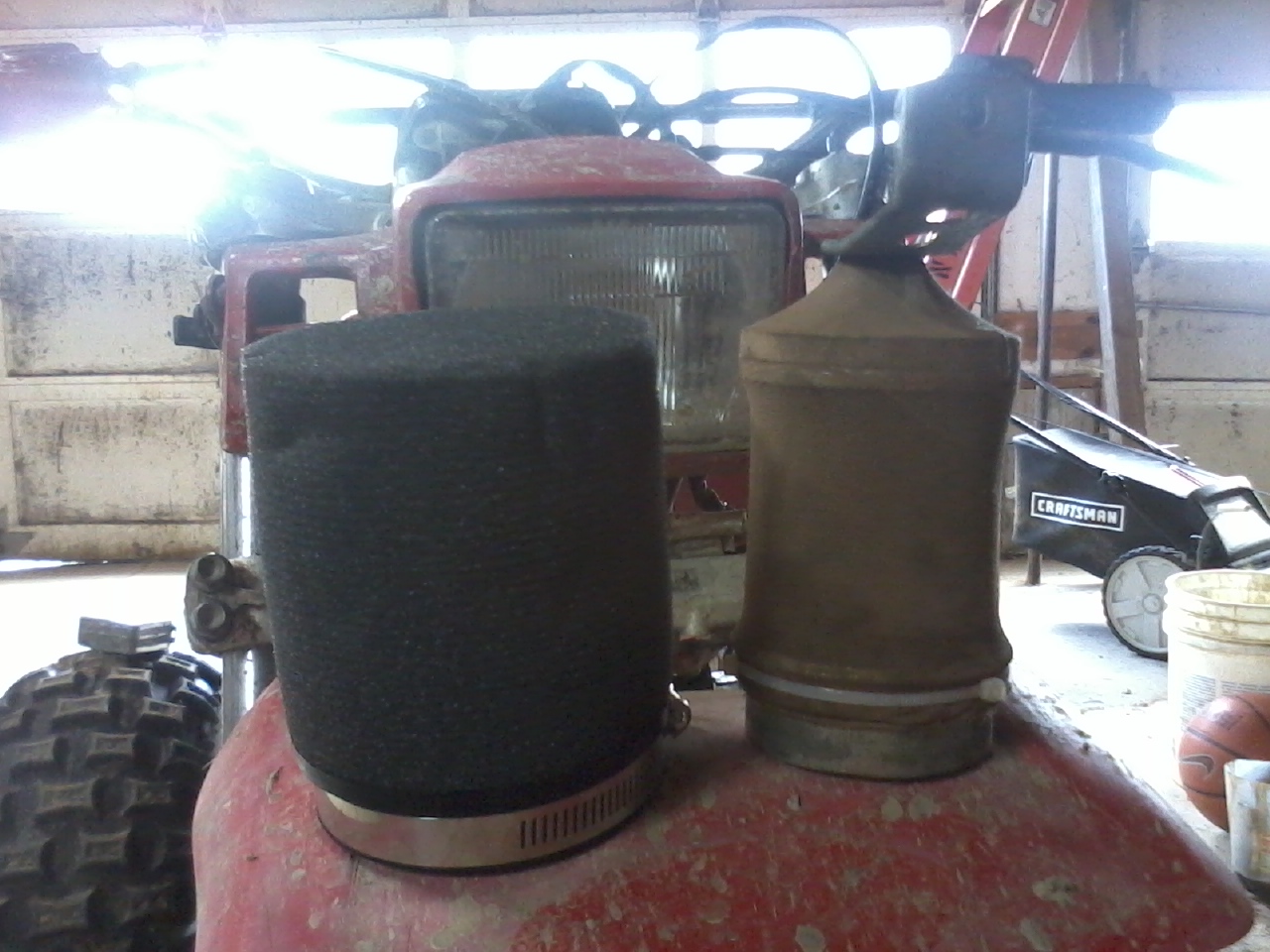

    Got a filter for it, will be getting muffler packing this week. I took it for a spin and pulled the plug, it's brown on top and there's black soot looking stuff around the edge so I think it's running a little rich. I might lean it out a little, but I'd rather have it run too rich instead of too lean.
