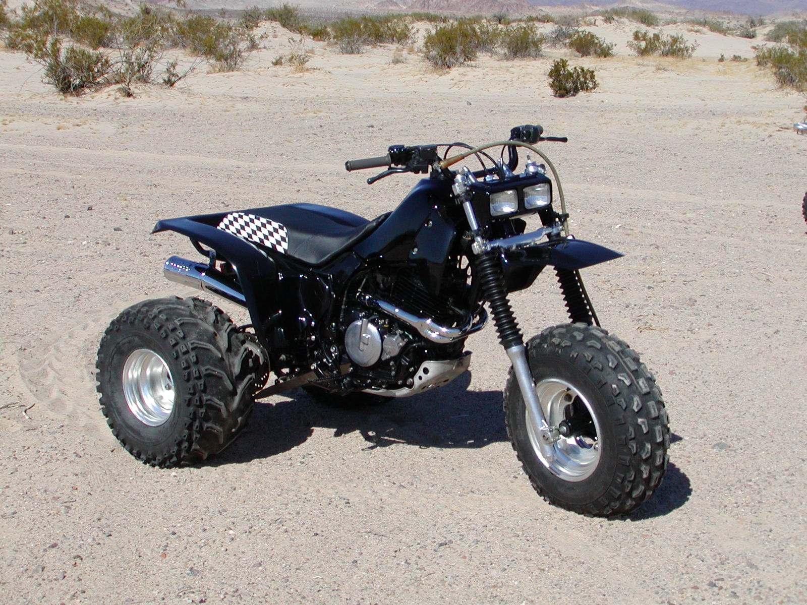

    Here's what it will look like in black

    Dang! that is a slick lookin machine BOB MARLIN! i was thinking about a pearl white for the frame....thoughts??

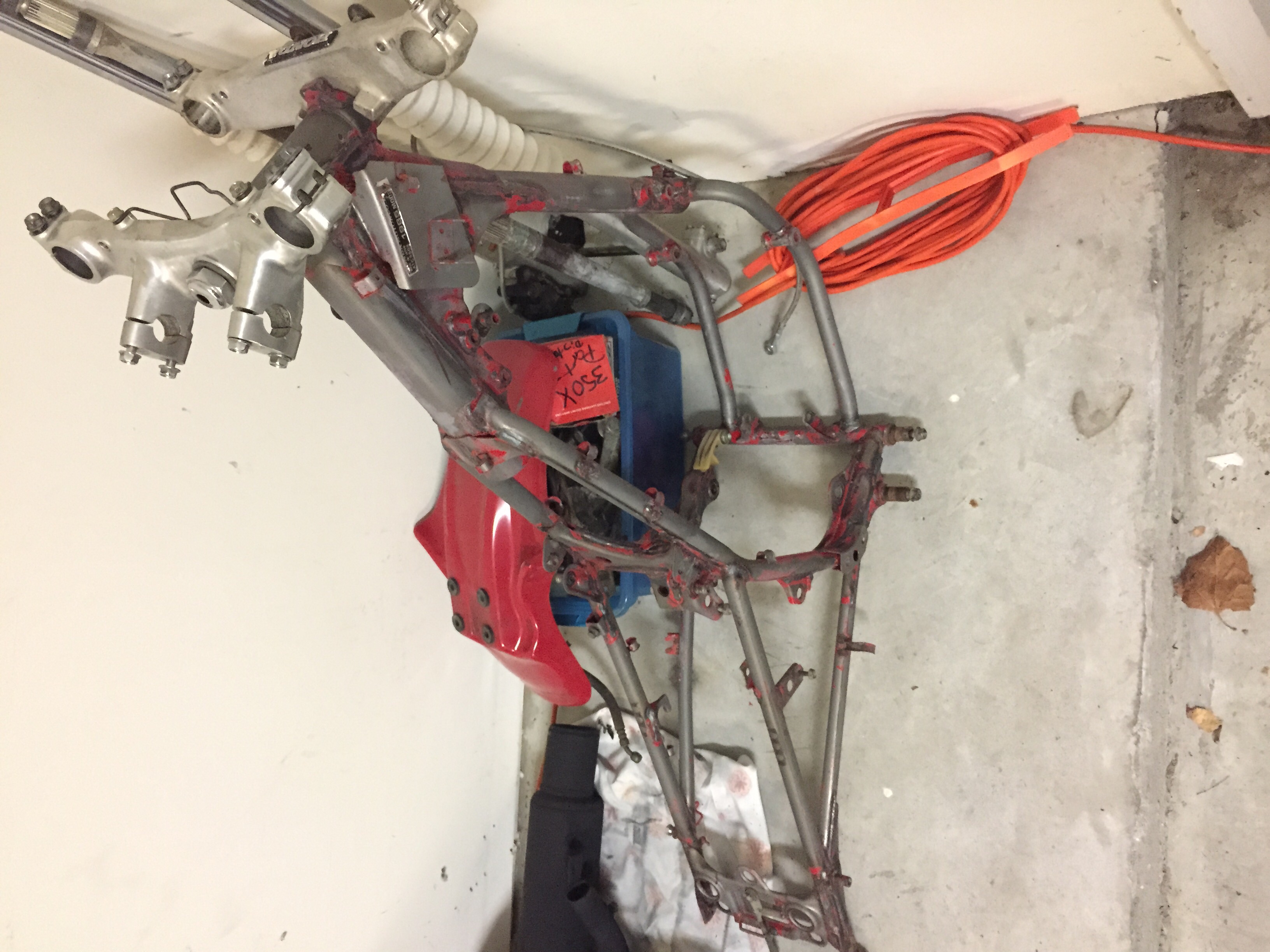

    Finally back from deployment and getting some work done on the bike before I head back to ill. Engine and swinger pulled and most of the paint is stripped now. More pics to follow. Now if I could get my gusset kit that I already paid for..Click image for larger version.

    Wonderboy I paid for them in the beginning of October, that when he told me they were ready to be shipped. The last corrospondence I have says he sent then and I should have received them by now. I'm not saying it's his fault maybe a shipping error. Anyhow that's my next step so I'm at a standstillClick image for larger version.

    When you do get the gusset kit make sure that the gusset that goes one the right side , above the foot peg, has the clearance (hole or slot) for the brake line. Mine did not, and it sucks to find out after you just spent $200 on powder coat.
