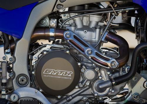

    I find it real interesting that the dealer where I bought my 450 from has no idea what an Air Induction System is.
    But in this picture I found on yahoo.............
    2014 Yamaha YFZ450R Engine GYTR
    Thanks a lot Yamaha. LOL

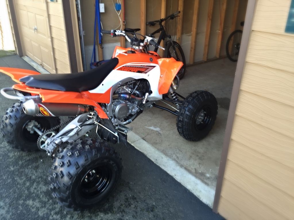

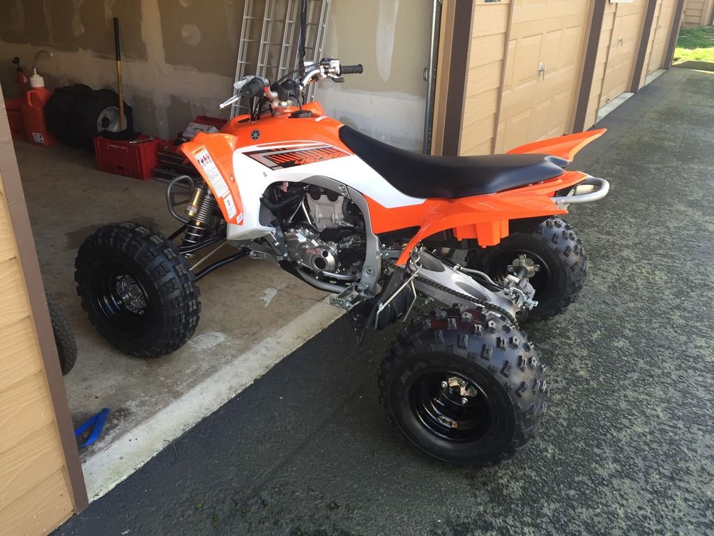

    I just installed a $700 Vortex racing ECU and it fixed everything.
    Just got my new powder coated black rims today

    Quote Originally Posted by Fox250R View Post
    jeebus, I thought I had a big garage....is that yours or a storage facility? I can see four single stalls.......
  15. #60
    Jun 2004
    Oregon
    1,783
    LOL, yah I have this one and the one to the right. Its just our garages where we live.
    Fits my R the YFZ and a few other things with no prob
    But would love something bigger lol
