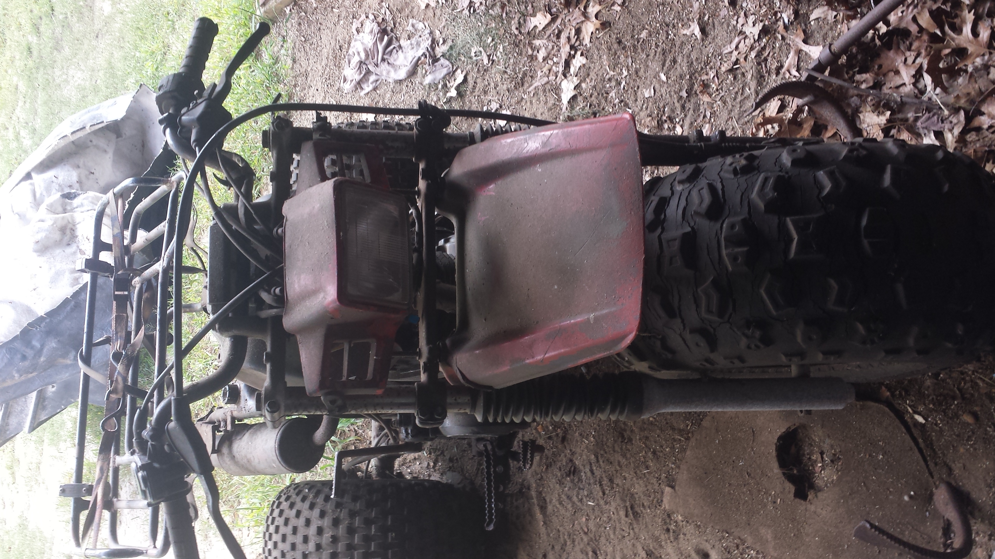

ID:	198838Click image for larger version.
ID:	198837Click image for larger version.
    I got it running today with starter spray. Won't idle, I will clean the carb out soon. Thanks guys
