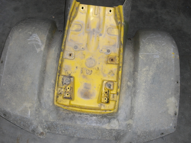

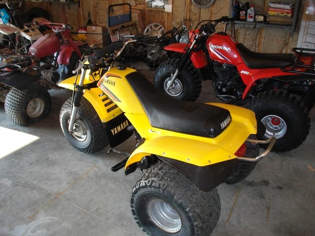

    This is what I did for real sun baked dirt build up and oxidation. I used about 3 tubes of Pepsodent Toothepaste. A couple bags of really fine 0000 steel wool. You have to experiment on the back side of the plastic if you have real bad build up or oxidation if they are bad like mine was. Before I used the really fine steel wool I had to use a little couser one first to get the real nasty stuff off. After you can put wax on and buff if you get some slight swirl marks. I barely got any swirl marks so I hit it with a couple coats of armor all and it drank it up and shined good. You can also follow up after the 0000 wool with the finest wet sanding paper and wet sand also. I did this on one fender. Its not easy and takes several resands to get down to the original plastic. In all it took me a whole week, a bunch of popped blisters but was definately worth the effort!! Use gloves the steel wool is a hand killer..
    Here is my finished front fender next to the headlight as to what it looked like before..

    The nasty rear fender which took 3 different scrub downs..

    The finished YTM 200.

    Never give up its pain staking but worth it...Not sure if it will work for just clean fenders that are sunbleached..

    wow that rear fender was NASTY!!

    excellent job, she looks great now!
