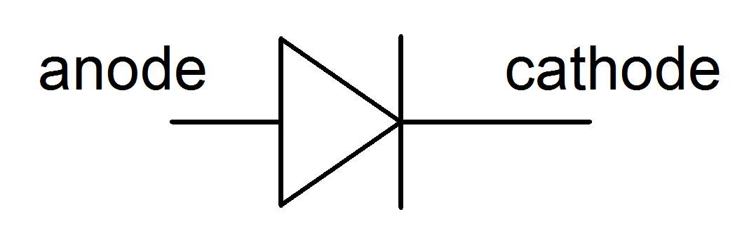

    On the pigtail for the neutral and reverse lights there is a diode. A diode allows current to flow in one direction only. Sort of like a check valve. If you look at the diagram, the diode is connected to the Light Green/Red wire coming from the neutral switch which provides ground to the neutral light, starter solenoid, and CDI. The diode prevents current from back feeding back through the system. Now, with normal operation, the ground would travel up to the light turning it on, it enables the starter solenoid, and also tells the CDI the transmission is in neutral.
    Let's assume the diode is bad, this would prevent the ground from getting to the light. It would also depending If the diode was open or shorted not tell the CDI it is safe to start cutting off the signal to allow the CDI to fire the ignition coil to start. Since the light does not illuminate, I will assume the diode is open just the same as cutting the wire. There is nothing else in the system that would account for the light not illuminating and no fire from the CDI. Disconnect the wires back on the tail and the motor will turn and not fire with estart.
    To get to the diode, you have to remove the pigtail the lights plug in to and unwrap the harness for the neutral light. A few inches from the light socket, you will find a tiny black carbon cylinder. Most meters have a diode function. If you put the meter on that setting, you can put the leads on either side of the diode and you will have continuity. Flip the leads and no continuity. This will be the indication for a good diode. If you have continuity in both directions or no indication on the meter in either direction the diode is bad. If you have or can borrow another pigtail then you can verify the pigtail on yours is bad otherwise you can check it with a meter.
    You will see attached a wiring diagram with an arrow pointing toward the diode and the symbol for the diode.

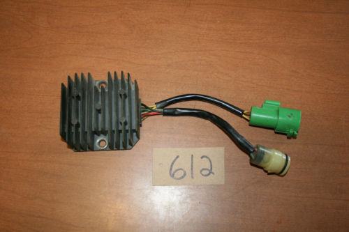

    This is an ES/SX Regulator/Rectifier. Its mounted on the left side of the tail
